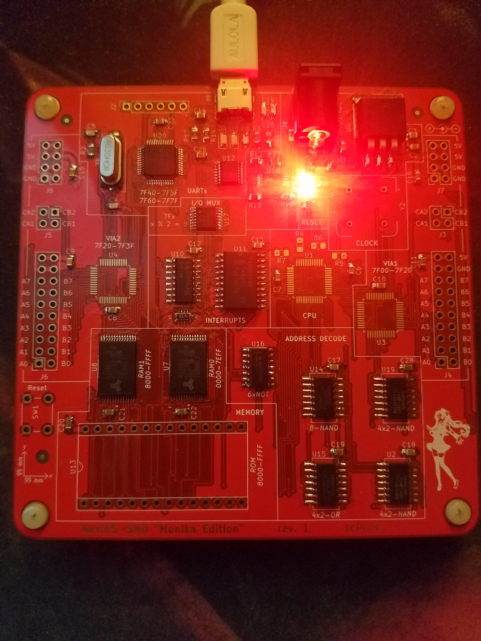

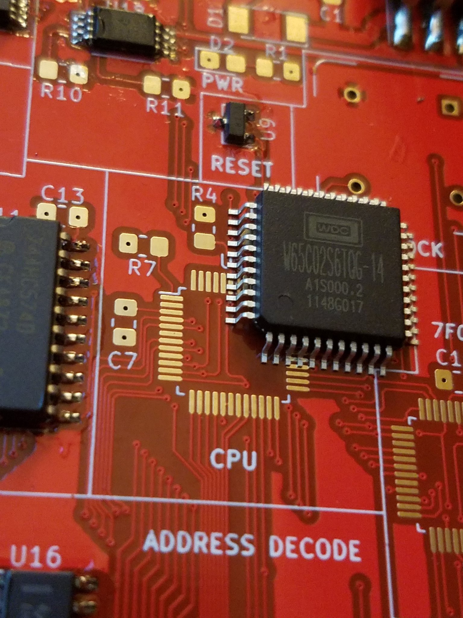

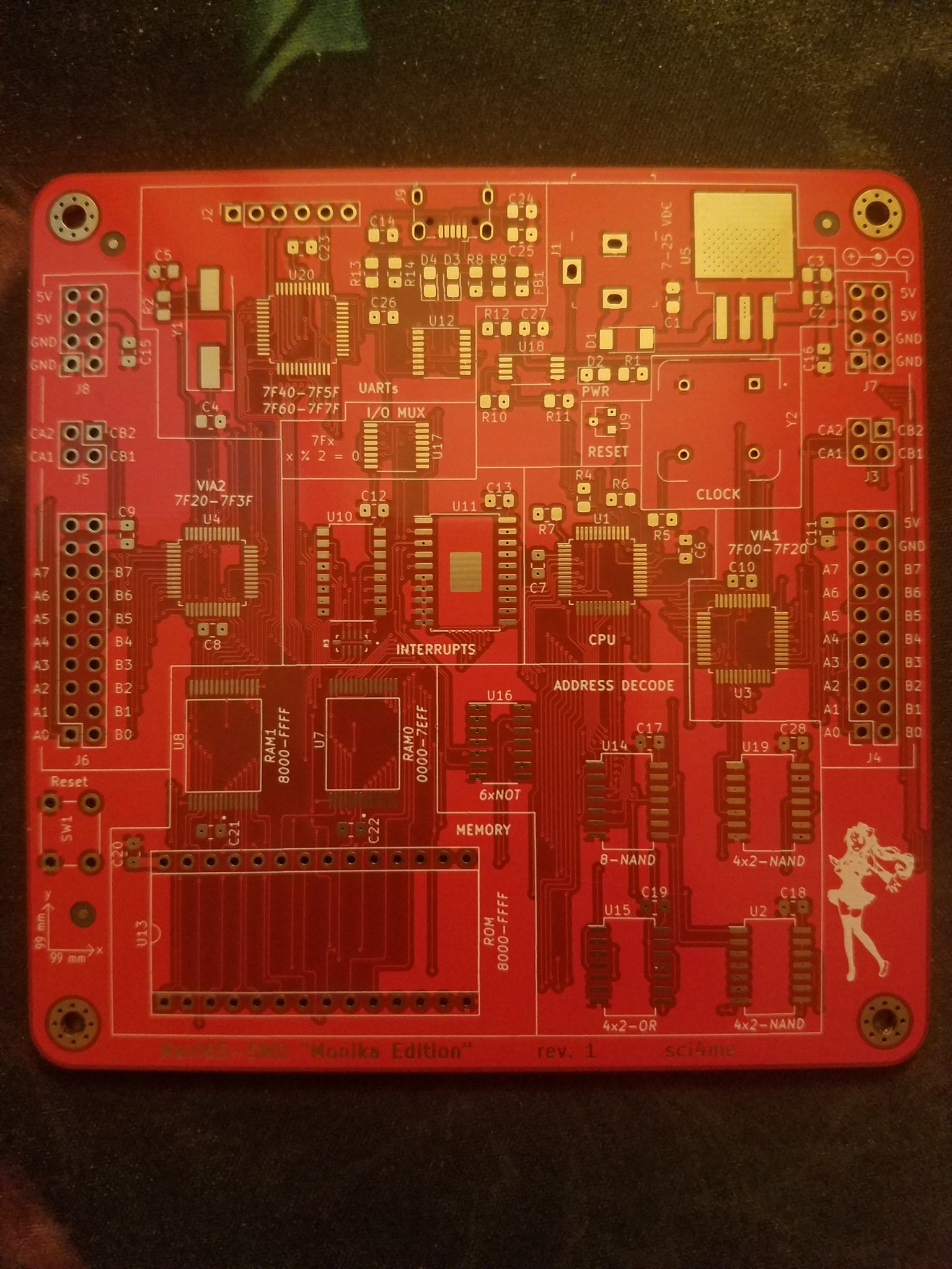

So I randomly decided that I wanted to try my hand at SMD/SMT electronics for the first time ever. I had a design for a simple 65(c)02 SBC, nothing particularly unique there, and I knew the WDC parts came in QFP and PLCC packages, so I just went ahead and converted the design to use the SMT parts, along with a few minor changes/additions. For my first SMT board layout I think it turned out alright, although I definitely learned a lot along the way. Finally today (yesterday now) the boards arrived and I was quite thrilled with how they turned out, other than a minor silkscreen mistake.
But then it all came crashing down. I tried so hard and got so far, but in the end it didn't even matter. I made a rather awful mistake: I used a completely incorrect footprint for the 65C02 and 65C22s! Doh!
Thankfully though, I ended up with some unique looking coasters along with confirmation that some of the additions I made, to do with the USB interface, seem to work. Not worth the ninety bucks or so, but hey, what can I say, I'm a computer programmer, not an engineer :lol:
File comment: USB tho :P
Was the mistake the scantly-clad lady on the front? LOL
I actually like the layout of the board. Oh, I'm also not a hardware engineer but a software engineer. So yeah...happened to me too. My first SBC is a small green coaster now. But hey...at least it has my name on it for future generations to mock...er...study. lol

I haven't made that mistake...yet. However, I've made other that were as egregious. You could hang the bad PCBs on the wall and call them modern art. Or perhaps take them out back along with your gun and do some plinking. :D
BTW, I recommend you lose the filled planes (aka ground pours). All those are doing for you is adding unwanted parasitic capacitance.

I was saved from a similar fate by a comment I read somewhere about using a scale-accurate printout of the PCB to check all the footprints prior to sending the Gerbers off. It's also helpful in making sure the housings of connectors and other gadgets don't step on each other, which is unfortunately is something I learned only after being bitten by it. (In the pic below, the bottom left pin header is too close to the IC socket for a ribbon cable connector to fit comfortably. This printout came from Eagle CAD but I suspect most other tools would have a similar function).

Other than carefully checking before going ahead to manufacture
Yep, no doubt I'll be doing this a bit more thoroughly from now on.
Interestingly, I found that the WDC datasheets, as far as I can tell, do not specify a single thing about the physical device packages, such as dimensions; they only specify 'DIP', 'QFP', and 'PLCC' -- unless I'm just missing something. I actually had to find the dimensions on a StackExchange post. Not to blame WDC in any way, but it is odd; I've never seen any other datasheets like that that I can think of.
:lol: The labeling on the left side GPIO connector is missing power and ground as it is on the right side.
This is something I've been wondering about but haven't done enough research on. I was under the impression that it wouldn't be any different, essentially, than the actual ground plane...
I have signals on top and bottom and just below top I have power and ground below that.
In all honesty the aesthetic is not an insignificant part of why I did add those ground fills on top and bottom, which seemed reasonable given my assumption that it would have little effect on the function of the board. Definitely an area I'd like more solid info about, just haven't dug into that yet.
I was able to recover from that using a combination of the trusty X-Acto knife and some funny wiring.
I briefly considered trying to find some hacky way to get the chips connected but really, I figure I'd be less frustrated by just re-spinning the board :lol:
We have an
extensive topic on designing for high speed performance. Among other things, the value of four-layer construction and the negatives of having filled planes are discussed. My POC V1.2 unit (most recent in the series) is running at 20 MHz on a four-layer board. There are no filled planes other than in areas where I am trying to suppress stray radiation (the Ø2 oscillator runs at 40 MHz).

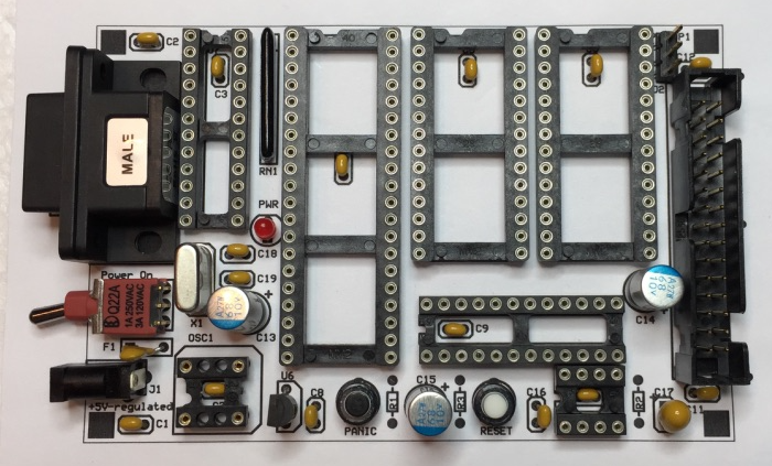

I started doing PCB 1:1 scale prints years ago... but carry it one step further. I mount the printed PCB paper on a piece of styrofoam and then poke holes for all of the components and place them to ensure everything fits... albeit SMT bits of course.
However, I once made a PCB and used the wrong gender for a DB-9 connector! Paper sizing fits fine, but it took some head-scratching to figure our why the serial port didn't work at work at first!

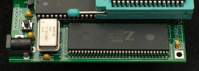

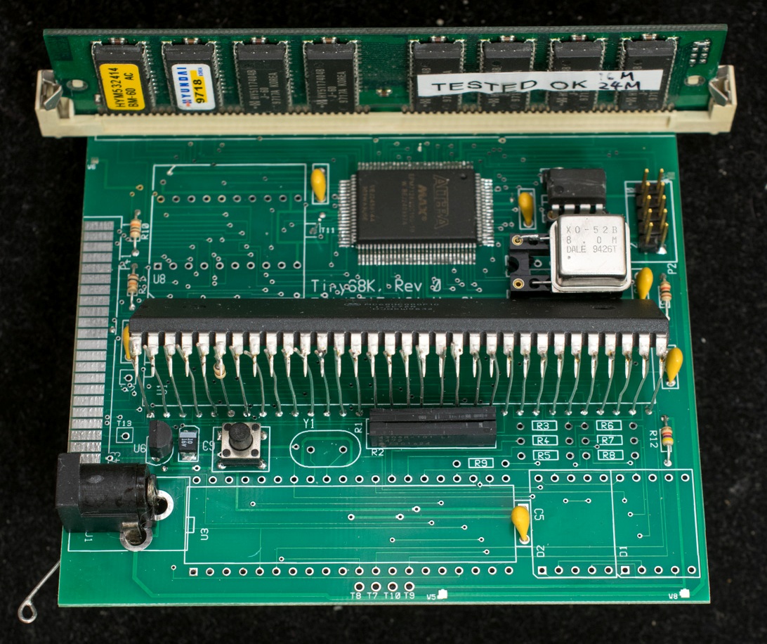

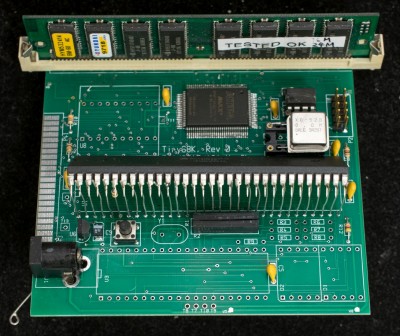

Doing hardware for 35 years so I have made plenty of layout mistakes. In fact, even after retirement I still made some spectacular mistakes. Here are a couple in the last 3 years to entertain you:
pic 1: 68000 DIP is 900 mil wide, NOT 600mil
pic 2: shrink DIP64 pitch is 70 mil, not 75mil
If you use a big enough hammer the parts might fit. :D
