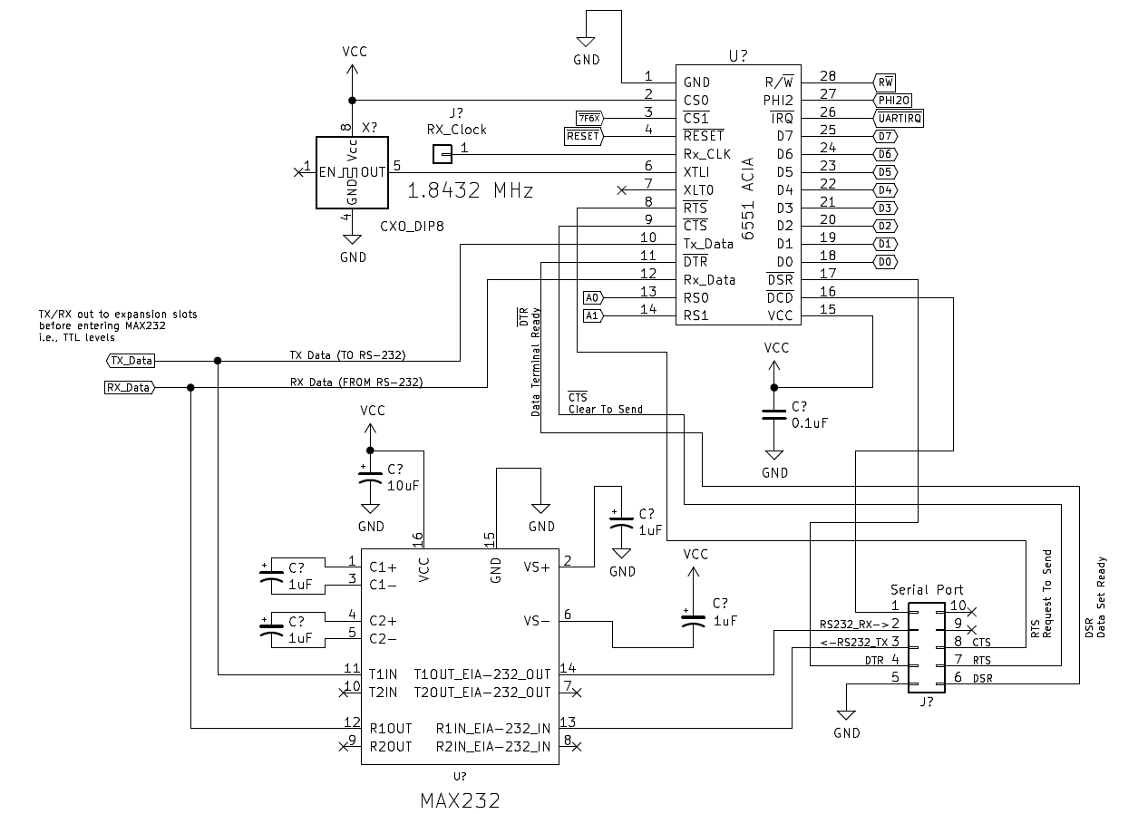

I *THINK* I've finished my design in regards to my serial port. I plan on using a 65C51 (and work around the bug) or use an old-school Rockwell version (which I have found works in my other design).
I also want a real serial port that could communicate with my other legacy computers like my Apple II or C64. So I'm hoping I have implemented all of this correctly. Especially the hardware handshaking/etc.
I'm certainly interested in the opinions and advice of you guys.

Why are TX and RX going through the line driver and receiver but the control lines going to the same connector are not?

Hmm. Good question.
I thought the control lines went directly to the 6551.
So the DTR/DSR and RTS/CTS also get translated?

Yes, everything. It might be good to go through my RS-232 primer.

Ah, obvious fubar on my part. For some reason, I was thinking those are just plain TTL levels. I'll rework that and try again. :-)
PostPosted: Thu Feb 18, 2021 9:40 pm
Posts: 8510
The popular MAX232 has two line drivers and two line receivers, commonly used for TX, RX, RTS, and CTS. If you also want DSR and DTR, you'll need an extra line driver and receiver pair. If you already have ±12V (or even ±9V—it's not critical) on the board for other things anyway, you can save board space by using something like the 16-pin MC145406 triple line driver and receiver which does not need any charge-pump capacitors.

Ah! OK. That makes more sense. Most examples I have seen really don't utilize DSR/DTR and sometimes not even RTS/CTS.
I couldn't figure out how to get all of those pins into the MAX232 which is one reason why I thought those were TTL.
I've learned more about RS-232 today than I have in the last 10 years. LOL
To be honest, I only went with the MAX232 because I have some. I will investigate the MC145406 chip as a replacement.
Thanks again.

Yes. If you use a MAX238 you will be able to accommodate the control lines in a single device. If you refer to my white paper on interfacing the 28L91 I show a suitable DTE-to-DCE hookup on page 17.
That requirement may be implemented with a MAX238.

Use of CTS/RTS handshaking is de rigueur above 9600bps in most cases in which handshaking is required. XON/XOFF handshaking becomes unreliable above that speed.
I recommend the MAX238. The MAX238 uses the same charge pump caps as the MAX232. My POC V1.2 unit has two MAX238s to handle the four serial channels.

Forgot to mention that it would be great to only have a 5V supply but I could possibly put in a 9/12V and step down to 5V. But it seems the MAX238 doesn't need 9/12V!
So that seems to be a perfect match. I'm a little puzzled on why there are more drivers than receivers on the chip.

When the MAX232 was originally released in the mid-1980s it was considered revolutionary in the TIA-232 world because it didn't require multiple voltage sources like the then-ubiquitous 1488 and 1489 devices.
Huh? The MAX238 has four TIA-232 outputs and four TIA-232 inputs.
