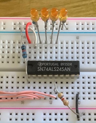

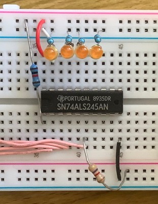

I too use a logic probe extensively.
But I also often use 3mm LEDs with suitable resistors soldered to them. The older type of LEDs that have a forward voltage of between 1.8V and 2.2V normally survive reverse polarity on a 5V rail if the current is limited by a resistor.
File comment: 3mm LED with current limiting resistor soldered to one leg

File comment: Top view of LEDs after a 74ALS245 being used as a buffer
File comment: Front view of LEDs after a 74ALS245 being used as a buffer
