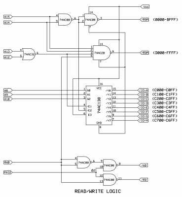

So I'm working on a design that I would like to somewhat mimic the memory mapping of an Apple II.
The requirement is to only use TTL parts and no PLD's.
Basically:
RAM: 0000 - BFFF
IO:    C000 - CFFF
ROM: D000 - FFFF
That's not technically accurate because I need the interrupt vectors starting at $FFFA.
So I've been scratching my brain on coming up with logic that would allow the very top to be RAM as well. Then it occurred to me that's not really smart.
Instead, why not just "hard code" a RAM address, say $B000 (or any RAM) into the actual ROM. For example, the RESET Vector would have $00B0 at $FFFC in ROM. Then I could change the actual reset location at position $B000. Basically a jump table. Do it for the other locations too. I think the one drawback would be for high-speed IRQ's. The IRQ would always involve a JMP to address $B002 (or whatever).
So my question is, is this a good practice for such a system? I realize this is trivial to some of you but I really wanted something different than the "standard" 32KiB RAM based on A15. :-)
Opinions and advice welcomed!
Basically:
RAM: 0000 - BFFF
IO:  C000 - CFFF
ROM: D000 - FFFF
That is exactly the memory map for my POC V1.2 design, which is achieved solely with 74AC logic. See below for the 65C02 equivalent.
File comment: Glue Logic
That's not technically accurate because I need the interrupt vectors starting at $FFFA. So I've been scratching my brain on coming up with logic that would allow the very top to be RAM as well. Then it occurred to me that's not really smart.
Put the front ends of the interrupt handlers in ROM and arrange for them to jump through RAM vectors. Trying to expose a little bit of RAM as you want would result in a very convoluted and slow glue logic, and for what gain?
Well, you'd have a bit of a problem at power-on, because the reset routine needs to be instantly available at that time. There would be no code in RAM at power-on. While you could download an image of the reset handler from ROM into RAM and then jump to it, I don't know what you would expect to gain.

It depends how many gate delays are acceptable, assuming this is not a high speed system then we could implement it relatively simply.
First let's look at how this is split up. The RAM is 48k. This could be implemented with 3 16k SRAMs, or 1 64k SRAM with 16k wasted (or possibly banked with extra logic). It would save a lot of space to go with the 64k RAM. If we went with the 3 chips then we'd need further address decoding. At the other extreme it would be possible to decode all 4k blocks and use 4k RAM's, but that's a lot of chips so wouldn't do that. I think the Apple II probably decoded down to 4k blocks, at that time they didn't have the option of one bigger chip.
The IO range is 4k, a small area that increases the address bits needed for decoding. And ROM is 12k, which doesn't fit a single chip nicely. Again, today it's probably easier to use a 16k ROM and waste 4k.
And since we know we know the smallest decode range is on 4k boundaries, we can decode this with A15-A12.
It's always nice to use any extra chip selects if they are available, but this mainly is useful on IO chips, so I'll ignore that for now.
The decode equations are:
/RAM_CS = PHI0 . !(A15 . A14). ; When PHI2 is high and not when both A15 and A14 are high
/IO_CS = A15 . A14 . !A13 . !A12 ; A15 and A14 are high and A13 and A12 are low
/ROM_CS = A15 . A14 . !(!A13 . !A12) ; A15-A14 high and A13, A12 are not both 0
So now it becomes a process of logic minimisation (unless we just cheat use these equations in a PAL).
The equations converted into gates as they are look like this:
RAM_CS = NAND(PHI1, NAND(A15, A14))
IO_CS = NAND(A15, A14, NOT(A13), NOT(A12))
ROM_CS = NAND(A15, A14, NAND(NOT(A13), NOT(A12)))
We'd need 2 quad input NAND gates, 2 2 input NAND gate, and two inverters. So let's look at 74 series chips and any simplifications or substitutions we can make to save a chip.
74LS18 2 x 4 input AND, fully used.
74LS04 6 inverters, using 2, so we might be able to find a way to save another chip by using more of these.
74LS00 4 x 2 input NAND gate, we use 2, so two spares.
I miscounted here on the first try and thought we could reuse 2 NANDs to replace the inverters, but then we're a NAND short, so looks like we still need the inverter chip. We only need 2 (or even 1) inverter, but the others may be usable elsewhere in the circuit.
People may come up with tricks to minimise this further, and I'd definitely check it before use, I didn't have a lot of time to work on this.
