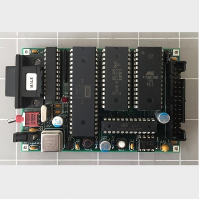

Hi Bill,
I'm using a 4-layer PCB from ExpressPCB, their MiniBoard Pro service. This features a full ground plane and power plane as the two inner layers. It's also a pretty small PCB, at 2.5" x 3.8". For the Compact Flash socket, I'm using a 3M 7E50 CF Socket which is directly soldered to the PCB, hence no adapter. All lines are quite short as well, but... there's a very short 30-pin ribbon cable (about 2-inches long) that connects the SBC (also the same type of 4-later PCB) to the RTC/IDE-CF adapter board.
On the SBC, I use an ATF22V10CSQ PLD for generating the read and write strobes (qualified to Phase 2 CPU clock) and the I/O selects, of which one is used for the RTC/IDE-CF adapter. The adapter uses the ATF16V8BL to further decode the chips selects for the RTC, CF Card and upper 8-bit read and write latches.
It's a bit odd that authentic SanDisk cards function without issues... different sizes ranging from 16MB to 8GB without issue. Only the non-SanDisk cards are problematic. Then again, the older IBM Microdrive also functions without issue.
Of course, thanks for insight on this... you've obviously spent more time working with CF Cards than I have.
Perhaps this makes sense if one considers that the internal design of the CF card will also be better or worse as far as the return path for the signals, the amount of ground bounce induced by that, and so on?

Missed your earlier post on the previous page... all good points. Based on my post, I'm thinking the 4-layer PCBs with power and ground planes, coupled with short traces should minimize most issues. Of course, the 2-inch ribbon cable connecting the boards can be a source of problems... but I'm reworking the adapter for better power supply decoupling specifically for the CF Card socket. I can also add the 100-ohm series resistor and 100pF capacitor to the Read_Strobe line as well. Overall, I'm pretty happy with the current operation with the authentic SanDisk cards so far... but more compatibility would be welcome.
I'm currently doing all testing and coding with an 8MHz setup, albeit the actual spec will be with a 6MHz CPU clock, as I only have one SCC2691 UART that runs at 8MHz, all the rest are 6MHz reliable only. Perhaps a slightly slower clock will help as well, time will tell. And I agree.... Bill has some great insight on this stuff. I picked up his Tiny68K board last year... nice bit of kit running CP/M 68K.
