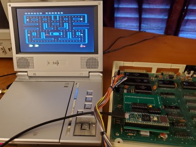

I have a update on the MCL65+ on my blog: https://microcorelabs.wordpress.com/2021/01/06/mcl65-update/
I was able to run a number of VIC20 cartridge games such as Jungle Hunt, Pac-Mac, Star Trek, and a number of others in an effort to shake out issues with the correctness and implementation of the MCL65+'s emulated 6502 core as well as its bus interface. If there is one more more "killer apps" you can suggest or would like to see please let me know and I will try!
The next things I would like to do is running in an accelerated mode, and trying it on an Apple II+.
Depending on the level of interest, I also need to figure out a way to distribute the bare PCBs... I can either handle it, or could possibly use a third party. Any suggestions? They use all through-hole components and the software environment is the Arduino IDE (Teensyduino actually), so it should be inexpensive and easy to duplicate this project!
Thanks,
-Ted

I uploaded the MCL65+ project to GitHub: https://github.com/MicroCoreLabs/Projects/blob/master/MCL65%2B/SourceCode/MCL65%2B.ino
This is the code/sketch I have been using on my VIC20. I did not include any of the cartridge ROMS, however they are easy to add if you wish. You can run the cartridges and expansion memories out of the Teensy's internal RAM as either cycle accurate or accelerated modes. You can also simply populate the complete 64K RAM array with your own code image which was how I ran all of the popular 6502 opcode tests.
The bus interface is abstracted from the emulated CPU core so you can run the emulation with your own top level interface rather than use the 6502 bus signals. The core is cycle accurate and supports most of the undocumented opcodes which are needed to run some applications.
I was able to accelerate some VIC20 games and applications and got interesting results. When the cartridge, RAM, and ZeroPage/Stack address ranges were accelerated, some games actually ran extremely well.. Meaning the original speed was too slow, but when accelerated became more fun to plan. This includes Pac-Man, Donkey Kong, and a few others. Defender was a little too fast when accelerated... I was not able to successfully accelerate the VIC20's BASIC by much. When I accelerated the ZeroPage and Stack I got about a 15% improvement in speed... But when I tried accelerating the BASIC or KERNAL ranges I got garbage on the screen, so there appears to be some timing dependancies with the VIC20 BASIC.
I believe this makes it the world's fastest VIC20... :)

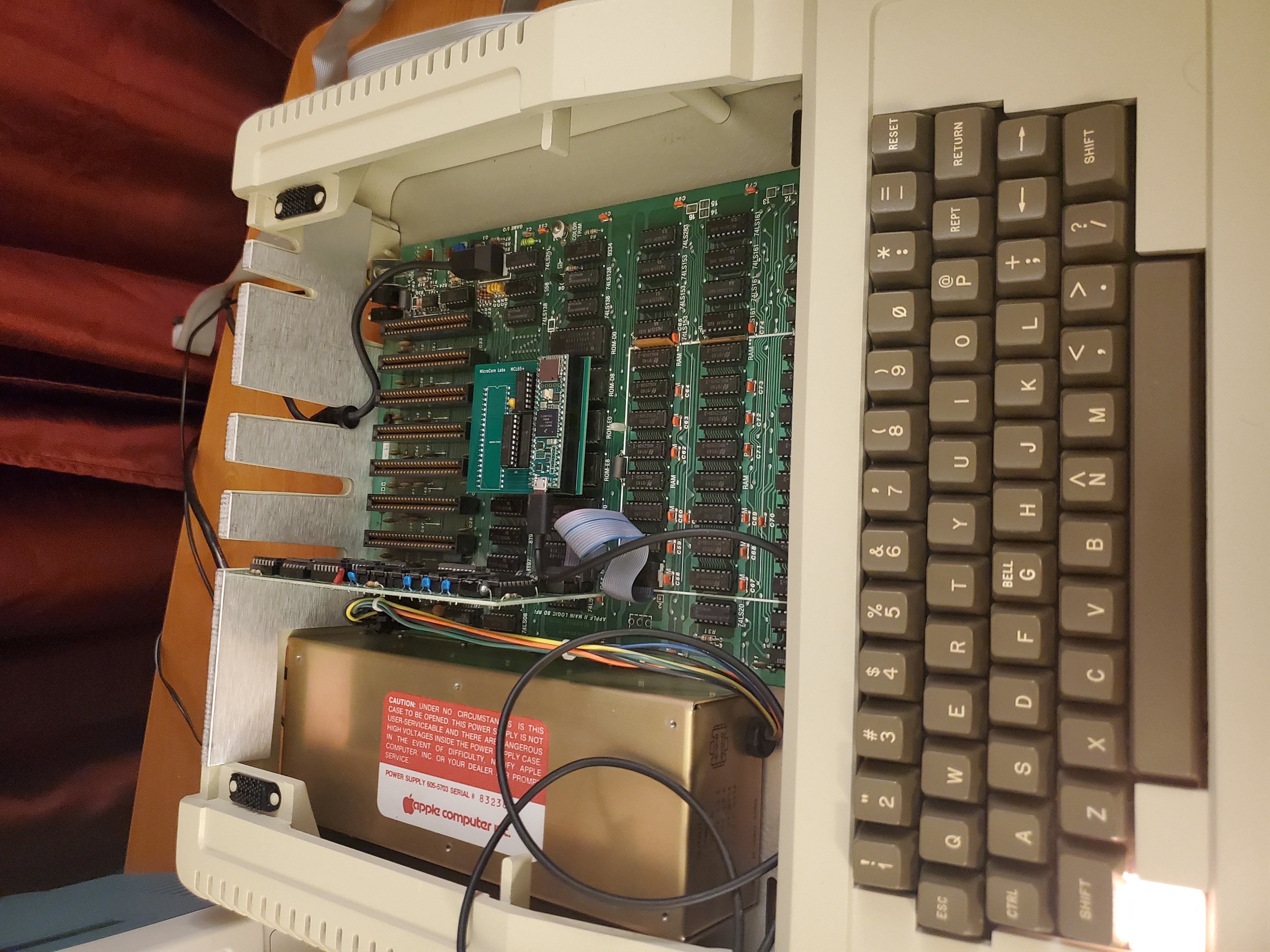

I have yet another update: https://microcorelabs.wordpress.com/2021/01/08/mcl65-worlds-fastest-apple-ii/
Im happy to say that the MCL65+ 6502 emulation also seems to work in the Apple II+.
I was able to run in cycle accurate mode, and then I began mirroring address ranges from system DRAM into the core where reads are served by the internal RAM array, writes pass through to the system memory, and both are cycle accurate. After that I emulated all RAM and BIOS ROMs using the accelerated internal array which runs at 600Mhz. I was able to just leave the I/O and video memory ranges as cycle accurate while the rest was accelerated!
The results were pretty dramatic! I did some simple tests in BASIC where I measured about a 6X speed improvement when running in accelerated mode over the 1Mhz cycle-accurate mode...
Cycle accurate mode: https://www.youtube.com/watch?v=UuSb7mrw3xg&feature=youtu.be
Accelerated mode: https://www.youtube.com/watch?v=rvJsCMR0qbo&feature=youtu.be

This may be the most cost effective accelerator for the Apple II line of computers. There were some accelerators available (a ZIP Chip at 8mhz, or the recently A2Heaven accelerator that can be cranked over 14Mhz), but they are comparatively expensive and I am not sure they work on the Apple II+ as they use the 65C02.
There was a Saturn Accelerator card and some clones that will work on the Apple II+, but they typically ran at 3.57Mhz.

It's actually more than ten times faster... My initial test program spent a lot of time printing numbers to the screen which goes onto the 1Mhz bus which slows it down. If I just print once every 1,000 iterations it is significantly faster because the complete program runs out of internal memory... I have not yet looked at the bus when this program is running but there might be additional BASIC or OS housekeeping cycles that are also slowing it down. It's a 600Mhz processor, so I would expect it to emulate the 6502 quite fast...
