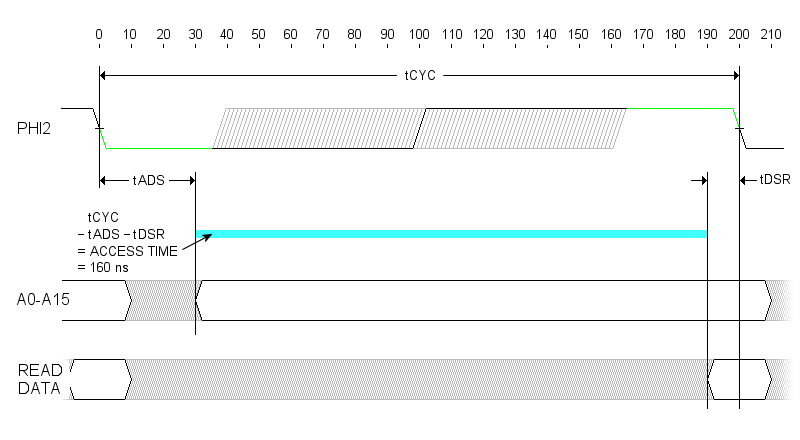

At 7.3728 MHz would 55ns ram still be the correct one to use, or should it be a different speed? If I need a different speed ram/rom, what should I be using for that clock rate?
Re: W65C265S-Based Computer
That frequency is a period of 135ns. So that's the slowest path you could expect to work, taking into account all delays: out from cpu, through glue, through RAM, over busses, into cpu. There's a good chance 55ns would be OK, but it depends on your glue.
Also, depending on your glue, the critical path might not be a full CPU cycle, but only one phase, in which case you have only 67ns. That's still more than 55ns, but doesn't leave much room for propagation delays.
(It will help somewhat that a 55ns RAM will usually run faster, because you won't have worst case power supply, temperature, or a worst-case chip.)
Posts: 3525
Yup. For hobbyist applications (ie, not life-support or rocket launches! :P ) you can assume the RAM is somewhat faster than specified. So, that's good news.
This is the bad news -- and Ed has actually understated the case. You never get a full CPU cycle, even before the glue logic delays are considered. See my Visual Guide to 65xx CPU Timing
