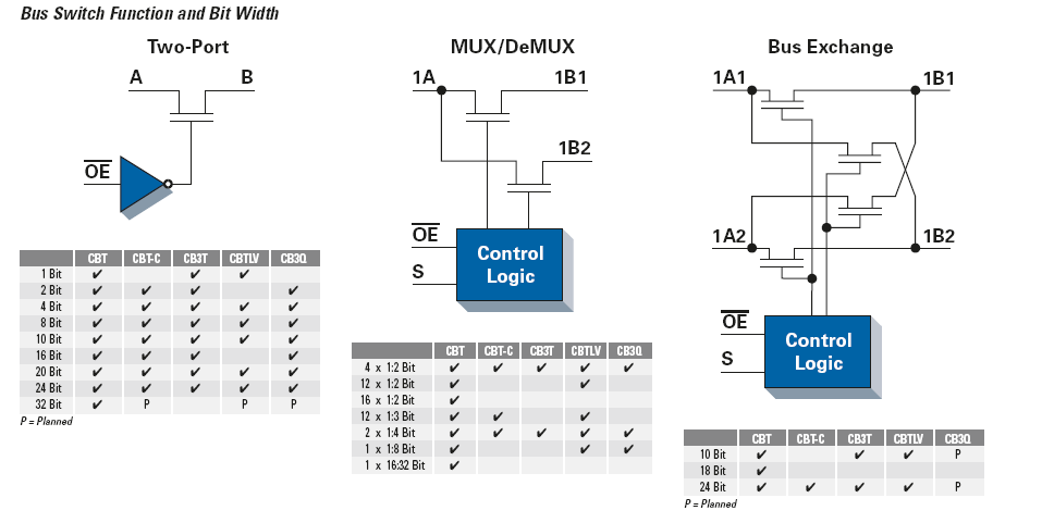

jfoucher wrote:
By having a transceiver between the select lines coming out of the PAL and the bus itself, an extension card could take control of the activation and deactivation of the expansion slots
Instead of a transceiver, consider using an octal FET switch instead. Example: 74CBT3245 (PDF below) even has the same pinout as a normal '245.
These FET Switch devices add virtually no propagation delay as a signal passes through -- except for a few ohms of resistance, it's as if the signal were passing through the contacts of an electromechanical relay. And as with a relay the signal can be bidirectional (!). The only minor caveat: as with a relay, there *is* some real delay in turning the thing on and off. Nothing extreme, just a gate delay.
There's some introductory material at the start of the Selection Guide (PDF below). On page 10 they discuss 5-volt devices.
The products are also offered in bus exchange and mux / demux configurations. Example of the latter: a 74_257 equivalent that's virtually-zero delay (also bidirectional). :shock: Such a part (or a pair of 'CBT3245's) would be ideal for letting an extension card take control of the activation and deactivation of the expansion slots.

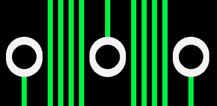

jfoucher wrote:
You can put parts on both sides, to get more on a board, even with thru-hole! :D
I've put through hole parts on both sides before, but only for simple boards. For complex boards, wouldn't the limiting factor be the number of traces that have to be run all over ? I'd rather limit the boards to 2 layers if at all possible.
Routing is always the challenge with high density. I think all board houses today can do .006" trace & space though before they start charging extra or losing reliability; and you can get up to four traces between pads of a a thru-hole IC with them. This is with pads .045"x.055" and .006"/.006" trace/space:
You can also put narrow ICs under wide ones on the same side, with the wide ones in sockets to get the needed vertical room.
Yes I saw incredible examples on your website, but Kicad complains even I put a surface mount cap under a socket :/ I should probably tweak the design rules so it stops bothering me about that...
I quit paying attention to my DRC many years ago, as it doesn't understand what I'm trying to do. At my last place of work, we had OrCAD, and it was much worse. At least with my old Easy-PC Pro I can still elect to ignore the DRC and do what I want. OrCAD was always trying to second-guess me and tell me I couldn't do one thing or another, and it wouldn't let me.
