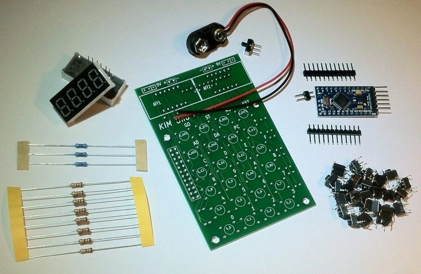

Now and then I make a batch of KIM Uno's (not for profit). But you might as well send off the KIM Uno Gerbers to JLCPCB.com (or somesuch) yourself and order the few other parts online on Aliexpress etc. The Pro Mini plugs right in to the PCB; the STM32 and esp32 have to be wired in. I'll make a new PCB version soonish to hold the 32 bitters without wiring hassle.

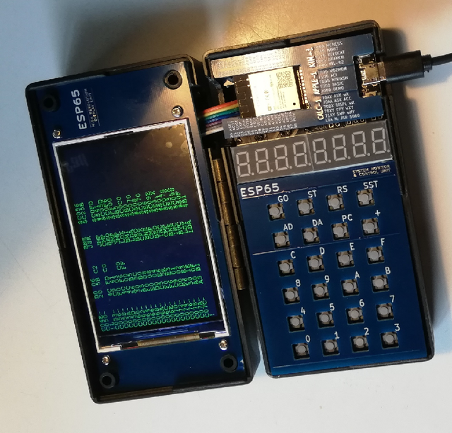

Nothing beats a good lockdown to make progress on the successor of the KIM Uno.
Here is the prototype "ESP65" in KIM-1 mode, cased with its optional fold-up display.
As my Christmas location does not offer a box of screws, the panels sit loose in the case. But never mind. Those are details.

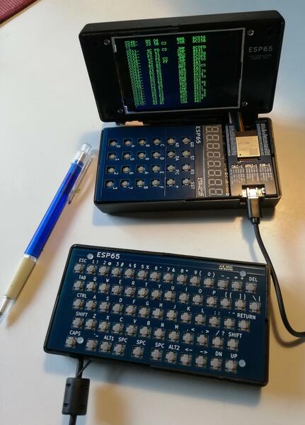

Here is the machine in its "desktop" Apple-1 mode, with the matching Bluetooth keyboard for those few moments when 6502 hex-coding is not sufficient:
As an option, you can also swap the ASCII and hex keyboards, so you end up with a mini-terminal plus handheld KIM-1 'remote'.
With lots of space in the esp32, the next step will be to get a proper 6502 operating system, DOS65, running.
That completes my purpose with this project: experience the 6502 from early hex pad programming, via the added ASCII comforts of the Apple-1, through to a 'desktop' with proper operating system.

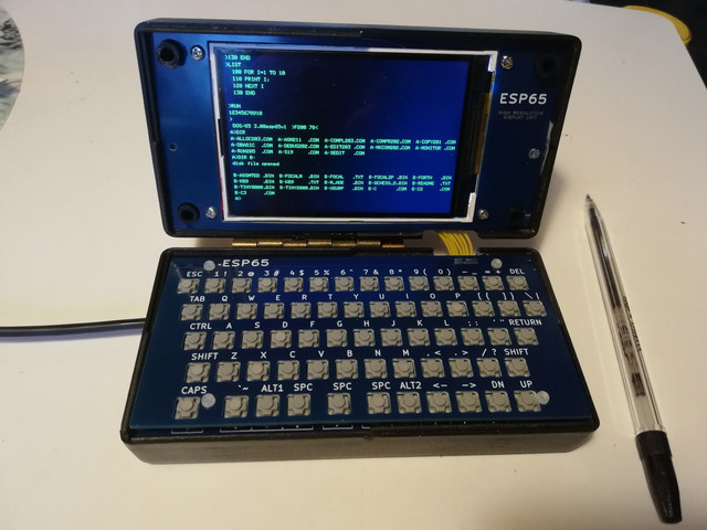

Update... I've progressed to bring together KIM-1, Apple-1 and the DOS/65 operating system so they work together. It still leaves 32K for regular DOS/65 programs, and as the DOS/65 bootstrap only takes 75 bytes of ROM, almost all 64K space is free for KIM-1 and Apple-1 software. Which DOS/65 can load from disk. Lots of 6502 software gems still to port and bring up. The first is Dan Werner's full-screen editor SEDIT, but making a VT-100 compliant terminal is nontrivial, as I am finding out.

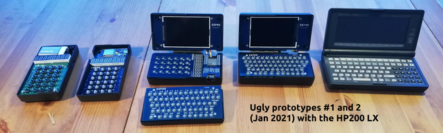

The standard variant looks like this, showing how it steps from Apple-1 Basic to DOS/65, where the vastly superior ehBasic is running as well. Hardware cosmetics will be improved for prototype 3 in about a month:
It's become a modular family of components: hex programmer's panel/CPU, ascii keyboard/CPU and display unit. Mix and match as you like, keypad and keyboard connect wirelessly:
I will upload Kicad and firmware after the next update, when they are in a somewhat presentable form.
