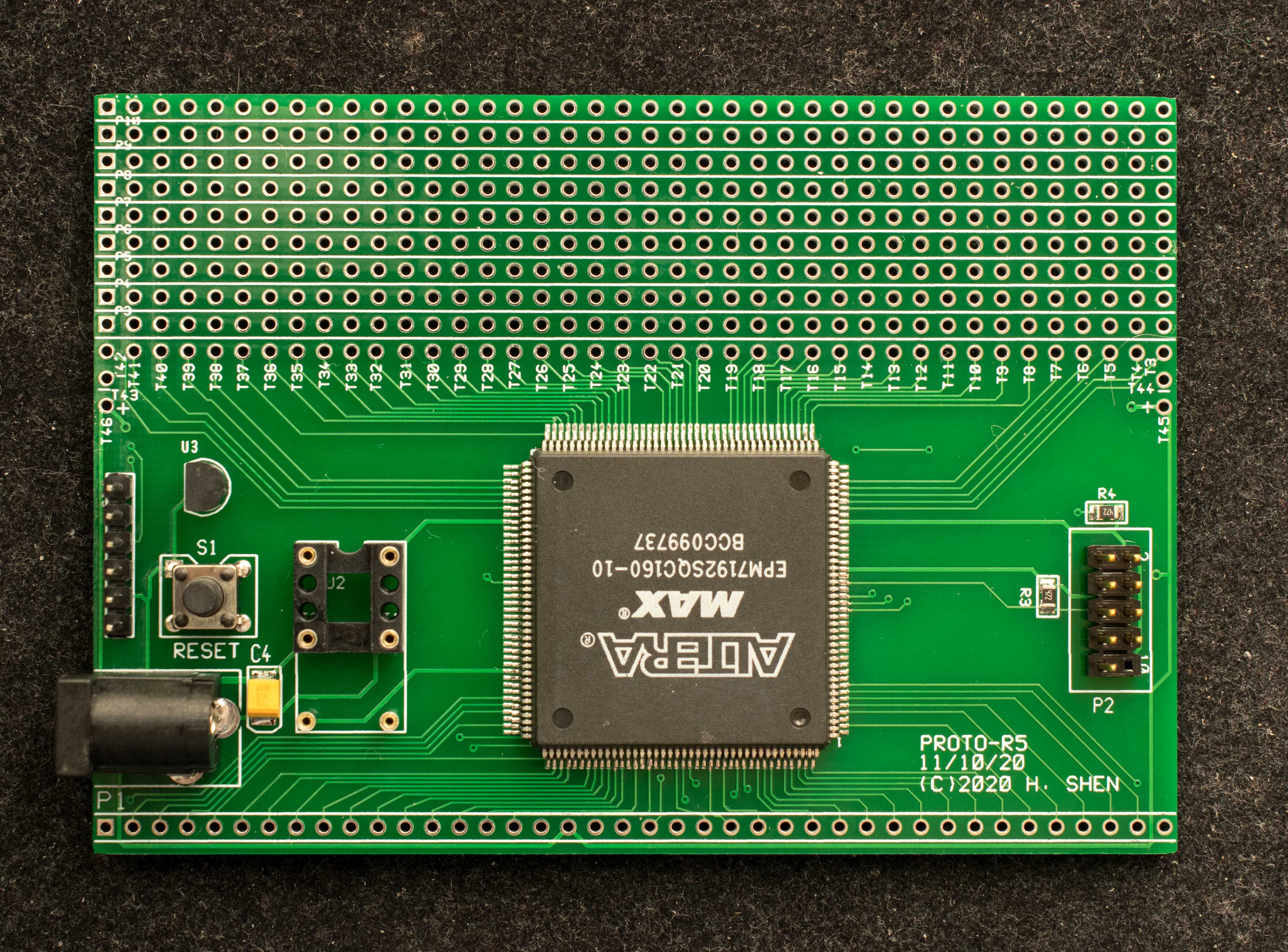

I sign up to 6502.org two years ago, but spending more time on Z80 and Z280 elsewhere. I "rediscovered" 6502.org a couple weeks ago and had enjoyed reading the many instructive postings. This place suits me and I plan to spend more time here. I don't know much about 6502 so I'm also looking forward to learn more about it here.
This being a more "techie" site, I will try something a bit unconventional: I want to build retro computers out of used, (possibly fake/rebranded) eBay parts. The challenge is not designing to the datasheet, but anticipating for the unexpected. The reason this post is under 'Programmable Logic' is because I anticipate having problematic parts and spending time debugging, so I'm depending on the programmable logic to work around the various problems. I'm comfortable around CPLD, so this is a good place to start.
I'll start with a batch of used EPM7192S purchased off eBay a decade ago. They have residual solders and some bent legs so were obviously removed from existing boards. I 'discovered' them recently in my overflowing garage and designed a prototype board for them. This is a simple proto board with EPM7192S, Altera programming header, reset supervisor (OK, confession time, the reset supervisor, MCP130, is from Mouser, but everything else is from eBay, so far...), oscillator, and header for a serial port. In the prototype area I'll place a 40-pin ZIF socket for CPU (6502 in this case), and put down a 128Kx8 RAM (specifically CY7C109-25 which I bought a reel from eBay years ago). I'll probably also install an IDE44 header for compact flash or disk-on-module. The goal for this board is a 'headless' 6502 SBC. Later on keyboard/VGA capability will be added through the expansion connector at the bottom of the board.
One step at a time, the first project is a 6502 tester to check out the random 6502 I bought off eBay.
To be continued...
CPLD EPM7192S prototype board
