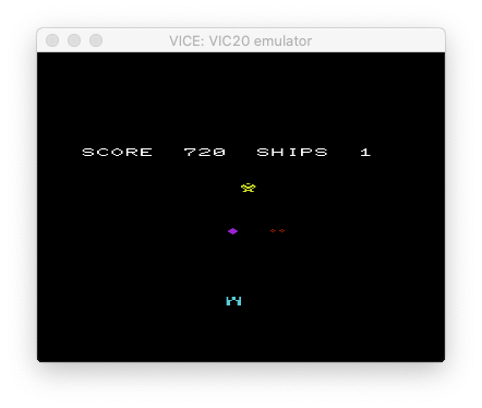

Here's it is! And in my 'umble opinion, it's better than the original, because a VIC-20 is better than the SV-328!

The VIC-20 version is particularly challenging for several reasons. Firstly, it's possible, but really tricky, to set up a graphics mode so that you only allocate space for the graphics characters you need (in my case 5 characters) and are also able to access normal text characters.
The solution is to allocate one page of memory for the graphics chars starting at 7168 (28*256), and it turns out that inverse characters appear as normal upper case + some block graphic characters. Because I only wanted 5 graphical chars, I used video (not ASCII) characters 59 to 63. I then set the end of BASIC to point to the address 7640, which meant that BASIC in fact could encroach on the character set!
The second major problem for the VIC-20 version is that it's tricky to print at any location on the screen. I chose to poke the printing position to where I wanted it, which needed 3 pokes, but subsequent testing shows that using cursor controls is much neater and faster. This had the consequence that the VIC-20 version of the game is slower than the ZX Spectrum version, though ironically the sluggishness and keyboard buffering on the VICE emulator makes the game more fun and challenging to play.

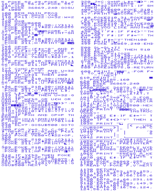

And here's the listing if you want to type it in ;-) (tap file also attached)

How did you generate the listing? Is it just a series of screen caps glued together?
(And kinda ow on readability; that 22-column screen is the one thing I dislike about the VIC-20. I suppose you could fix that by buying a dot-matrix printer, printing out the listing, and posting an image of the scanned printout. :-))

How did you generate the listing? Is it just a series of screen caps glued together? (And kinda low on readability..
I'm afraid so! And the best way to grab them is to list the program backwards, because it's tricky to stop the listing at a given page. Instead I did LIST, captured the last screen (which started at 1065); then LIST -1064 whose screen started at 1025, then LIST -1024 etc until I got to LIST -99. 10 screenshots in total.
