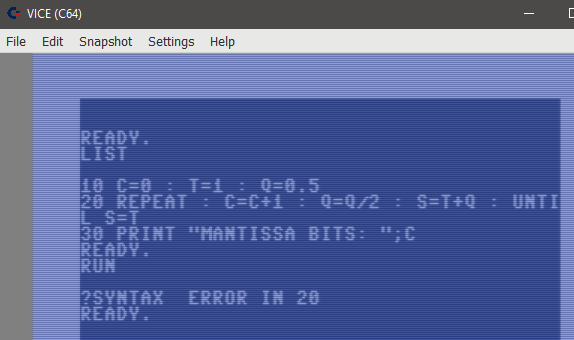

litwr wrote:
cjs wrote:
Also, again, since you surely translated Chromatix's program rather than running it directly, you should post the actual code you ran.
Nothing has been translated but lines 40 and 80. For the Commodore I used....
Yeah, I'm having serious difficulty with this. I am pretty sure that CBM BASIC has no REPEAT...UNTIL syntax, and VICE's C64 simulation appears to agree with me:
I hope it will be easy to deduce line 80. ;)
Well, why "hope" when you can simply post the code you used? And ideally, provide a script that runs the emulator with that code. Even better yet, put it in a repo so that others can clone it and quickly reproduce your results. Unless, of course, you want to make a lot more work for people trying to do the reproduction.
I am really sorry. I have made same simple changes mechanically like an automaton and forgot about them. :(
10 c=0 : t=1 : q=0.5
20 c=c+1 : q=q/2 : s=t+q : if s<>t then 20
30 print "mantissa bits: ";c
40 trap 70
50 c=0 : t=2
60 c=c+1 : q=t : t=t*2 : if q<>t then 60
70 print "max exponent: +";c
80 trap 110
90 c=0 : t=0.5
100 c=c+1 : t=t/2 : if t<>0 then 100
110 print "min exponent: -";c
I think that to publish a lot of code is not a good idea. Especially if the code is almost the same as published above.
BTW the C+4/128 support DO LOOP WHILE UNTIL syntax.
