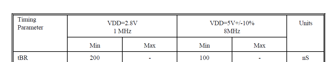

The datasheet specifies that there is no max time of delay of BE after RESB for the emulation mode to be set and external memory used, instead of the internal one.
So I just can understand why it doesn't boot from the external chips... I'm doing wrong, or I'm misunderstanding the BE driven BCR setting.
PostPosted: Wed Nov 04, 2020 11:00 pm
Posts: 344
Mistery solved: the BE driven BCR mode has no purpose other than testing the chip by using in circuit emulation mode. It has nothing to do with the use I had understood of making the '265s boot directly with external memory.
