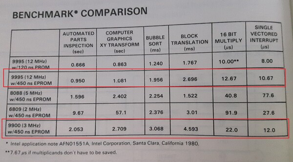

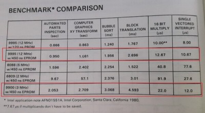

I have gotten an interesting benchmark results for the TMS9995, TMS9900, Intel 8088, and Motorola 6809. BTW it was a surprise for me that the best TI processor, the TMS9995 is actually British. It was designed in England.
782427930_20210424_1918541.thumb.jpg.aa3c4cc38e28b1e11a90dbe323e707eb.jpg [ 55.22 KiB | Viewed 1026 times ]
