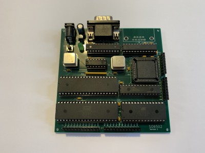

There were a lot of great suggestions for improvements, and I will definitely keep them in mind for a future revision of my PCB, but I decided to go ahead and order some PCBs based on my original design and layout.
My eyesight isn't what it used to be, and I haven't admitted to myself yet that I need bifocals or reading glasses, so soldering wasn't as fun as I remember it being. But, besides occasionally needing to use a magnifying glass, I didn't run into any issues.
After soldering, I double-checked that there wasn't a dead-short between +5v and ground, then connected power and double-checked +5V at the various sockets.
After installing the components in the sockets and powering up, everything appears to be working correctly. I have not tested all of the I/O but I have not encountered any problems so far.
Thanks again to everyone who suggested improvements!
Shawn

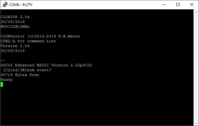

Re: My 6502 Roadmap - Comments, Advice and Suggestions Reque
Here it is running Floobydust's C02 BIOS, monitor and EhBASIC.
My next steps will be to write my own BIOS and monitor. After that, I plan to get Forth running.
Shawn
Shawn

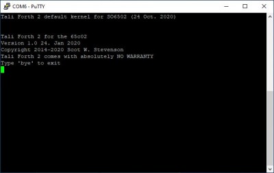

Oops! I went out of order.
Here it is running Tali Forth 2.
Shawn
Shawn
