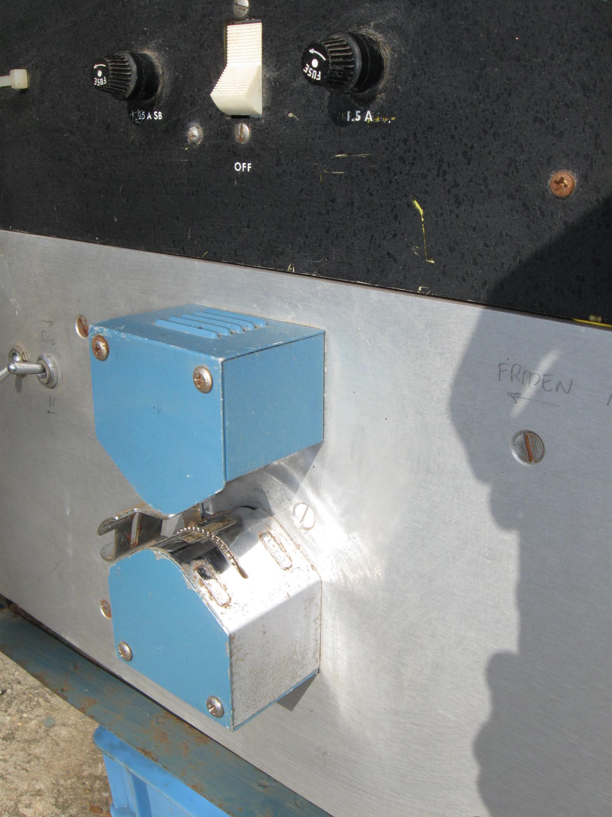

The infrastructure I created for myself revolved around a Friden Flexowriter given to me by a client. I used to send EBCDIC
I used the stepper motor powered reader, and IIRC it too could connect to the 6522. But there was also a highly perverse hookup that hijacked the KIM-1 keypad matrix. Somehow I had a 32x8 TTL PROM that input EBCDIC from the reader and simulated the corresponding keypresses on the KIM. So, if there was some frequently used ditty that required me to enter a long, tiresome sequence on the KIM keypad, I could instead just type that on the Friden once, and it'd output a tape that would effortlessly cause the KIM to hallucinate the sequence as often as desired.
I know it sounds Rube Goldberg-ish, and I may as well admit there was "a little bit"
