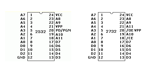

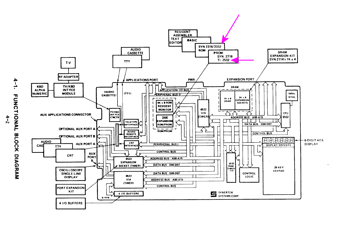

I have a Sym-1 that won't boot and I believe it might be the original 2332 mask ROM. I've burned a 2732 EPROM with Supermon 1.1 and wired the jumpers for the CS, OE and A11 pins but it didn't work. After reading through some of the documentation it seems that pin 20 for U20 is tied through an AND gate with the reset circuit to set the reset vector on powerup. Aside from just building a 2332/2732 socket adapter, is there a way to set the jumpers to allow the use of a 2732 in U20?

I had a quick look at the block diagram (below) contained in the SYM-1 Reference Manual located in our Synertek SYM-1 Resources page, and I gather that the jumpers would allow a 2332 or a 2532 to be fitted. But no word on 2732, although something may turn up if you dig a little deeper.
Otherwise, perhaps your best bet is to set the jumpers for 2532 then somehow make accommodation for the pinout differences with the 2732 you actually intend to use. Looks like you could attach the 2732's /CE and /OE together and drive them from pin 20 of the "2532" -- PD/PGM. That would be quite easy, mechanically, given how the pins line up.

edit: I didn't check the pinout for 2332. Possibly your task would be easier if the jumpers were set for it (rather than 2532).

Thanks for the suggestion, however I tied /OE and /CS together on pin 20 and it still seems to not to want to boot. Also I tested the Sym-1's 6532 and 6502 in my Micro-KIM and neither works... My Micro-KIM's known working 6532 and 6502 don't work in the Sym-1 either... This board may have been damaged at some point in the past.... :cry:
I guess I will have to learn how to use a logic probe and Oscilloscope! I'll keep you guys posted.
