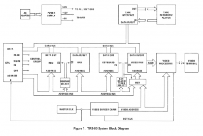

I've heard that the Z80 was particularly awkward to code for, due to a rather non-orthogonal instruction set, but I don't have direct experience of doing so. What I do know is that the Z80 handled the DRAM access cycle itself, rather than delegating this to external hardware, and that's why it performed fewer memory accesses per second than its clock speed would suggest. This had obvious implications for system design, particularly in terms of complicating the implementation of DMA-based video scanout (compared to a typical 6502/6845 system which could just insert that into Phi1).
The "easy" method of implementing video scanout on the Z80 would effectively halt the CPU during the entire display-active time, so the CPU could only execute useful instructions during the blanking intervals (both horizontal and vertical). This was a major performance impediment to several low-cost micros such as the ZX81, which was not incurred by even the cheaper 1MHz 6502 systems. I'm not even sure how the problem was avoided on the ZX Spectrum series; I do know that MSX systems had a separate video memory which did not sit directly on the CPU bus, so the Z80 only had to be paused for DRAM refresh cycles.
PostPosted: Sun Sep 20, 2020 4:06 pm
Posts: 1948
The Z80-powered TRS80 Model I had a 64x16 monochrome display that was memory-mapped and quite stable. I don't think the implementation of the display degraded perfomance in a measurable way, but I was just a 13-year-old kid when I was a user, and didn't have any detailed engineering knowledge.
PostPosted: Sun Sep 20, 2020 5:17 pm
According to the TRS-80 Technical Manual, it has a separate video RAM whose address lines are muxed between the CPU and the CRTC. So the CPU doesn't need to be halted for display scanout.
