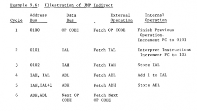

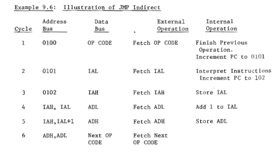

brain wrote:
Um, bugs can indeed be documented and still be bugs. All the CPUs I use have a long list of errata on them and people do indeed consider them bugs. Documenting something does not absolve it of guilt.
It is a very slippy ground. IMHO if we have a documented specification and its later changes then we have rather concept changing than a bug...
This are the exact words from the 6502 programming manual:
In the JMP Indirect instruction, the second and third bytes of the instruction represent the indirect low and high bytes respectively of the memory location containing ADL.
Once ADL is fetched, the program counter is incremented with the next memory location containing ADH.
So, it does not clarifies what happens when the indirect low byte is $FF, but implies that it would advance to the next page ("the program counter is incremented"). Yes, in the illustration it could be deduced that there is no carry in the "increment of IAL", but then clearly is a "quirk" if the implementation, not a documented fact.
We also have a table which exactly shows how this instruction executes
I pointed this table from http://bytecollector.com/archive/misc/6 ... _Jan76.pdf earlier on this forum though...
my blog about processors
