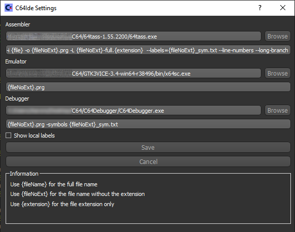

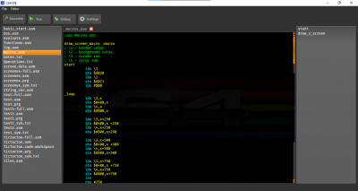

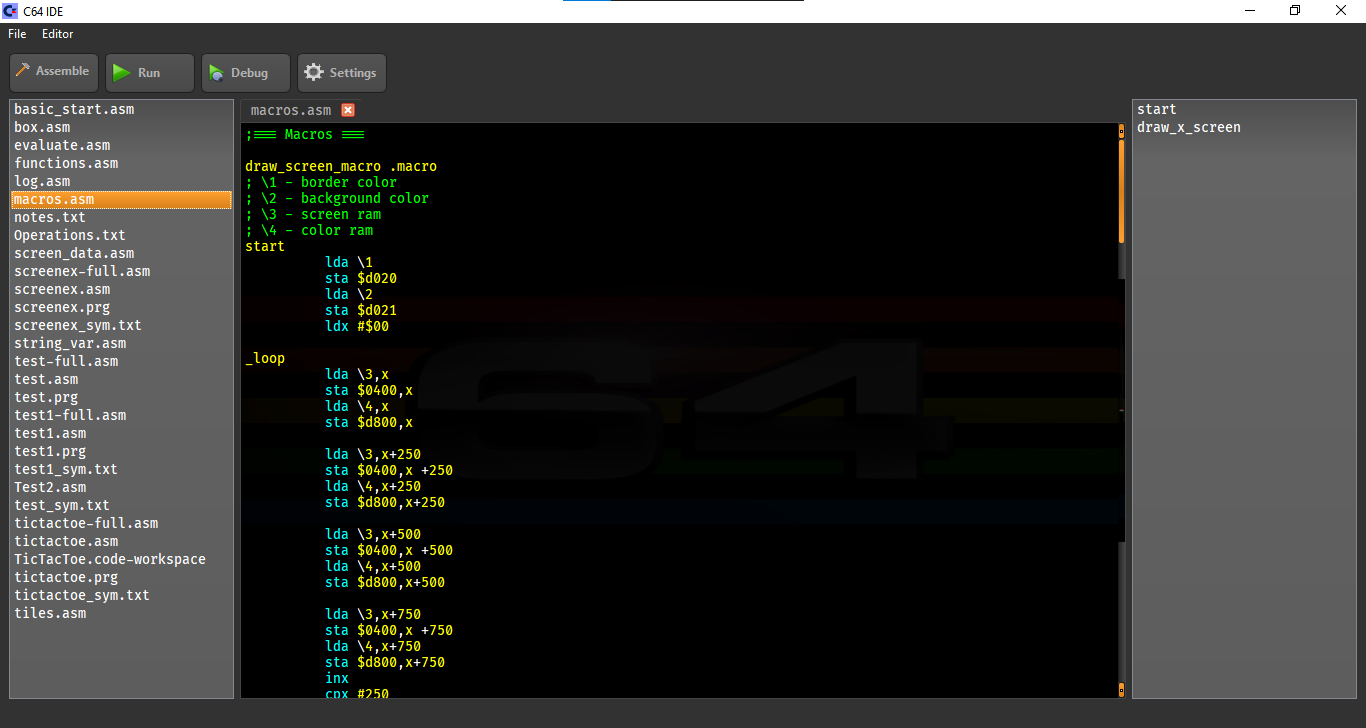

I've been working on an IDE that I'm writing in C++. It's specifically designed for my own needs. I was thinking that others may want a fast, self contained (no install required) IDE too. Attached are some screenshots of what I use. However, I'd like to hear what you guys would like to see in an IDE that you don't have at the moment.
In the main screen, on the left are the workspace files and on the right are the labels in the current file. If you click on a label then the editor scrolls to that label. The editor has syntax highlighting and auto indention.
What would you guys add?
If anyone did want to try it, it's completely free and always will be.

I can't speak for others, of course, but I want my source code text large, easy to read and in strongly-contrasting colors. I've yet to see a GUI-based IDE that has those features.
BTW, what do operands such as \2 and \3 mean? It's not any type of assembler notation with which I am familiar.
You can make the code size and colors anything you want.
The operands \2, \3, etc are macro arguments that 64tass uses.

There should be keyboard shortcuts to jump to the label under the cursor, too, instead of just the mouse. Also, back/forward navigation for any of that sort of jumping around. Maybe bookmarked locations as well that you can use with something like Ctrl-0 to Ctrl-9.
An undo/redo stack.
Cut/copy/paste.
Multiple editor panes into the same file.
Label renaming, which goes through and changes all occurrences.
Single-keystroke comments for doing section breaks, bigger title bars, etc, in whatever ASCII art is configured. In Lisp style, ";" through ";;;;" are used for smaller inline comments to larger sectional ones. That could be an easy trigger for filling in spaces/lines.

For multiple editor panes, Excel, Visual Studio, etc already do this by allowing you to drag a splitter bar to have 2 views into the same file. That way you're looking at 2 portions of a large .asm file at the same time, each in their own scrollable area, each can edit with their own cursor. Emacs does this simply by letting you switch to the same buffer from multiple windows (their word for each split panel inside an OS window).

Having a consistent length of the ";----..." bars available easily insertable is handy. Some of the Turbo Assemblers on the C64 did this in their editor with a single keystroke.
Even in your example screenshot, you have the "Macros" comment surrounded by triple bars. It would be handy to have it insert "; === | ===" for you, with the "|" representing where the cursor would be, simply as boiler-plate comment decoration, instead of always having to try to manually do them all the same.
