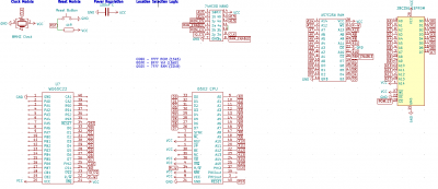

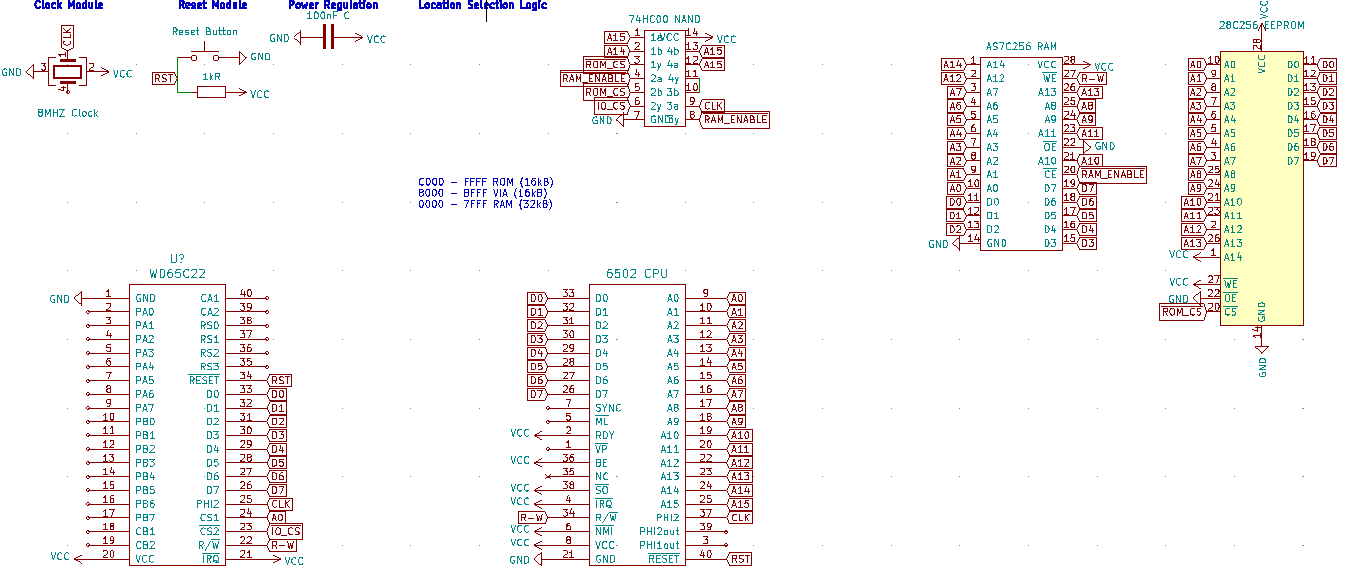

I've Begun Working on A Project with the 6502 and hope to create a working computer,
here are my current specs:
(hopefully) 8Mhz Clock
44kB of Ram
4kB of I/O Space
16kB of ROM
I'm posting here to wonder if there is anything that i'm doing wrong with my Schematic design which is necessary to fix.
Any Help welcome, Thanks!

It's much harder to follow a netlist written around boxes than it is a real schematic. The main thing I see however, if I'm looking at it straight, is that there's nothing keeping RAM from being written to during the Φ2-low time. The address is not guaranteed to be valid before the R/W line goes down; so without Φ2, you could write to invalid addresses. The bug could be awfully hard to track down just from a software standpoint. You can either qualify the RAM's WR\ with Φ2, or, if the RAM is fast enough, you can simply not even select the RAM until Φ2 rises.
The other thing you'll want to change is to de-bounce the reset circuit.
These things and a lot more are discussed in the 6502 primer at http://wilsonminesco.com/6502primer/ which was written to answer a ton of questions and problems that kept coming up on the forum. It has 22 logically organized pages covering the various aspects of making your own 6502 computer and being successful. (Several of the pages could also be applied to other processors as well.)
The RAM has a 17ns read time, so i'll probably just qualify WR with Phi2. Thanks for the information!
edit: i have fixed the problem and have therefore updated the schematic's photo

I notice your SRAM chips is 32k x 8. Anything addressed from 0x8000 to 0xAFFF will be a duplicate of addresses 0x0000 to 0x2FFF. It would be simpler to just use A15 as the CS for the SRAM to limit access to 0x000 to 0x7FFF. You could eliminate the NOR chip in that case. Use a spare NAND gate to invert A15 and feed that into 2b of the NAND to qualify the CS with PHI2.
If wiring to a breadboard, you might start with a 1 MHz clock to prove your design. Be sure to use bypass capacitors for all of your IC's, especially if you are clocking above 1 MHz.

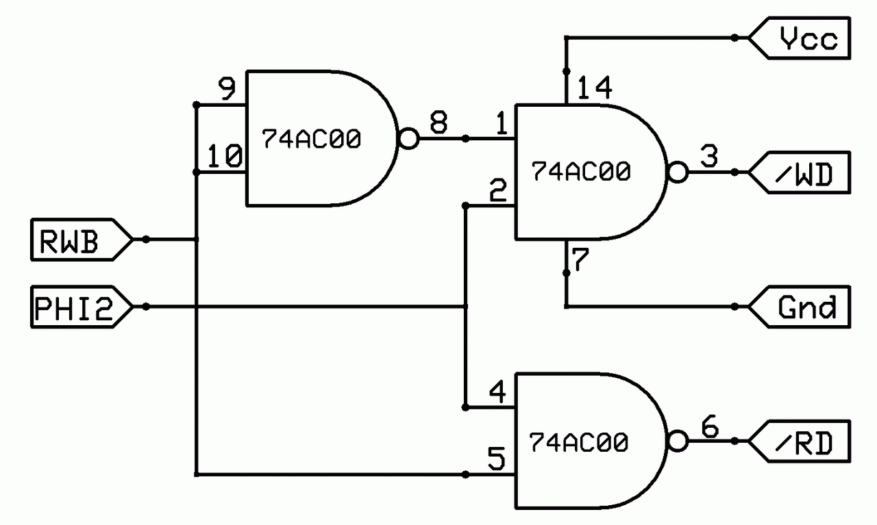

Could you please post the schematic in monochrome.
As for a read/write circuit, here is what I use. It works for any asynchronous hardware that has separate /RD and /WD inputs. Note that this circuit is not to be used with any 65xx peripheral hardware.
File comment: Read/Write Qualified with Ø2
