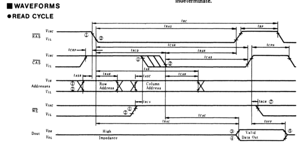

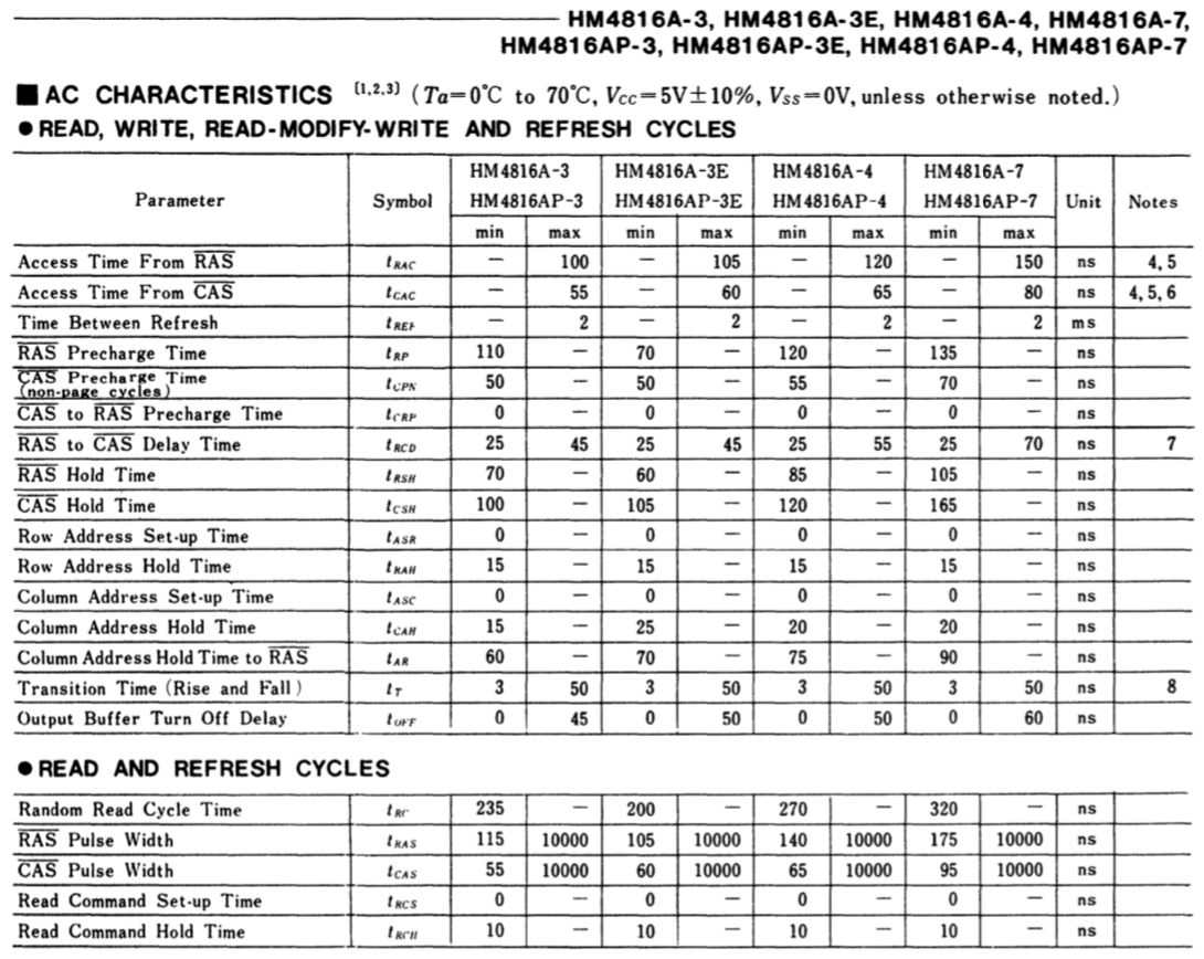

There is of course a complication, in that "120ns" memory cannot always be accessed every 120ns. The 120ns rating refers to the latency of a read access, measured between the /RAS strobe and data being guaranteed valid on the bus. But after that, there are two things which need to happen before the next /RAS strobe, beginning a new independent access, can occur. It would be reasonable to assume that 120ns memory can only sustain an access every 250ns or more, and that's if you get the timing precisely right - difficult to do with LS-TTL or NMOS logic which tends to have weak pull-up capabilities. The BBC Micro managed it, though it was using 100ns DRAM to get a guaranteed cycle time below 250ns.
We are of course talking about DRAM here. DRAM has very different access characteristics to SRAM. When building a new SBC, you would usually use SRAM because it's now cheap enough in hobbyist-computer quantities, and both fast and easy to interface to. But a home computer of circa 1980 would use DRAM, and the C64 is no exception.
I've attached representative portions of a contemporary datasheet which illustrates the problem. With 120ns memory, you could squeeze three 270ns accesses into a 1MHz overall clock cycle, but if you already have two equally-spaced accesses in that cycle, you won't be able to add another one between them.
