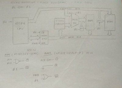

The objective:
A 65C816 based SBC, with built in VGA and keyboard interface, UART, and some sort of mass storage. I want it to be as self-contained as possible, meaning that it should be able to operate without being connected to a PC, and being able to write code for it on itself. That's the long term goal anyway.
Some "specifications":
-Regarding video, I just want it to be usable as a terminal and do rudimentary graphics. A screen resolution of 400 by 256 would result in 50 columns and 32 rows for text. That would result in 16 K of RAM for monochrome video. I could implement it with discrete IC's or using a CPLD. I want the video circuit to read off the system RAM directly.
-Keyboard, PS/2 interface using a couple of shift registers should do, could be integrated in the CPLD as well.
-UART: Either using a suitable IC or inside a CPLD if space left.
-Mass storage: Maybe an SD card with a rudimentary file system. This will come later.
-Memory: I may stick to 64 K address space, or have an extra 64 K of RAM in bank 1. I just want to build a "experimental" computer to play around with. I don't quite envision a use for large amounts of RAM.
I have quite a lot of things to figure out. I have also been fighting with the WDC software (and documentation) without much luck. I need to spend more time on it. I could try other assemblers, but having a simulator/debugger is certainly desirable. For initial development I can use the 6502 emulation mode anyway.
A possible prototype build:
I have some 65C816's around (I have done the NOP test on a couple in a breadboard, they work, but not sure if they are legit as they came off eBay) , plus HM628128-ALP-7 128 KB 70 ns static RAMs and AT28C256 15PU EEPROMs.
I thought I could build a minimal prototype system, just to get used to the 65C816 and to try out some ideas.
Of most interest would be RAM accesses during phi 1 by the video card. My TTL 6502 computer's video card detects writes to a range of addresses and saves that same data to the internal RAM.
I intend the video circuitry on this system to read directly from system RAM, as the Apple II did. The easy way is, of course, to use dual ported RAM, but I'll try not to for the time being.
So the idea is to build a simple system, in order to get that working, sticking to 64 K. I don't have to build an entire video card, just the part that interfaces with the system RAM. As for I/O, it may suffice with some push-buttons and LEDs, or even a character LCD.
Clock speed would be 2.5 MHz (20 MHz pixel clock/8, for a screen resolution of 400 by 256, using 800 by 600 SVGA timing). Significantly lower than some of the projects around here, but the Apple II GS did run at 2.8 MHz, so it should be enough for my purposes. On the future version, with faster parts, one could go with 5 Mhz and have video access RAM every other cycle...
Below is a block diagram and timing diagram of what I'm thinking about.
RAM address would be selected from either the CPU or the Video circuit by a multiplexer driven by phi 1, while ROM address would be coming straight from the CPU in order to allow it some extra time to respond (it takes 150 ns from /CS to data valid, and 70 from /OE to data valid)
Driving /OE with phi 1 would ensure it does not output while the video circuit is accessing RAM.
Also, RAM's /WE is "forced" high during phi 1, regardless of RWB.
I surely have missed something, I'm just thinking out loud.

JuanGg wrote:
The objective...
I may comment more later on, but did you by chance overlook what the 65C816 is doing on the data bus during Ø2 low?

JuanGg wrote:
The objective...
I did include a 74HC245 bus transceiver in the block diagram. Without it video RAM accesses would collide with bank address put out by the '816.

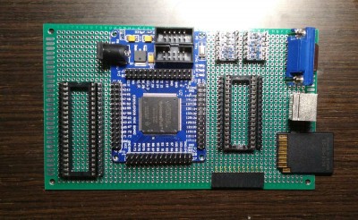

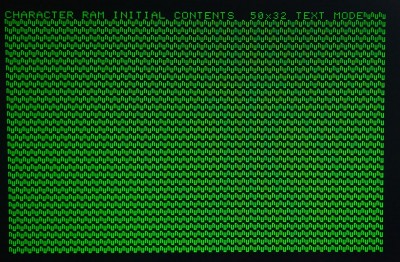

I've given it some more thought, and I'm going to throw an FPGA at it. Just because I've got one :).
I wanted to put many things inside of the CPLD, and I would need a large one anyways. An FPGA, with some amount of internal RAM, PLLs and other nice stuff eases initial development (we'll see about that). One can hold bootstrapping code on the FPGA as well.
So I would have a 65C816 CPU and extra RAM as discrete ICs, everything else will go inside of the FPGA. I will be using a Cyclone II, in the same "development" board that Grant Searle uses in his Multicomp project (http://searle.x10host.com/Multicomp/index.html).
Replicating that project sounds great, and I may in the future. For this one though, I want to do everything from scratch.
The FPGA is probably overkill for what I'm going to use it for. It may even be enough to fit a 65C816 soft core (I've searched around and it doesn't seem to be one freely available). I don't know if having an external CPU makes much sense, it's likely to be slower than a hypothetical soft core as well. But it is probably the easiest way.
Attached is a mockup of the SBC and a screenshot of the simple text-only vga card I've programmed in verilog.
I'll try to connect the '816 to the FPGA, and see how it works out. I have to figure out how to keep the CPU under reset while the FPGA boots. Maybe a simple resistor to ground suffices.
External RAM will come later, for initial tests, the 14 K inside the FPGA are enough. I'm using 2 K for the character RAM and 1 K for the character ROM for the VGA interface.
