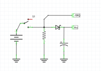

I'm trying to figure out a circuit to power down my 6507-based calculator. The IDT6116 SRAM will retain it's contents down to 2v, so the plan is to back it up with a coin cell battery and cut power to everything else when the device is switched off. The problem is, the 6507 needs some warning that the power is about to be cut so that it can finish its current task and stop writing to RAM. Is there a standard way to accomplish this?
One idea is to have the on/off switch enable power when it's switched on but somehow only pull the interrupt line down when it's switched off so the 6507 can see the request and cut its own power. It seems like this might work if I had a power transistor driven by the power switch when the switch is on but driven by the RIOT when the switch is off with a pull-up so that the transistor stays off when the RIOT loses power and the switch hasn't been turned back on again.
Another idea would be to have a one-shot 555 timer or reset chip that starts the timer on the 555 running and also fires an interrupt when the off button is pressed. The 6507 receives the interrupt and knows how much time it has to finish its work before the 555 controlling the power resistor cuts power to everything.

Potentially a naive solution, but:
Diode is some low drop type or Schottky if powering from batteries..
You could even power the display backlight (if it has one) from the /IRQ connection to give the capacitor more chance to keep powering the rest of the circuit while the 6507 does it's save-state and safe halt thing...
(Or take IRQ through a resistor - say 10x the one connecting it to Gnd if you're not happy connecting it directly to supply)

See the post at viewtopic.php?p=32004#p32004 for a simple way to do the battery backup. Then have the processor do SEI and then write to a port bit to turn things off, and go into an infinite do-nothing loop while the power is going down.
