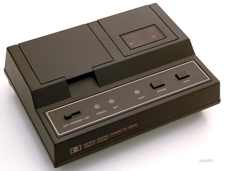

I did a little demo video of its operation, at http://wilsonminesco.com/calcs/TapeDriveDemo.mp4 . Pardon the shaky picture. The little camera is awfully hard to hold still with one hand and doesn't have image stabilization. Cutting back on the caffeine might help too. :lol: A few points of interest:
  • Looking carefully, you can see the the reels turn. Each little burst is 256 bytes. You'll hear the whir of the motors as well, especially when it fast-forwards or rewinds. The program file I'm storing is 2065 bytes long. It took less time to record the file than it did to check and update the FAT. It's a BASIC program for simulating a high-pass 5th-order active filter.
  • In the video, the HP-71 computer has one of my hand-written keyboard overlays on it, for one of my sets of custom key assignments. I have another for my text editor, and another for my Forth work. Without a keyboard overlay, it looks like this:
    This is the first computer I used Forth on (although this particluar program was not in Forth).
  • The spin out to the first available space to put the file on the tape was short, since I just formatted the tape and this was the first file. You can specify how many files you want room for in the FAT, but if you don't, the default is 128 files. No subdirectories. It spins so fast that going clear to the other end of the tape only takes a few seconds, and it stops on a dime when it reaches its destination.
  • The system lets you have as many mass-storage devices connected on the interface loop as you could want; but in this case I only had one, so there was no need to specify a device number or volume label.
I suppose this is getting off the Forth topic, but the Hobbit sounds like the Hewlett-Packard HP82161A HPIL microcassette drive, which I have two of for my HP hand-held computers.
The picture shows it approximately actual size on my monitor. It was tiny compared to the separate disc drives of the day. The microcassette being used is under the door on the right, and the door on the left holds two more microcassettes side by side. Data transfer speed was about 400 bytes per second, going in 256-byte start-stop bursts. There is no capstan. It is my understanding that the spooling motors were direct-drive (no belts or gears) and had coreless armatures to reduce mass so it could spin up instantly and stop on a dime, which is rather impressive to watch when it searches the FAT and then spins out to the desired file, reads or records data, and spins back. Other than fast-forwarding or rewinding, the only time it runs at an even, continuous speed is when it's formatting a tape. Otherwise it goes in those bursts. A $10 tape holds about 128KB IIRC! I had data arrays bigger than that, but my typical file size meant that dozens of files fit on one tape.
