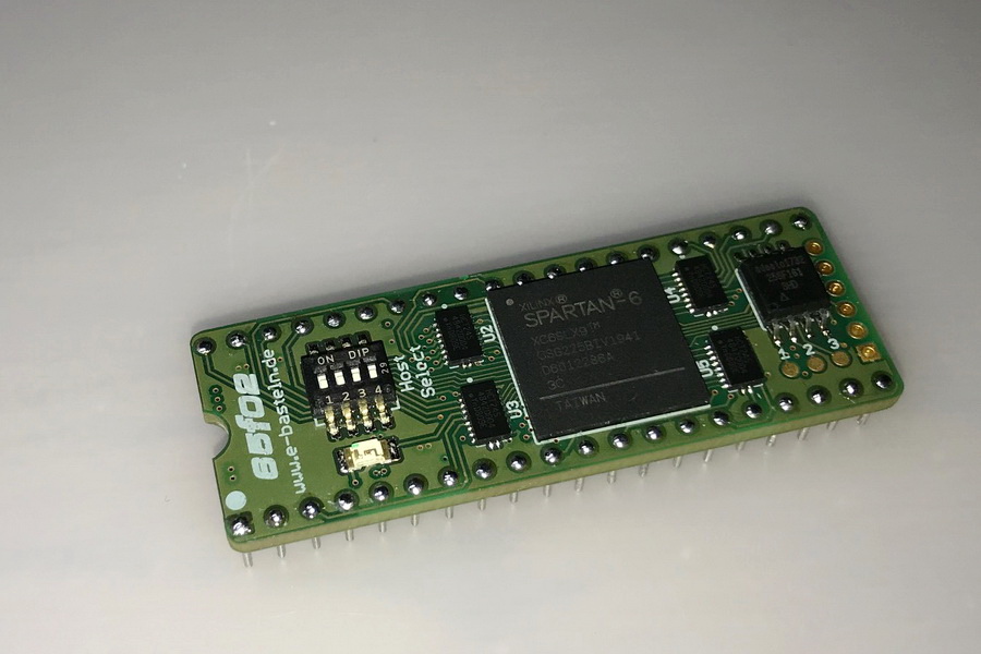

Over the past three months, I have developed yet another 65C02 replica in an FPGA, but one with a nice twist (or so I think). The actual 65C02 core inside is not my own, but is the 6502 core by Arlet with the 65C02 extension by Ed and David -- a big tip o'the hat to you folks!
I packaged this in a Spartan-6 (with 64 kByte on-chip RAM), on a small PCB which is just the size of a 40-pin DIP package, with pins matching the 65C02 pinout. I added a small state machine inside the FPGA which can access the external 65(C)02 bus with the correct timing, based on whatever Phi0 clock is coming in from the host system. Inside the FPGA, the CPU core runs at 100 MHz. I dubbed this the "65F02", where the "F" might stand for FPGA or for "Fast". ;-)

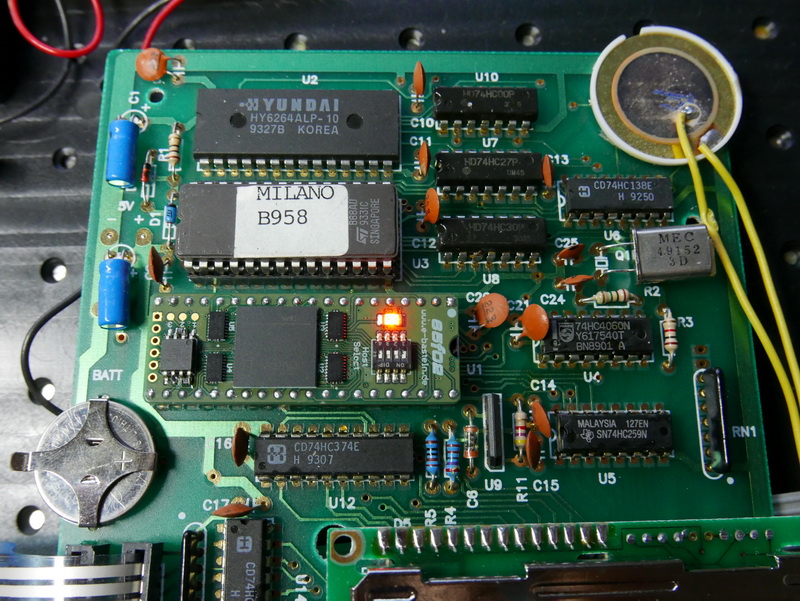

The idea is to use this as a "universal" accelerator for 6502 and 65C02 based host computers -- just plug it into the CPU socket. The only thing the FPGA board needs to know about its host is the memory map: Where does the host have memory-mapped I/O? Up to 16 different memory maps can be stored in the FPGA, and selected via a mini DIP switch. Upon power-on, the 65F02 grabs the complete memory content from the host and copies it into the on-chip RAM, except for the I/O area. Then the CPU gets going, using the internal memory at 100 MHz for all bus accesses except for any I/O addresses -- for these, the internal CPU gets halted, and an external bus cycle is started at whatever the external clock speed is.
Kudos go to Roland Langfeld, who suggested this way of integrating an accelerator into almost any host, and has contributed a lot during the testing and debugging effort. Roland's original interest was in 6502-based chess computers (there were some really nice ones in the 1980s). But we have successfully tested the prototype 65F02s in an Apple II and a Commodore 8032, as well as various chess computers. Here it is at work in a "Mephisto Milano" chess computer:
My current PCB includes level converters to provide 5V tolerant inputs with TTL logic thresholds, and full-swing 5V outputs. So it is compatible with TTL as well as CMOS environments. For the bus timing, we seem to have established one "universal" timing (setup and hold times etc.) which works in all host systems mentioned above, which run at 1 MHz to 5 MHz external bus speed.
I am not quite sure where to take this next. Populating and soldering such a board is a bit beyond the typical hobbyist's range -- the FPGA comes in a BGA package, and the level converter packages are also rather finicky. So just open-sourcing it once I have convinced myself that the design is stable wouldn't get us very far. But setting up a cottage industry to make these is not my idea of fun, and selling electronics in Europe is also painfully regulated (EMC testing, anyone)?
Hence this post. Would people even be interested in getting one of these? Any ideas how I could have them produced and, more importantly, distributed?
Of course I'm happy to discuss the technical aspects of this design too! Feel free to ask any questions, shoot holes in it, suggest improvements. ;-)

hoglet wrote:
Did you hand assemble the board? I'd be very interested in hearing more about that.
Yes, I did. I use solderpaste applied with stencils ordered from the PCB house (I used Aisler.net), tweezers and a magnifying glass for pick & place, and a manually controlled pizza oven to solder the top side.
The pizza oven is fun. I only got into that technique recently, and fretted a lot whether a PID/temperature profile controller would be needed. But it works like a charm just using a 50€ oven plus a multimeter + temperature sensor taped to a dummy PCB, so I know the current temperature near the PCB to be soldered:
    * Turn the oven up to full heat;
    * when it reaches 150°C, turn heat off for 30s (the temperature will creep up a bit more and then sit there, for soaking);
    * turn heat on again until it reaches 250°C;
    * turn off, wait 10 to 15 s, open the door a bit for slowish cooling.
The bottom side of the PCB, which is pretty busy with voltage regulators and passives, was soldered in a second step via a cheap hot air soldering station. I use lead-free solder paste on the top (since the BGA balls are lead free), and leaded on the bottom for now (so the board can stay well below the melting point for the top side).

PostPosted: Thu Jul 02, 2020 10:05 am
As the Apple II has memory-mapped graphics, I imagine you already have a mode which holds a fast copy of an area of memory, but has a write-through or write-back to the host's physical memory?
As it happens, there's a 10-year-old project for Acorn's BBC Micro which we've recently been re-investigating, for an in-socket accelerator (but a much slower and larger one) and we've seen a couple of things we have to deal with:
- the memory that's used for video can be configured to sit anywhere in the low 32k. So either we have to be very conservative with the write-through, or we have to track and model the configuration register. Or, what we're doing at present, we make the inaccurate assumption that the configuration doesn't change.
- the 16k area starting at 8000 is mappable, so we have to track the configuration register, and decide how many of the mappings to accelerate, and how many not to. If we accelerate more than one mapping, that's more than 64k total - but we have more. In your case, slurping up the newly mapped 16k might be overkill if the mapping is changed again fairly soon. Some kind of cache, with invalidation, might suit better than a full 16k copy, if the complexity is not too much.
I've a feeling Apple II cards might similarly have overlapping areas of memory? I might be wrong. Certainly the C64 has a non-trivial memory map. But for me the Acorn story is the important one!
In fact, that had not occurred to me yet -- thanks for the idea! At the moment, the graphics (and text) screen memory is simply declared as fully external, i.e. all read and write accesses go to the host system. That works, but is indeed slower than necessary: The writes could be captured in the internal RAM in parallel, and then reads could be fast, internal only. Makes sense even for scrolling the text screen, which the Apple does fully in software.
The Apple does have bank-switched memory if it is equipped with a "language card", which replaces the upper 16k ROM with extra RAM. A few of the late, high-end chess computers use bank-switched ROM as well, presumably to enable larger libraries of openings.
I have not implemented bank switching yet, and the right approach probably varies depending on the host. For the Apple, switching in the RAM is mostly a one-way street to my knowledge; it never goes back to the ROM after e.g. you boot up UCSD Pascal. So I could just ignore the bank switch, and allow the software to start overwriting the ROM contents that were initially slurped up. For the chess computers, bank switching would probably entail alternating between the slurped-up ROM contents (fast code for generating and evaluating moves) and the slow external ROM (opening library).
The Spartan-6 maxes out at 64 kByte RAM on chip (in the 225-pad BGA I am using, the largest I can fit onto the PCB). I have been tempted by its Spartan-7 cousin, which is available in the same package with up to 180 kByte of RAM. More expensive though, and annoyingly it needs yet another supply voltage. Having 5V, 3.3V, 1.8V and 1.0V supplies on such a little board seems a bit stupid...
Lots to do still; luckily I have vacation time coming up... I also want to support the battery-backed-up RAM in some of the chess computers. In that case, you don't want a write-through for every write cycle, since it would slow down the time-critical core routines. So the idea is to mark changed bytes in the internal RAM (luckily there's a 9th bit in the Spartan block RAM!); then scan the memory for changes in the background, and use vacant external bus cycles to write back any changes. That should be a nice little puzzle to implement...
