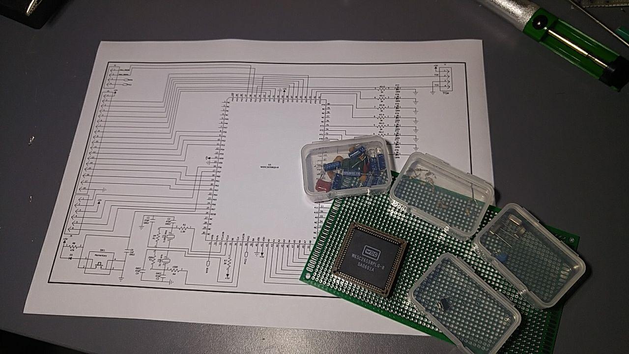

Hi. I can now start building a Mensch Microcomputer clone, so I can test myself if I can be able to get this to something done.

After a week of hiatus, I've been able to finish soldering the thing.

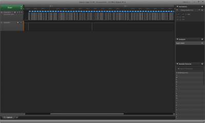

The w65c265s does use two clocks to boot: a slow 32768hz clock (CLK) and a fast (FLCK) clock, whose speed you can choose up to more or less 8 Mhz.
What's happening right now is that I put a 4,9152 Mhz crystal (as recommended in the data sheet, to be able to generate ceratin baud rates in the serial ports), but I can't get the chip to use it, so it keeps running at 32768hz (0.032768 MHz). It takes about 30 seconds just to output the welcome message trough the seial port.
I put the logic analyzer there and it detects that frequency even in the FCLK circuit... I have to figure now if the capacitors are the right value.

As I choose to put a 4.9152 Mhz clock instead of a 3.6864 MHz one, the capacitor values shown in the w65s265qbx schematics were not the right ones to the crystal I put.
The chip was running all the time at 32768 Hz. I could check that the serial port was actually sending out the welcome screen by attaching the logic analyzer. It was so slow that it took more than 30 seconds!!
I replaced the fixed value capacitors with trimmers and started to slowly adjusting them until they kickstarted the crystal. I can't tell the right values for them, though. They are such a small value that my cheap meter wouldn't give a reliable measure. The range they have is 5-30pf so the value is in there. Also, I suspect that once I start to add chips to the mix they will need more adjusting, but for now they make the '265 run.
