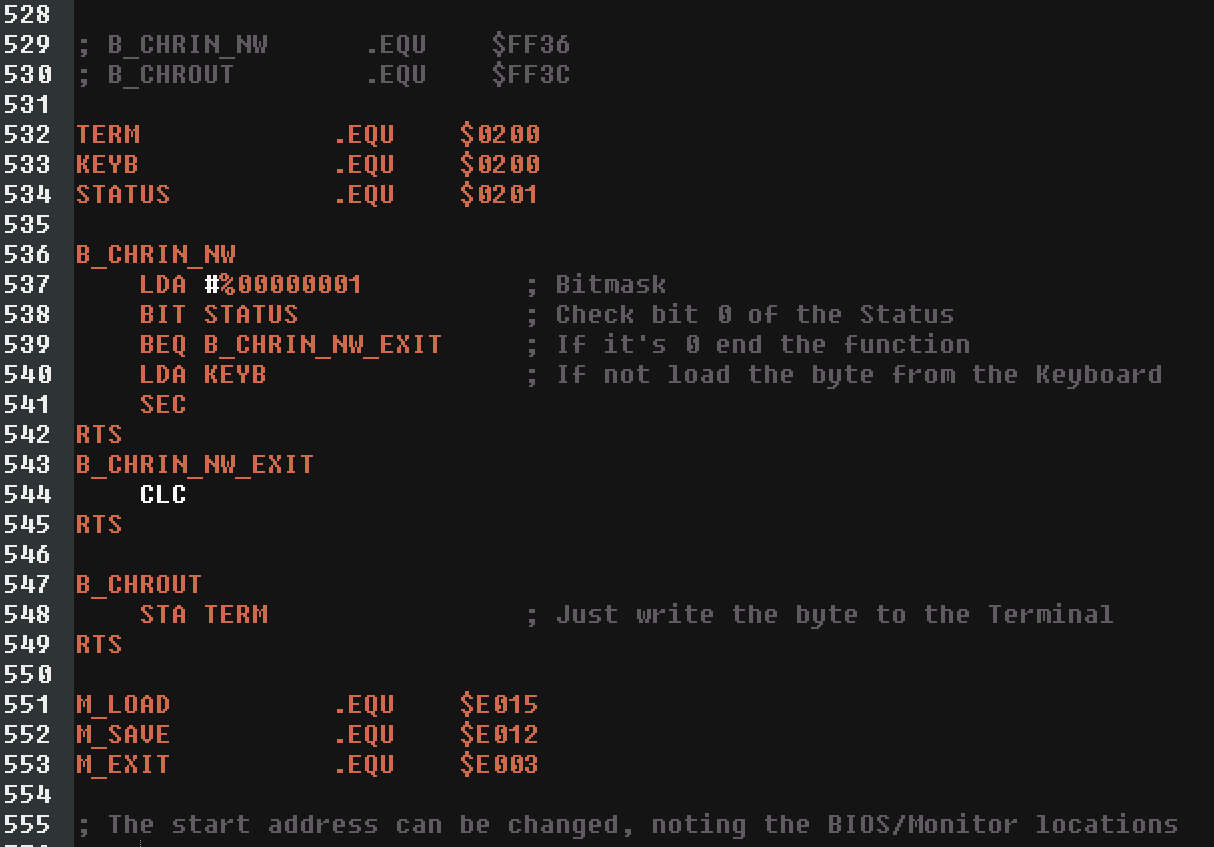

PostPosted: Wed Jun 10, 2020 7:48 pm
Posts: 746
So, on the WDC Tools install. As this is a pretty old installer, it likely defaults to the C: drive only for appending the path information. As it's a pretty small app set, I would recommend you just install it and use all of the defaults. Otherwise, you'll have to modify the path information manually.
i did try that and it just gets stuck at PATH again. i don't understand why, it added it to path successfully, i can see it when i open the cmd and type in "echo %PATH%". even adding it manually in the system settings and running it again doesn't work.
i was able to get it to work on a Win7 VM. so i guess i'll just use that for now.
i wish i have the patience to convert the whole source code to use something like CustomASM instead so software like this doesn't have to rely on incredibly outdated assemblers.
then again i doubt anyone here would be willing to switch assemblers....
For the basic code itself. Note that the code is nothing but the basic interpreter itself. You need to provide the character in and character out routines for it to work. This means you need some callable routines that allow keyboard input to EhBasic and output to a display from EhBasic. The B_CHRIN_NW and B_CHROUT are routines that are provided by the BIOS on my C02 Pocket SBC. You need to replace these with the addresses of the equivalent routines for your terminal routines. These are in the Basic source starting at line 525. Just change the first two, as you don't have functions for Xmodem load and save or a Monitor to enter.
i knew that i had to my own functions, but what i don't know is where exactly to put them in the file... can i just literally write it where those 2 constants are? like this:
that is my actual code, the B_CHROUT routine looks a bit too simple but that's just literally it.
i'm kinda tempted to just replace all "JSR B_CHROUT" instructions with "STA TERM" since that would be much faster.
anyways i was actually able to assemble it. though i had to add a TAB before the RTS instructions because the assembler thought it was supposed to be a label... *sigh*
the actual assembled file is 54k in size and i have no idea how that is supposed to fit into a ROM. there is like 44k of just empty space in there. i must be doing something wrong.

PostPosted: Wed Jun 10, 2020 8:02 pm
Joined: Tue Oct 02, 2018 4:22 am
Posts: 48
now about those errors. they are with the code shown above and i don't understand why.
C:\Users\N\Desktop\EhBasic222p5C02>WDC02AS -g -l -DUSING_02 basic.asm
WDC 65C02 Assembler  Version 3.49.1 Feb  6 2006 17:25:36
       Copyright (C) 1992-2006 by The Western Design Center, Inc.
RTS
Pass 1:File basic.asm; Line 545 # ERROR - Multiply defined symbol.
RTS
Pass 1:File basic.asm; Line 549 # ERROR - Multiply defined symbol.
2 errors!
That is an easy one to fix, you need to space in the RTS to match the line above in the code. Anything hard to the left will be interpreted as a label rather than code. The assembler is seeing RTS as a label, used 3 times to match the 3 times you added it to your I/O routines.

So, installing WDC Tools. I also use Win7 in a VM under OSX. Chances are you're getting an error as the existing path length in Win10 is too long. I think there was a change in the absolute length of the PATH in later windows versions, making it longer. I think the installer grabs the PATH then attempts to append to and set it. Chances are it's too long which is causing the error.
As per my previous post... look at line 525. I declare the routine addresses there:
; Host system routine addresses are defined here for convienence.
; They provide the following functions required by EhBasic:
; CHRIN_NW      - Character Input with no waiting - carry flag indicates data
; CHROUT        - Character Output
; LOAD          - Load data via Xmodem-CRC
; SAVE          - Save data via Xmodem-CRC
; EXIT          - Exit to warm start of C02 Monitor
B_CHRIN_NW      .EQU    $FF36
B_CHROUT        .EQU    $FF3C
M_LOAD          .EQU    $E015
M_SAVE          .EQU    $E012
M_EXIT          .EQU    $E003
So, swap out $FF36 for the address in your terminal, the same for $FF3C. Leave EVERYTHING else alone in the rest of the code. When assembling, the linker will create the output file, but if you're using my basic.wdc file, it creates a Motorola S-Record file, which will be about 28KB. Not sure what file you're looking at... can you share your modified .asm file and generated output files? Also note that my basic.wdc file shows file paths to a Z: drive, which is shared from my OSX system via VMware Fusion, so you'll probably have to modify this file for your system paths.
Beyond the above, it shouldn't too difficult to get this working. Can you post your modified files here? I can always do a quick assemble/link for you. Also, exactly what file format do you need to upload to your emulator??
