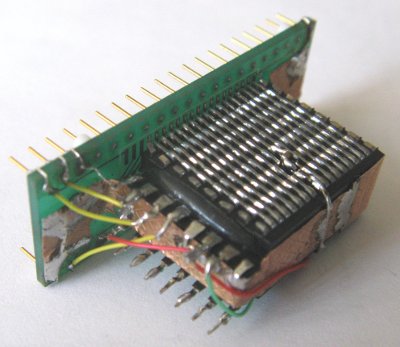

I hate throwing away good parts with bad boards, so I try to minimize that as much as I can.
If you do the piggyback thing while using the adapter Garth posted then you'd have a nice little module about 1 inch square -- 1 MB, and reusable. :!:
I mean 2 chips stacked vertically. The upper chip'll need its J-leads uncurled, but in my own experience that's doable enough. Just a suggestion.

This was my first attempt at a 4Mx8 SRAM module, doing it per Jeff's suggestion:

VERY nice, Garth!
But if stacking RAMs is the goal then we both have to concede defeat in the face of this 35-story tower! :shock:
