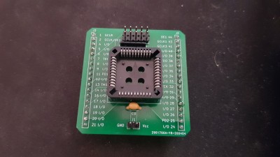

no idea if anyone asked for this, but i also made an adapter. mostly because i wanted to experiment with the ATF1504 before putting it into my SBC.
it doesn't have a key'd JTAG connector and obviously is a lot wider than cbscpe's design (which means you likely need 1 breadboard per side).
but therefore has the pin number written on it (and what it does, IO, GCLK, etc), uses the PLCC version of the chip, and combines all Vcc and GND lines together into one, to save wiring them on a breadboard.
i tested it myself and it works perfectly fine. (kinda hard to screw up a breakout board but i had to be sure)
in case anyone is interested here are the gerber files, you can just straight up upload this ZIP file to a PCB manufacturer, for example JLCPCB and it should work, since i did the exact same thing to get mine.
DROPBOX
DROPBOX
