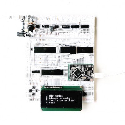

Hello,
how can I read out vast amount of texts (hundreds of lines) and display them on a 20x4 display?
What I did so far is reading up to 256 characters from the space indicated with .BYTE or .ASCIIZ and displaying it, even with scrolling the lines from bottom to top on the 20x4.
Now I want to address much more text and I fear, I miss even how to ask the right questions regarding how to do it. Because reading from .BYTE is easy to do with just counting until 255 and handing the characters over to the display. But how to proceed for much more text stored in the program? How can i read this out properly?
Thank you for some suggestions.

Thank you all so much so far! Since I'm really new in programming in general and in assembly language especially, I tried to take any hint very serious.
Thanks to @barrm95838, I started to read quite a bit on all addressing modes for the 65C02 and especially on indirect addressing, memory structure and so on.
Thanks to you, @BillG, I was then able to apply your code and learn with it. I made it to read out from the data saved in the ROM for more than 255 characters and in my case to store them in the RAM at a certain address.
I am following an approach to enter a routine to display four lines (4x20 characters) at once and then to store the "next" 4 lines (which are the previous ones minus 60 characters) at that buffer in the RAM.
You can imagine now, where i failed: Exactly at that point where the 255 counter needs to subtract the "60 characters" from the pinter (right term here?) when i reached already 255 lines (and the ZPPtr+1 needs to be subtracted as well and so on).
@daniMolina: Thank you for your post! I will try your code as well. I have some questions: Do you store the long text you are displaying at the address starting with $7000? Where is the text located first? Because I burn all the text first in the EEPROM and then try to shift it to an address in the RAM from where I read it in for the display. Where in your code is this transfer from ROM to RAM (starting with $7000, I assume)? I'm pretty sure I am missing something. Thanks for some more hints!
Here is my code example. What works perfectly is displaying the first 255 characters, each 4 lines are perfectly scrolling ... until I reach the 255 threshold and it doesn't to subtract properly (see below in the print "ROWS" routine: SBC #60 and so on):

Re: 65c02 - processing large amount of text for 20x4 LCD dis
The SBC instruction uses the carry flag to indicate whether there is a borrow from a previous subtraction; carry set means no borrow.
Usually, you will see the sequence
sec
sbc
CPY #4
BNE ZIS
Anyway...
The code
INY
BNE LP
INC ZPPTR+1
JMP LP
When you are trying to step back by subtracting three lines from Y, you are not reversing the process when you hit the beginning of a page.
SEC
SBC #60
BCS Same
DEC ZPPTR+1 ; Go to previous page
Same:
TAY

So the carry flag is set, when after the subtraction of 60 the counter does not need to cross the 255 border again. Correct?
Made my day!
