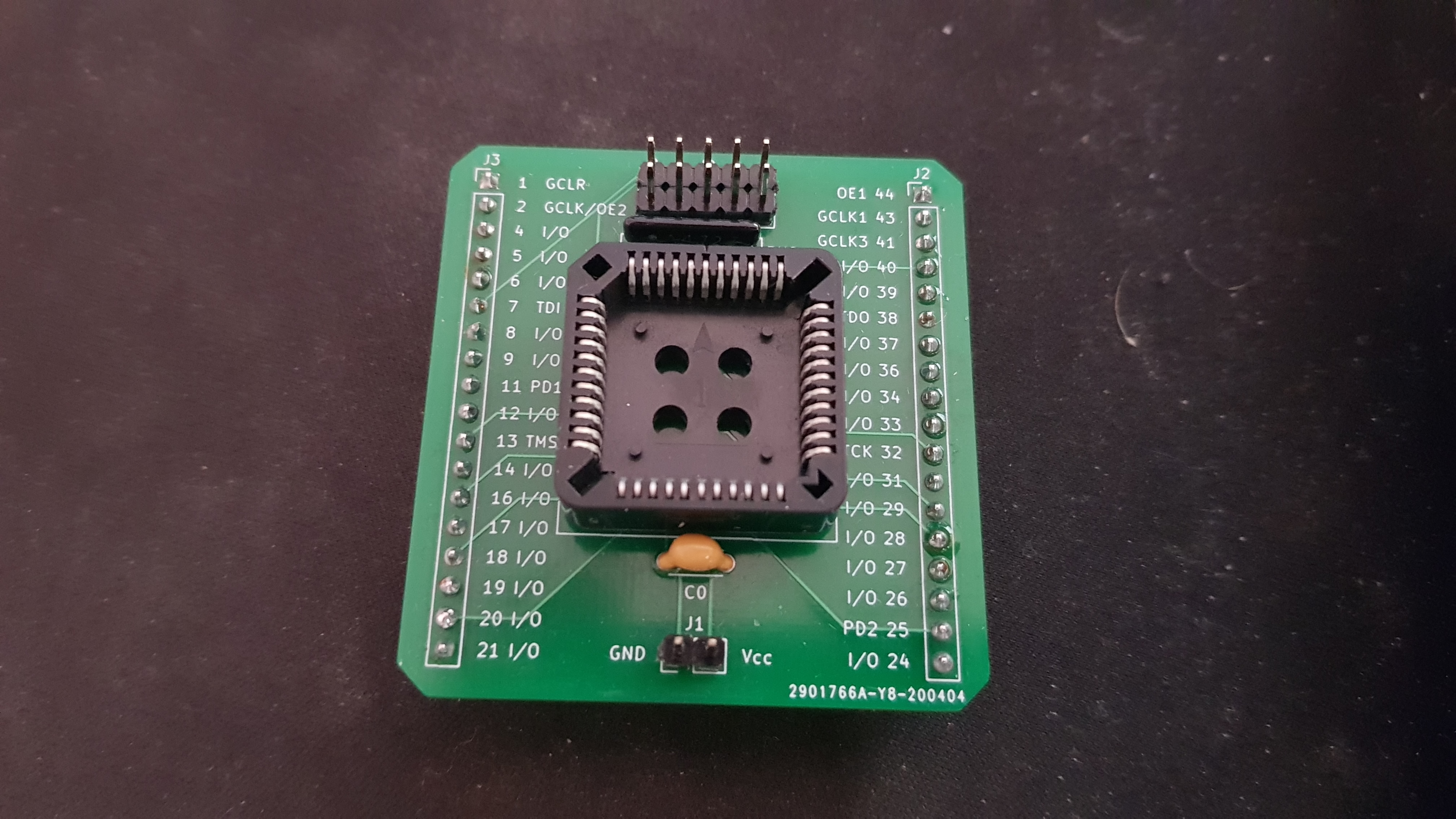

Ok so finally i got the parts from Mouser and was able to get soldering.
Yesterday i only had enough time to solder my breakout board for the ATF1504. but that was already since it gave me the rest of the day to experiment with JTAG...
and man, JTAG Programming is so easy, why did i never use CPLDs before?!
Today i was able to solder the SBC, and i was atleast able to verify that a PC recognized the FT240X when plugging it in. which is already better than last time.
here some pictures of the finished boards:

this program hates me.

Posts: 1488
Proxy wrote:
but for some reason it doesn't seem to work.
I'm going to assume you've done this already, but if not ...
Using your multimeter that has a beep/continuity tester, then you'd do what we used to call "buzzing out" a board. Remove all the chips then go through each chip socket one at a time. One probe in pin 1, then run the other probe down both sides to make sure there are no unintentional shorts. Do this for each DIL socket. Check power continuity from the power input to each component.
Another thing you can do is connect a flying lead to a spare input pin on the ATmega and an LED to a spare output pin and as part of your polling loop, add that pin into it and reflect its status on the LED - and you have a free logic probe. (Make sure the input pin is configured with the internal pull-up turned off) Use that to double-check the state of BE, Rdy, IRQ and so on.
Remove all peripherals - leave just the 65C02.
Program the 8 pins you are using for the data bus monitor on the ATmega as outputs and jam EA on it. You now have a NOP generator. Clock the 6502 and watch the address bus count up binary fashion.
That might give some insight. Good luck!
Gordon
PostPosted: Wed May 20, 2020 8:20 pm
Posts: 746
Gordon
luckly that doesn't seem nessesary... as said the IO EO/WE signals should have exactly one way to activate, but as the file showed they clearly have more
after fixing the code (which actually took a bit of rethinking) it seems fine now:

and more importantly, the SBC seems to work as well!
i got a small echo program running that just waits for data from the FT240X, once it has something the CPU reads it out and sends it back to the FT240X
it has a noticable delay when clicking keys in irregular patterns, but that is kinda expected from the wait loops i use to check for data being there...
if anyone remembers i used to have a problem where the Status byte would sometimes spit out incorrect data, making it seem like data was in the FT240X even though there was nothing.
well that seems to be gone now as well, i had the SBC sit actively checking for data while writing this and it didn't spit out any random null bytes so that's good.
now i can actually start programming something without worrying that the hardware might be faulty, yay!
though i still have to do one last botch wire, i somehow got a 3rd mistake in my design, but luckly this one doesn't effect the function of the actual computer, i just had the wrong network name for the RW pin on the Pin header in the middle of the board. so that was not connected to anything... which explains why my logic analyzer was only showing the CPU reading data... because it wasn't actually connected to the CPU...
and i can't have a broken RW pin on the pin header, i wanna use that for expansion cards in the future!
very much thank you everyone helping me out with this, i should've checked the LOG file much earlier but i just didn't think of it...
