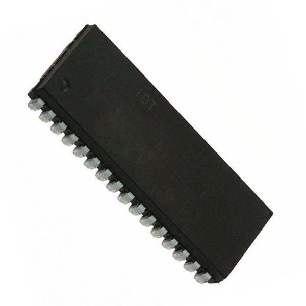

SOJ refers to a dual-inline package style with "gull wing" pins that wrap around underneath the package body. It's sort of like a a DIP package formed from opposite sides of a PLCC package.
File comment: SOJ-32 Package
Here's an SOJ-36 soldered in place
File comment: SOJ-36 Package

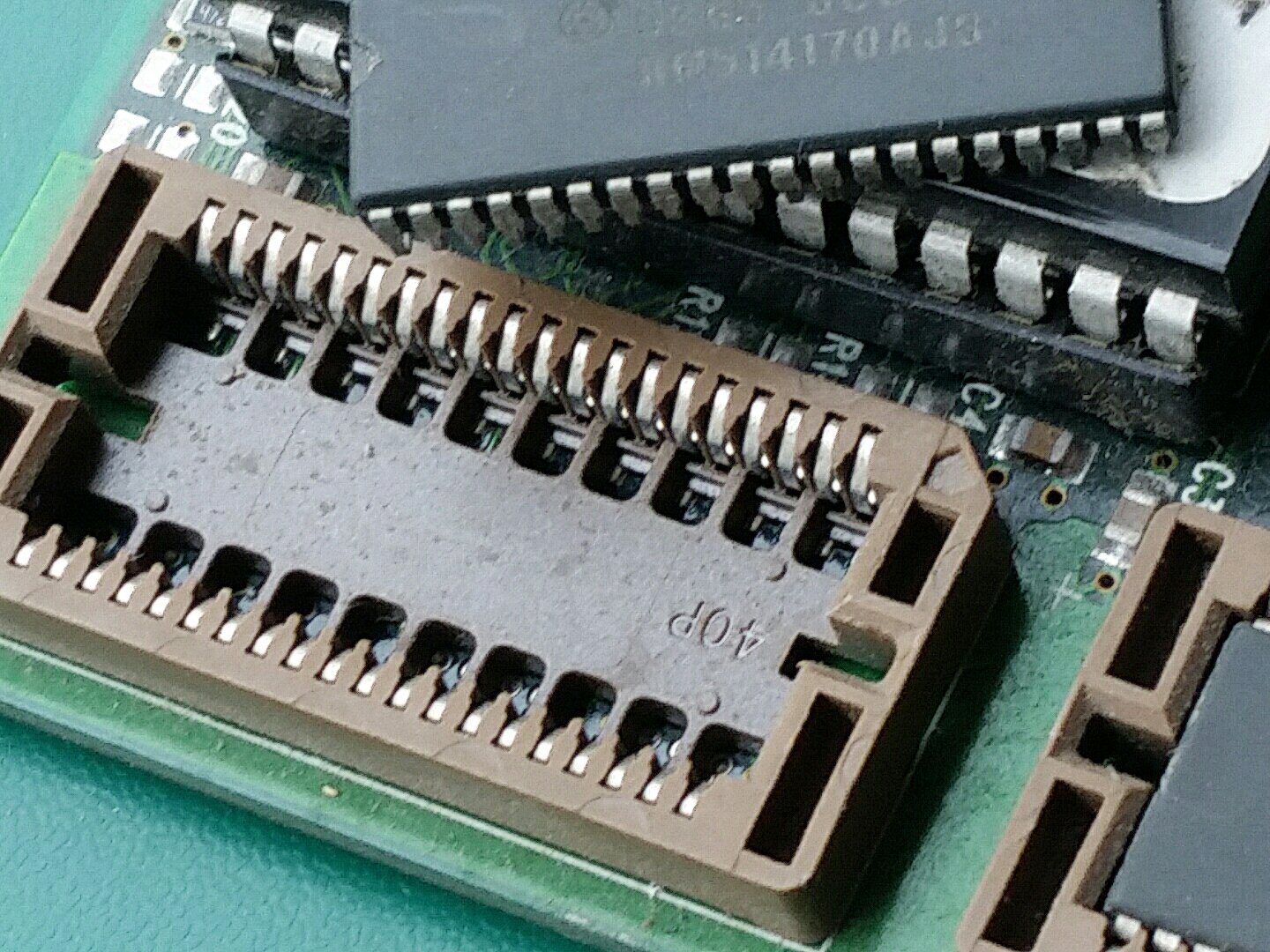

Alright, I was able to find a specimen in my junk box. And, after some none too gentle coaxing with a heat gun, I got a look at the underside, too.
This style of socket is surface-mount, of course, but I suppose it could (with difficulty) be attached to the adapter Garth posted. The socket apparently has the same footprint as the naked chip.
I don't see anything that identifies the socket manufacturer, unfortunately. But they might also market a through-hole version. It would be the exact same product, except the little tabs would project rather than lying flat. No surprise, however, if Digikey doesn't carry either version.

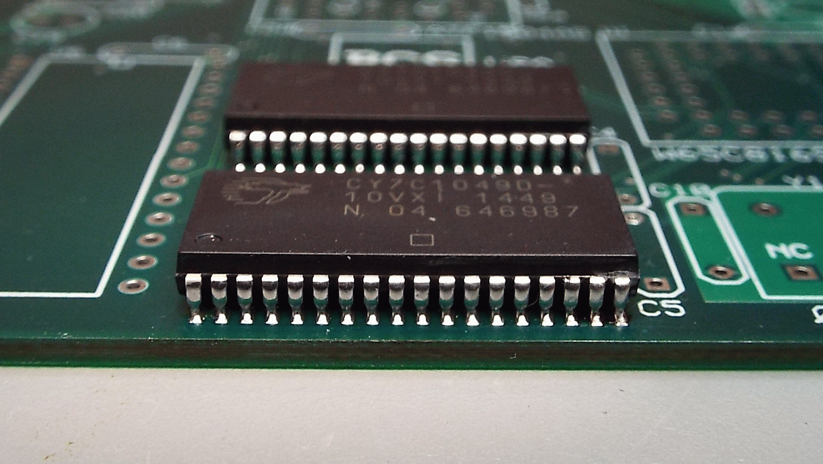

What motivated you to want a socket in the first place? It's not difficult to solder a chip like that directly to an etched PCB. Were you hoping the socket would allow the RAM to later be reused in a different project? Or do you not plan on using an etched board?
In a protoboard context I found it easy enough to do a zig-zag pattern, thus adapting such chips to a .1" grid. (See some of the photos in this post. I also piggybacked the chips, but of course that's optional).

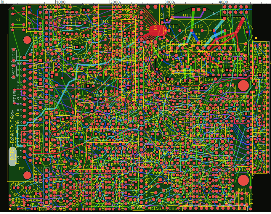

In my case it's that I don't have confidence in my PCB design skills. About 60% of the time my first run has some error of some kind. I hate throwing away good parts with bad boards, so I try to minimize that as much as I can.
(I am getting better though - it used to be 100%)
The checking method I used is in the first few paragraphs of my post at viewtopic.php?p=17653#p17653 . I do my schematics by hand since there are major things about all schematic-capture software packages that I don't like, and I do not get errors. The most complex board I ever laid out was this thru-hole one I laid out in the early 1990's. The board that was 3.8" x 4.8" with around 500 parts. It's mostly analog, with 30 ICs, and almost all the ICs have a lot of resistors and capacitors underneath them. It all worked on first try. No errors, with this checking method.
