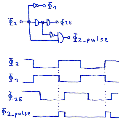

And there it was... staring at me... all this time.... Dang!
download/file.php?id=9005&mode=view
Take a look at gate U14C, in the upper left corner... The timer should tick on the rising edge of PHI2 only if DECREMENT is high.
DECREMENT comes from the clock pipeline and is always 1 when counting PHI2 pulses, and it will be a single clock wide positive pulse when counting CNT, or TA underflows.
And sure, if DECREMENT is high, a rising edge on PHI2 makes the timers tick once... but it will do the same whenever DECREMENT goes high during high phase of PHI2.
So there it is, my extra count on CNT pulses, my extra count on one-shot mode, My (unnoticed) counting one cycle earler when setting START to 1. There is it probably the cause for 80% of the issues in the timers!
I'm going to try to generate a single pulse, on PHI2 rising edge, with 3 inverters+ an and gate, pretty standard stuff. PHI2 will be delayed by an aditional inverter that will clock the FFs in the clock pipeline, adding further delay to the DECREMENT signal. At least in theory, and using the Typical propagation delays in the datasheets, everything adds up. I get a ~18 ns pulse on PHI2 rising edge, that ends before DECREMENT goes high. Everything is pretty tight though... will need to run some tests before doing anything else.
Edit: A quick breadboard test I just did is extremely promising. Passing PHI2 through 3 inverters, and AND'ing it with itself gives me a ~20ns pulse (measured with a 20mhz not-very-precise oscilloscope). Pretty much in line with my estimation. That pulse is properly driving the '193 counters, and there seems to be a 40-50ns delay between PHI2 rising edge and the counter ticking. Half of this delay comes from the counter itself. I need to make sure DECREMENT won't rise within 30-35ns after PHI2 rising edge. For that, the DFF in the clock pipeline will be run with PHI2 delayed by 4 inverters. This, along the delay of the DFF itself feels like more than enough.
Also, with such a short pulse, I'm probably diving into some high-frequency zones. A clock with 40 ns cycle (20 high 20 low) is 25 MHz. The side effects I'm seeing because of this, is that the breadboard circuits works with decoupling caps only. Without them, I'm getting random unwanted ticks on the counter. Even with the caps, I'm getting quite a bit of ringing. I'm hoping for this to be exaggerated by the breadboard and for it to be less severe on a proper PCB.
As a personal note, this is probably the first time in this whole project I've had to look this deep into the propagation delay of a whole path... and I can feel something finally clicking into my brain about it! Still a long way to go of course, but it feels very good :)

A short overview about the clock dependencies.
Changed PHI2'''''' to PHI26 (PHI2 with six apostrophes).
