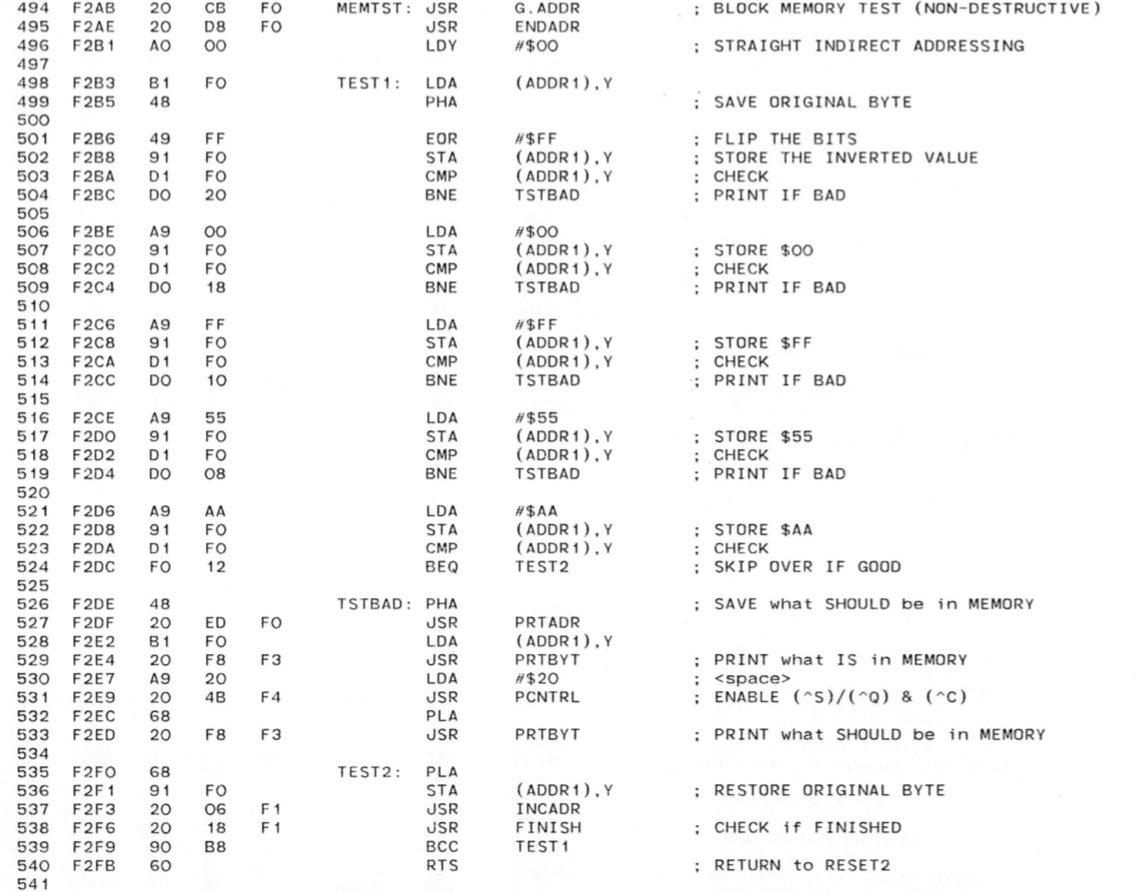

how do I create these listings (whats the right terminology?) that seem to derive from disassembly processes and that contain (from left to right):
- line number,
- memory location (or programme counter?),
- hex code,
- assembly language programme,
- comments?
(see example image attached)
I want to create something similar, not primarily for debugging but for the sake of the aesthetics of these listings.
Is there a disassembler software that creates this output out of a binary file? I would need this for MAC OS.
I'm rather new in all this. I started to learn programming in assembly with AVR Assembly language. Now I built an 8-bit system for my own based on the 65C02 following Ben Eaters videos.
So far I can create hexdump listings with Hexcode (left side) and ASCII equivalents (right side), using the simple "hexdump -C [filename.rom]" command in command line.
But how can I create more complex listings like I described above? Is this hand made or the output of a programme?
(I already checked all the disassemblers listed under "Assemblers, Disassemblers, and Optimizers" in Development Tools section of 6502.org)

I'd call that kind of thing a listing file - it's what an assembler will produce, or can produce, when it assembles the source. It's the source which contains the comments.
Where a disassembler comes in is when you don't have the source (and you can't get it from someone else) - you take a binary, a disassembler, and a certain amount of care and attention, and you construct a source file which, when assembled, creates the same binary as you started with.
You still need to add the comments, which means understanding the intent and the structure of the code - this understanding will, in part, come from the process of coaxing the disassembler into producing a nice result. The best disassemblers will take as inputs both the binary file and some annotations and metadata: these are the bits which come from your growing understanding of the code.

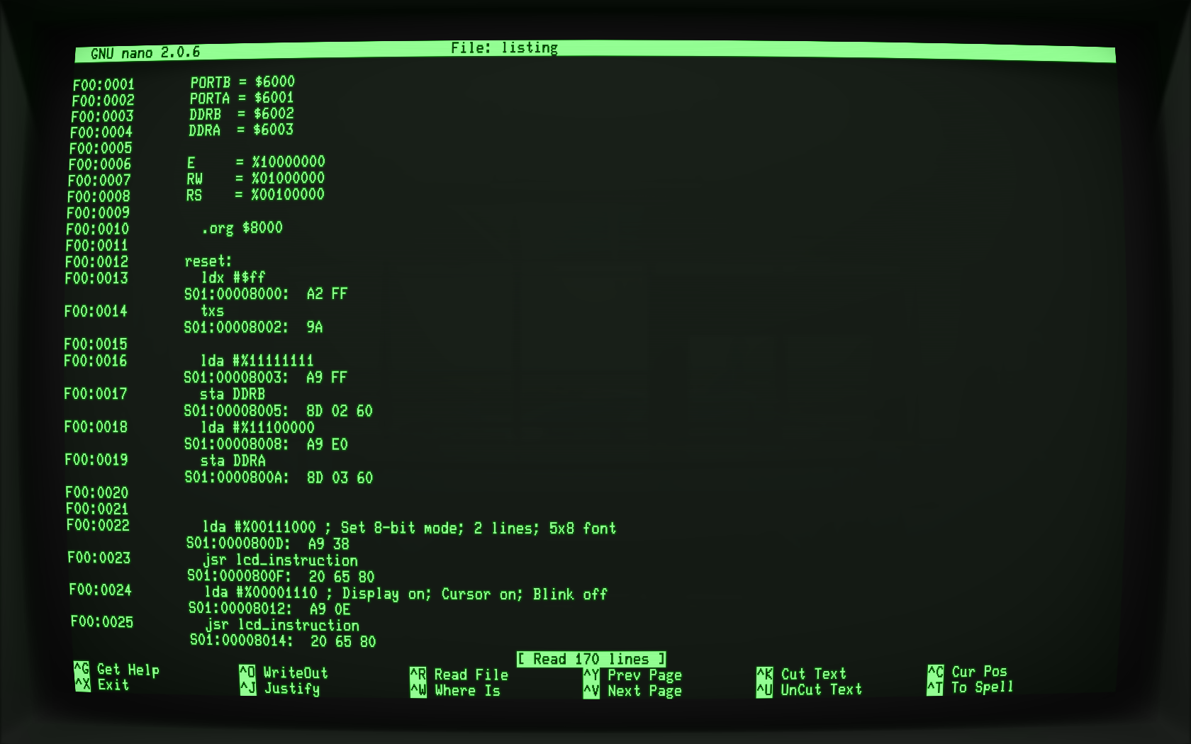

So, I assume that the assembler is creating some kind of these listings?
I use vasm for assembling my programs written assembly. Any help on how getting these listings out of there or any other assembler that works in command line on a Mac?

I would hope any command line assembler would oblige. Here's vasm's help:
‘-L <listfile>’
Enables generation of a listing file and directs the output into the file <listfile>.

Thanks a lot! The -L command works! The others give me an error message, think I need to play around a bit.
The format of the listing (see attached image) is fixed I assume, isn't it? So, I can't just put the assembly code to the right hand side of the hex code, correct?

The assemblers I've used put it like your first picture, where the addresses and hex code are put to the left of your own source code. The also have options to show the macro expansions or not. Sometimes there's an alphabetized list at the end of all the labels and how many times they're referenced and maybe a list of line numbers that reference each one.
http://6502.org/documents/books/keith_s ... _ksmon.pdf
Sometimes I scan these documents and wonder if people will read them. I'm glad to see that sometimes they do.
Here are more listings from the same set:
http://6502.org/documents/books/keith_sproul/
