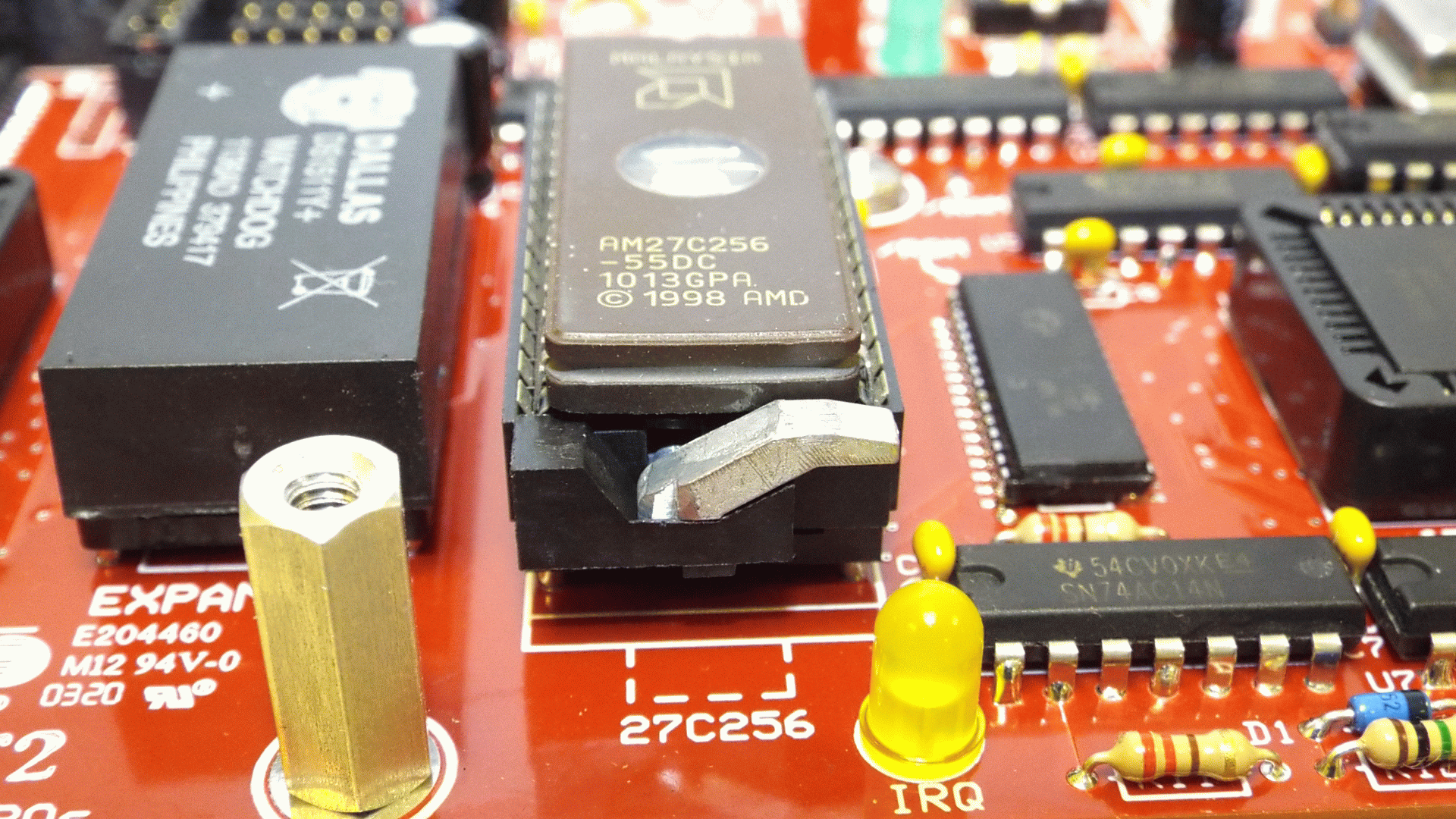

Speaking of sockets, the "machine-tooled" types with gold-flashed contacts are more reliable over the long haul, but the cheaper sockets with tin wiper contacts are better suited to situations where frequent removal and installation is common. In the case of ROMs, use of a ZIF socket is a good idea during firmware development. I didn't make room for a ZIF socket in POC V1.0, and that proved to be a mistake, as I was forced to extract the worn-out socket from the board and install a new one.
PostPosted: Wed Apr 29, 2020 4:51 am
Posts: 8546
Exactly my experience too. Of the cheaper ones, be sure to get double-wipe, ie, where both sides of each pin of the IC are contacted electrically, not just one.
I think the green TEXTOOL ones are the ones I've had kind of bad luck with. I've had good luck with all other brands.
PostPosted: Wed Apr 29, 2020 6:32 am
Posts: 8513
I've been using the below socket in POC V1.2, I have it plugged into a regular socket that is soldered into the board. It has worked out well.
File comment: ZIF ROM Socket
