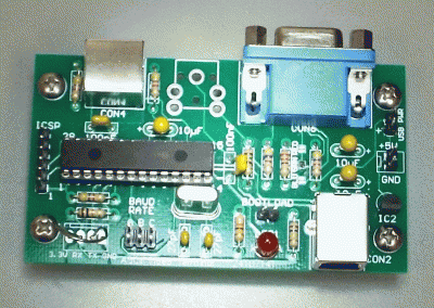

File comment: ASCII VT-100 TERMINAL — Top View

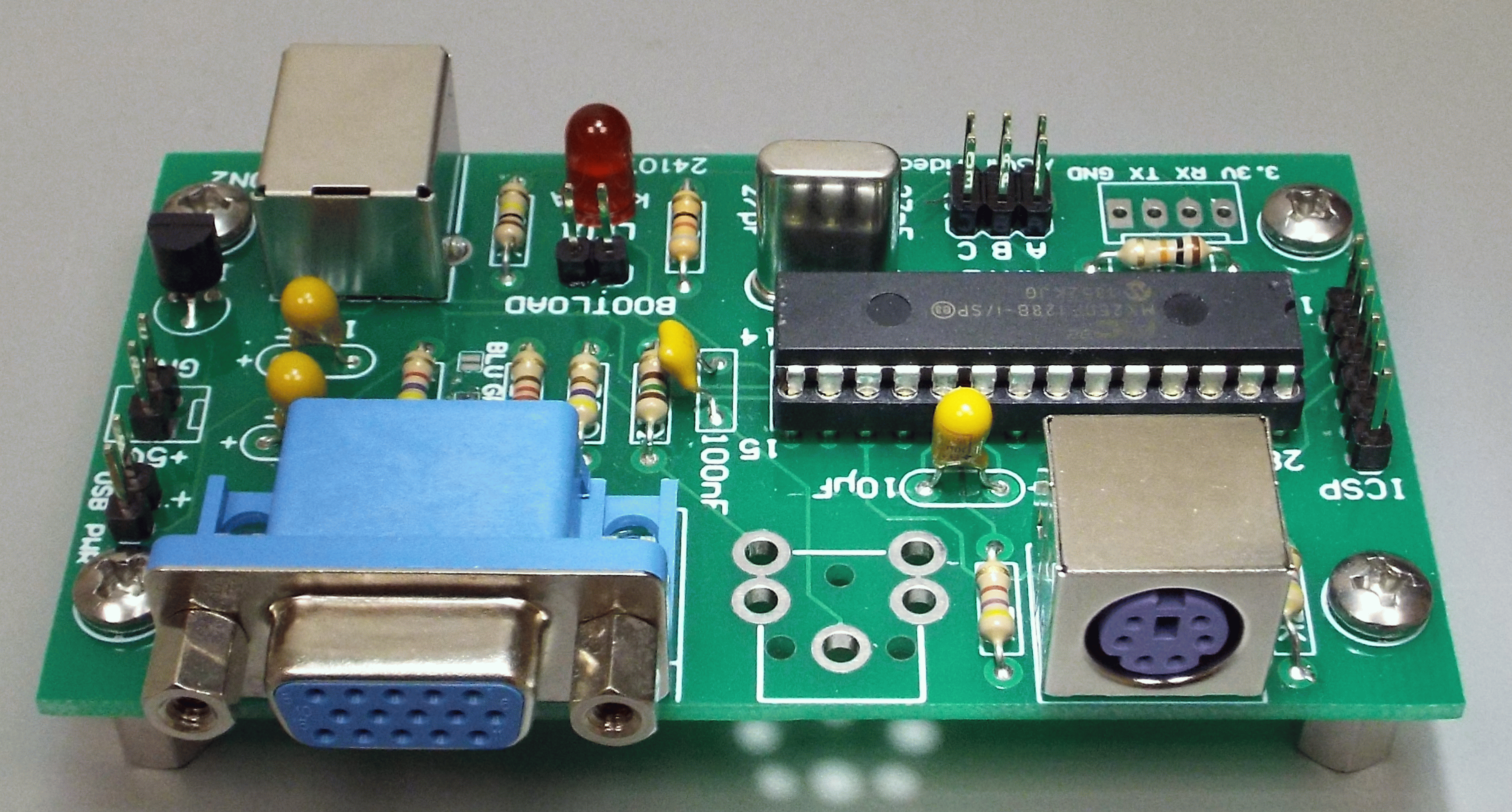

File comment: ASCII VT-100 TERMINAL — Keyboard & Video Interfaces

This unit is designed to be powered by a 5 volt source and driven by a serial interface running at TTL levels.  Although the PIC and associated circuitry operate at 3.3 volts (there’s an on-board regulator to produce the 3.3 volts), the serial-in connection is 5 volt tolerant and in fact, could be directly connected to a TIA-232 level output without damage.
The terminal understands much of the VT-100 command set, and includes the cursor-addressing functions.  Also included are the commands for clearing part or all of the display.  Absent in firmware versions prior to V1.3 are the functions for turning off and turning on the cursor, which is not a deal-breaker for me.
In addition to character-oriented features, the terminal has pseudo-commands that can generate graphic lines, rectangles, circles and filled areas, all of which are plotted in terms of pixels from the 0,0 coordinate, which is the top, left corner of the display.  Notably absent are the alternate characters that produce box drawing glyphs, such as or .  These will have to be simulated by using the graphics commands.  Any use of the graphics features in assembly language will require four-function integer math, which is not too difficult to implement on the 65C02/65C816 (there is code around here that can be used).
As far as construction goes, purchasing a PCB instead of laying out one and having it made was a less-expensive and less-time-consuming route, and virtually eliminated the likelihood of a DOA unit due to a design defect.  The unit required about three hours assembly time and worked on the first try.
On his website, Geoff has published the schematic, parts list and firmware for this gadget, which means it is possible to integrate the terminal into a larger design.  I plan to do exactly that in a future iteration of my POC series, which will result in the unit truly being stand-alone.  For now, POC V1.2 has its console channel arranged so I can patch the terminal in and test it under actual operating conditions.

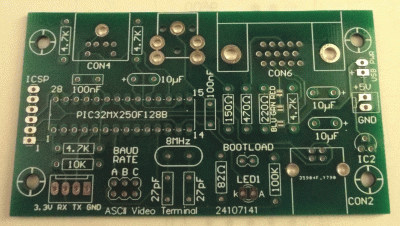

BTW, here is a pic I took of the PCB before assembly.
File comment: ASCII Terminal Bare PCB
