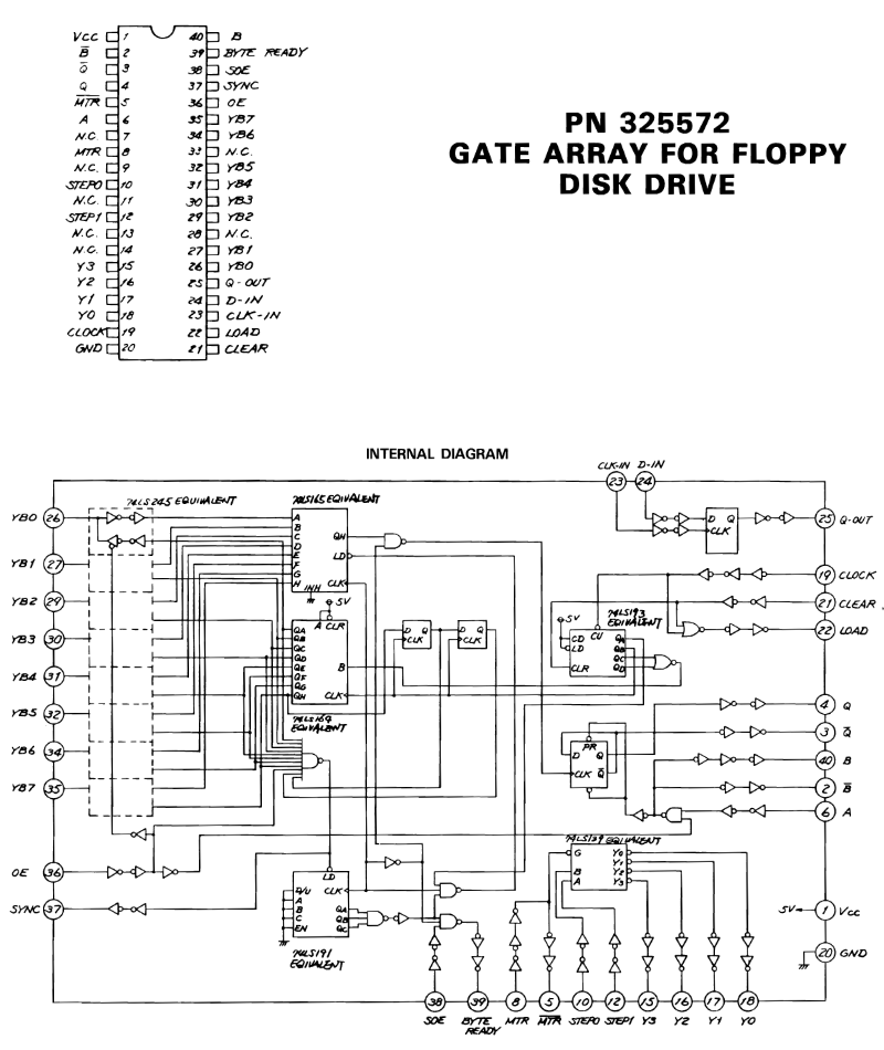

One custom CSG chip I cannot find any information about is the Disk Controller Chip for the 1541 disk drive, the MOS 325572-01.
Does anyone perhaps have some interesting links regarding the internals of this chip?

1540\1541 Service Manual, preliminary, Apr. 1985, PDF page 35 shows a TTL equivalent of the MOS 325572 gate array.
Also, the PDF contains schematics for PCB #1540049 (1541 board with MOS 325572) and PCB #1540008 (older 1541 board which uses TTL chips instead of the MOS 325572).
Hope, this helps.

Thanks for the info @ttlworks. This was exactly what I was looking for!
PostPosted: Fri Apr 24, 2020 10:06 am
Nice that so much of it is defined in terms of 74-series equivalents. You could directly build a substitute on a daughtercard if you had to.

Earlier versions of the 1541 did use 74-series chips for these functions, and I expect that equivalent schematic was redrawn directly from the original. You can find that on page 15 of http://www.zimmers.net/anonftp/pub/cbm/schematics/drives/new/1541/1540-1541_Disk_Drive_Service_Manual_Preliminary_314002-01_(1985_Apr).pdf
