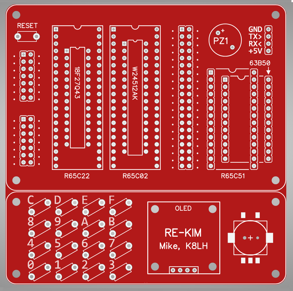

May I recommend looking at the classic KIM-1 Single Board Computer? It's about the closest thing I can think of to "bare metal" programming using a small Monitor program along with a reasonably intuitive HEX keypad and 7-segment display. Also, look at the Elektor Junior computer. It's similar to the KIM-1 in function but uses more common parts (a 6532 RIOT and a standard ROM instead of the unobtainable 6530 chips).
I've been brain-storming front panel designs, too. I prefer using a microcontroller "loader" (ROM Emulator?) and RAM-only system designs where the microcontroller loads a ROM image into RAM at startup and provides the system clocks afterwards.
Good luck... Cheerful regards...
ps: the current layout for a 5-chip "trainer" concept...
