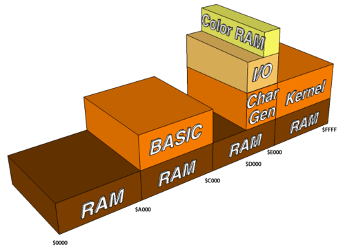

Re: Can Someone Explain Memory Mapping "Under the Hood"?
Also note that the C64 is special: it's not a basic 6502 such as a person would design for themselves. There's an excellent picture on this page:
Ram under Rom - a brief look into C64 memory
