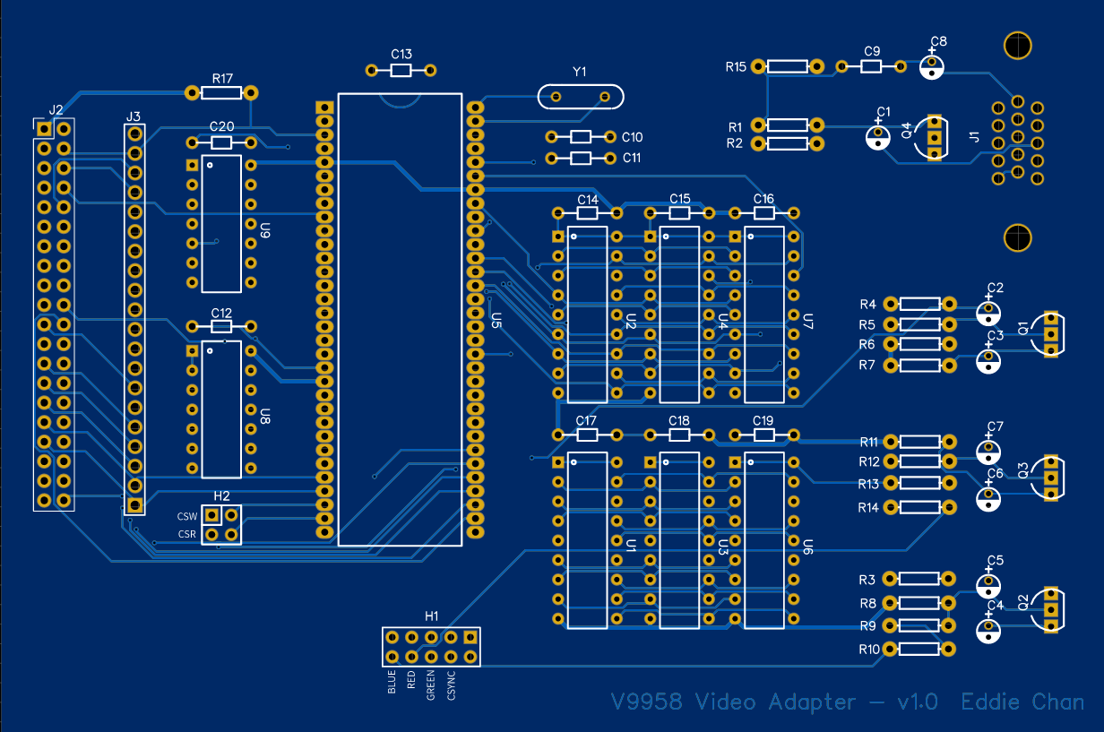

PostPosted: Mon Apr 27, 2020 2:00 pm

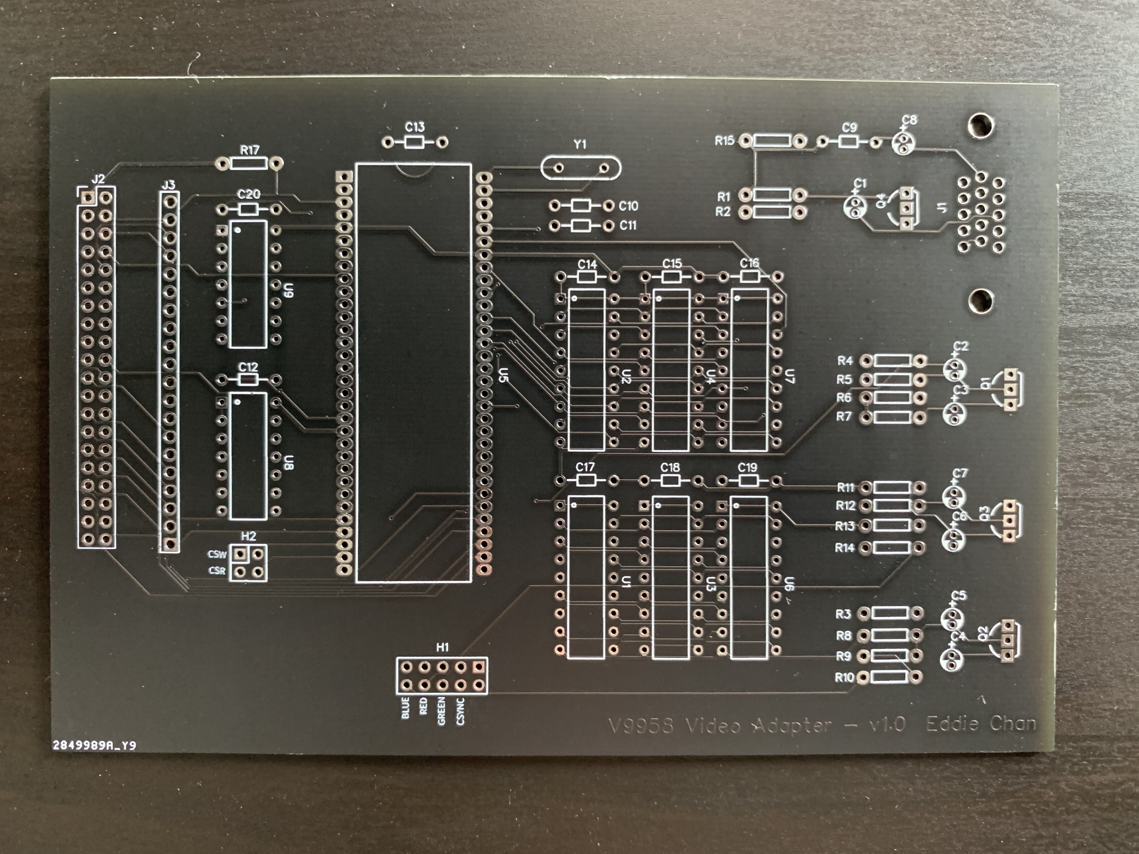

Posts: 45
First prototype of Video Adapter PCB. Will see how many mistakes when it comes back from JLPCB.

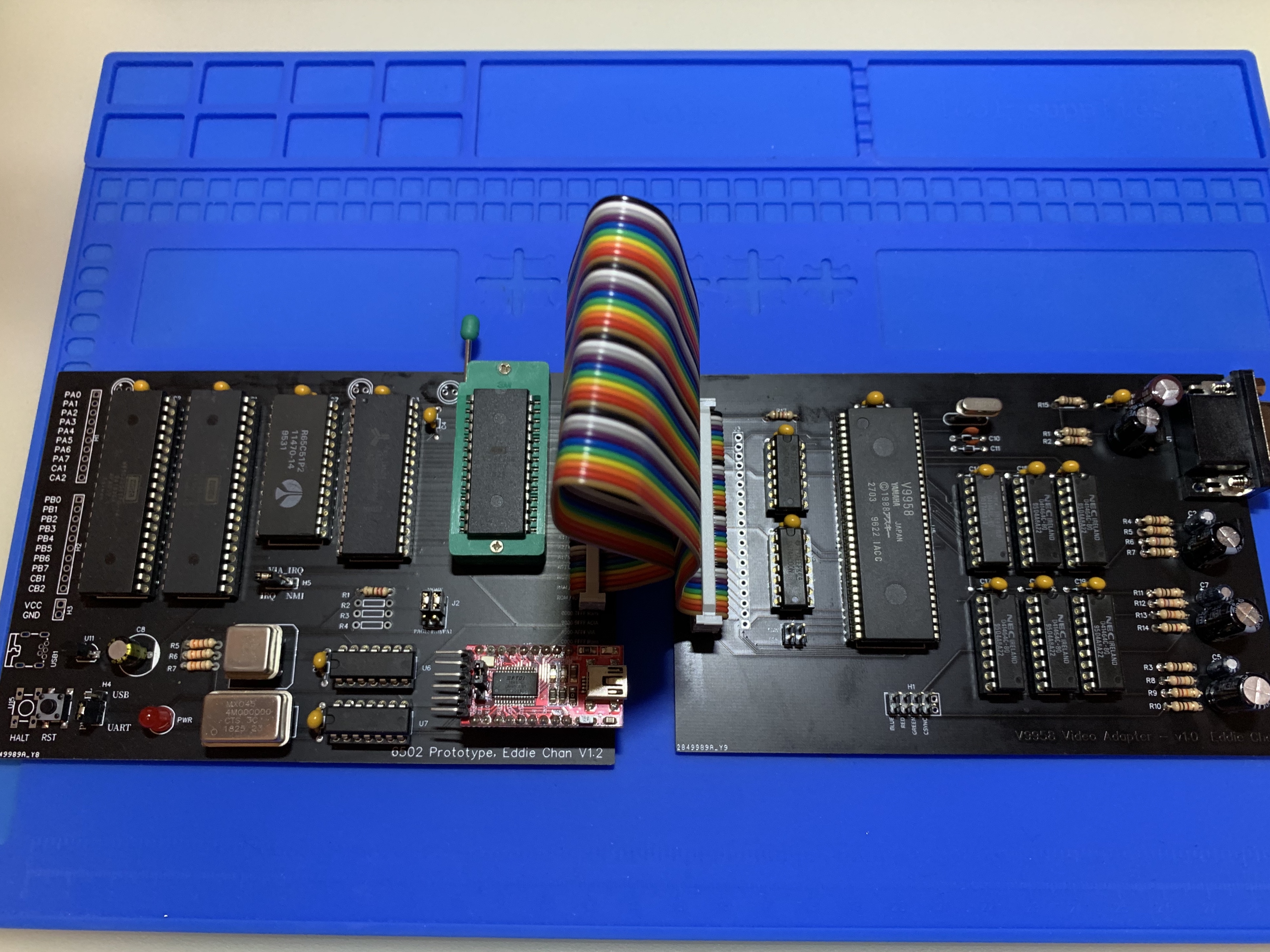

PostPosted: Sun May 10, 2020 12:07 am

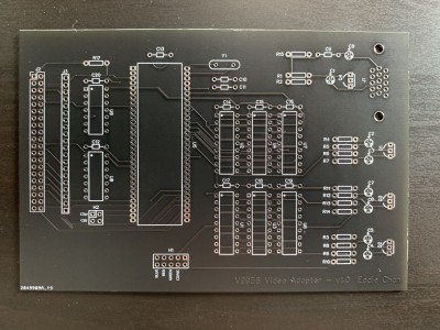

Posts: 45
Quick update: PCB is back from JLCPCB. I've assembled the first and will begin testing.

PostPosted: Mon May 25, 2020 11:40 pm

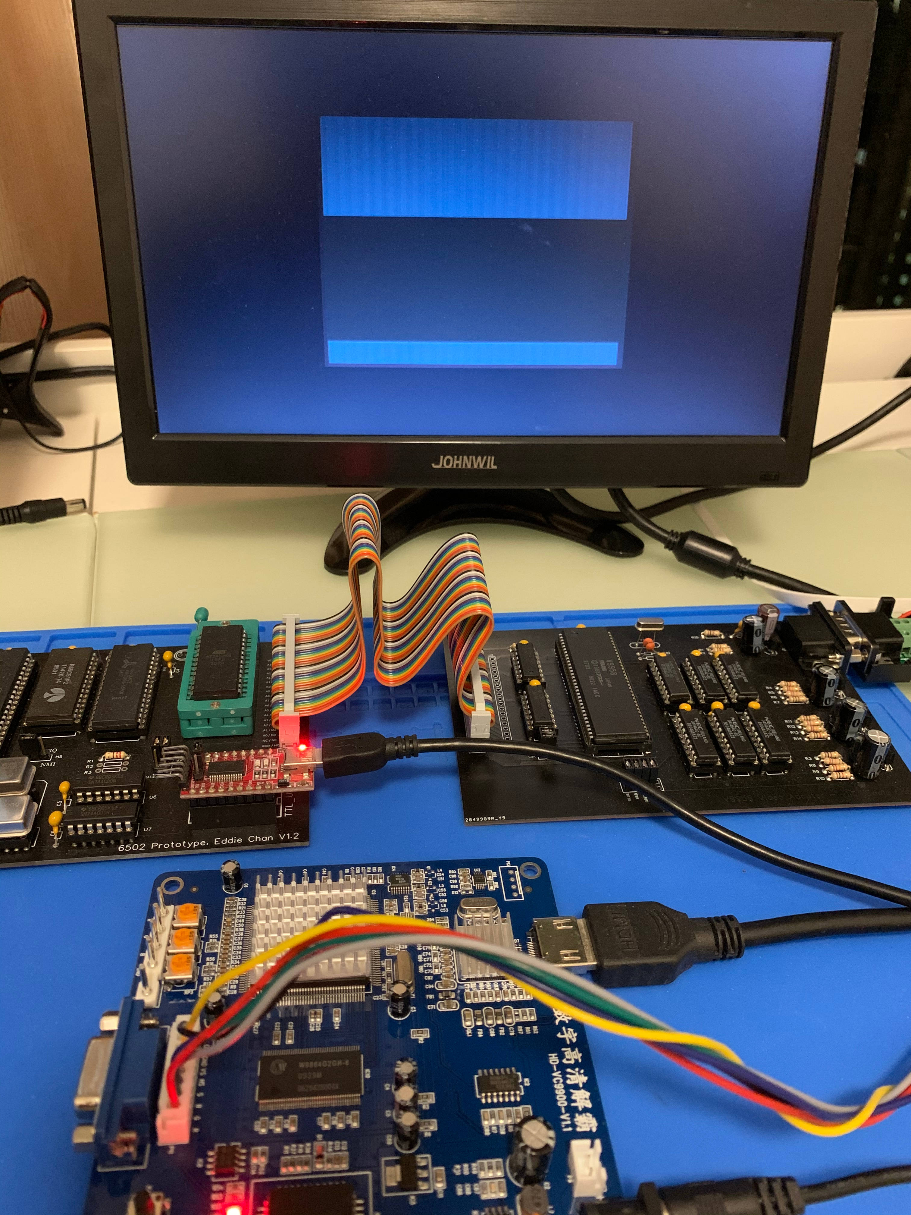

Posts: 45
Making progress on the V9958 video adapter. Got a picture, but it not clear at all. Will need to debug the video circuit to see what's going on.

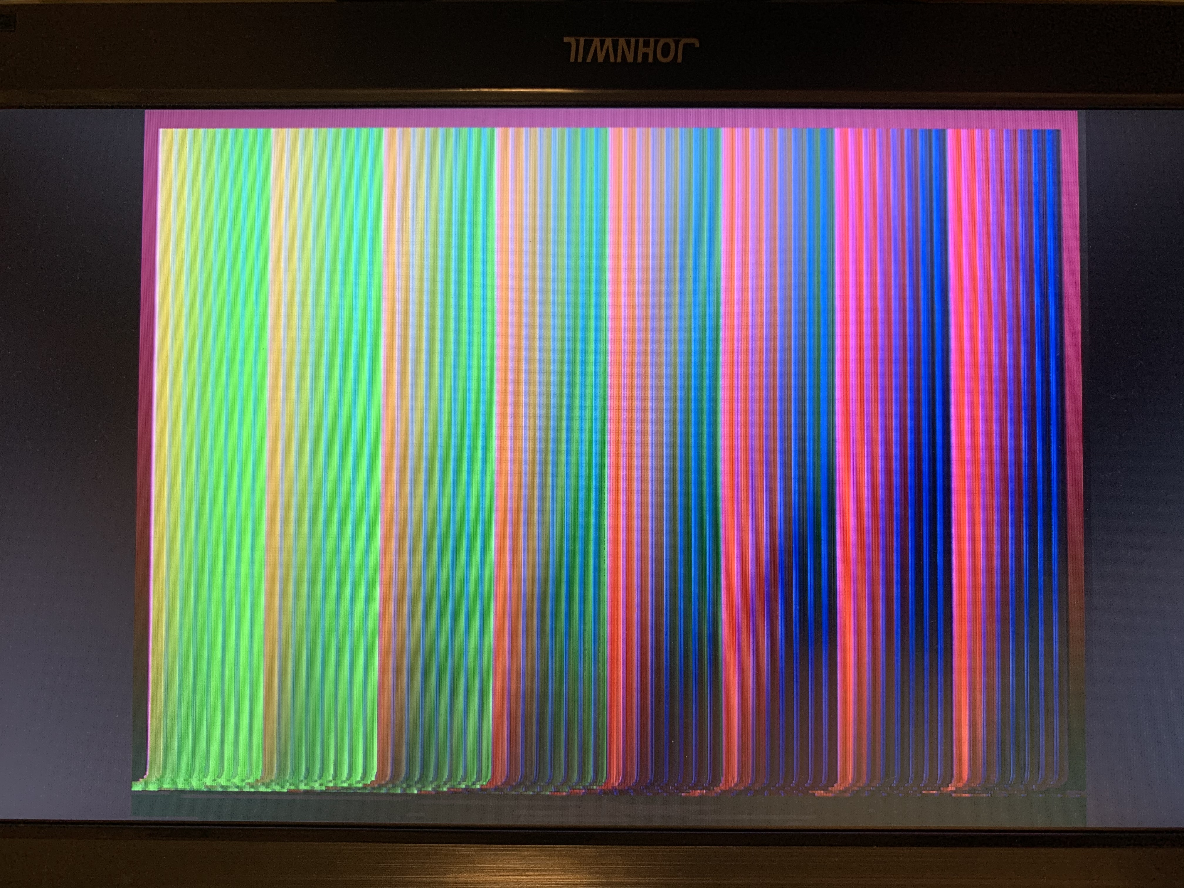

PostPosted: Fri May 29, 2020 12:11 am
Posts: 45
got a better picture after some adjustments on the video encoder board. There's still issue with the sync at the top of the picture.

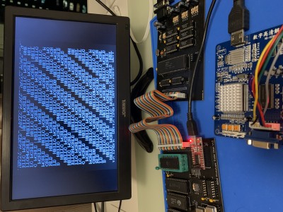

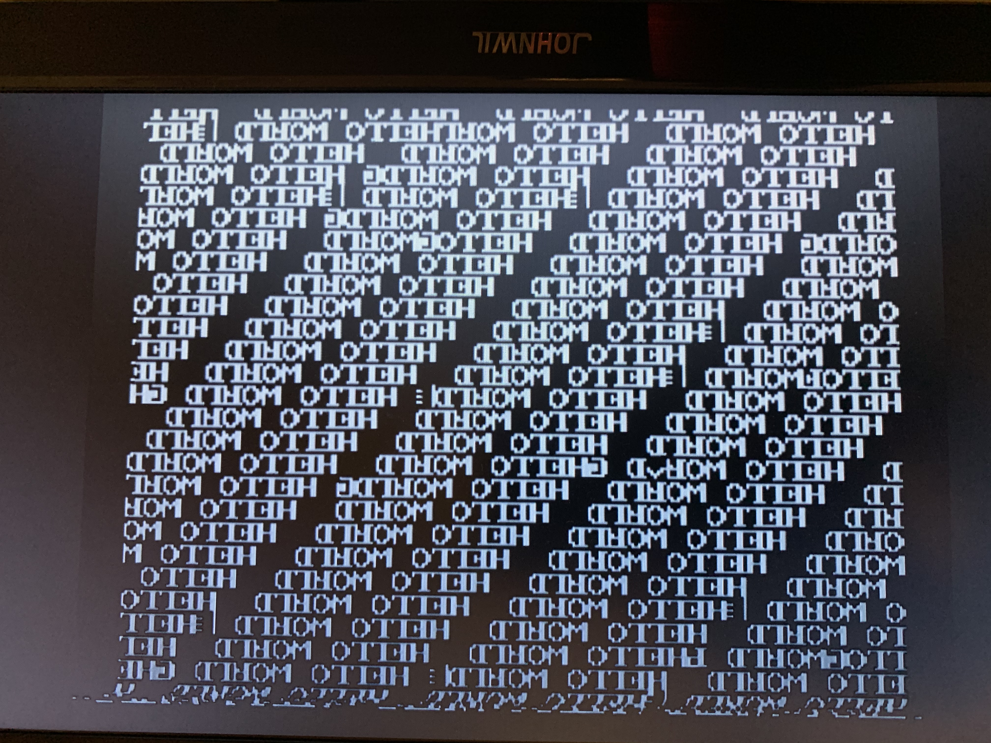

PostPosted: Mon Jun 01, 2020 1:26 am
Posts: 45
Making more progress with "Hello World" in text mode. But looks like there timing issue with some strange chars appearing.

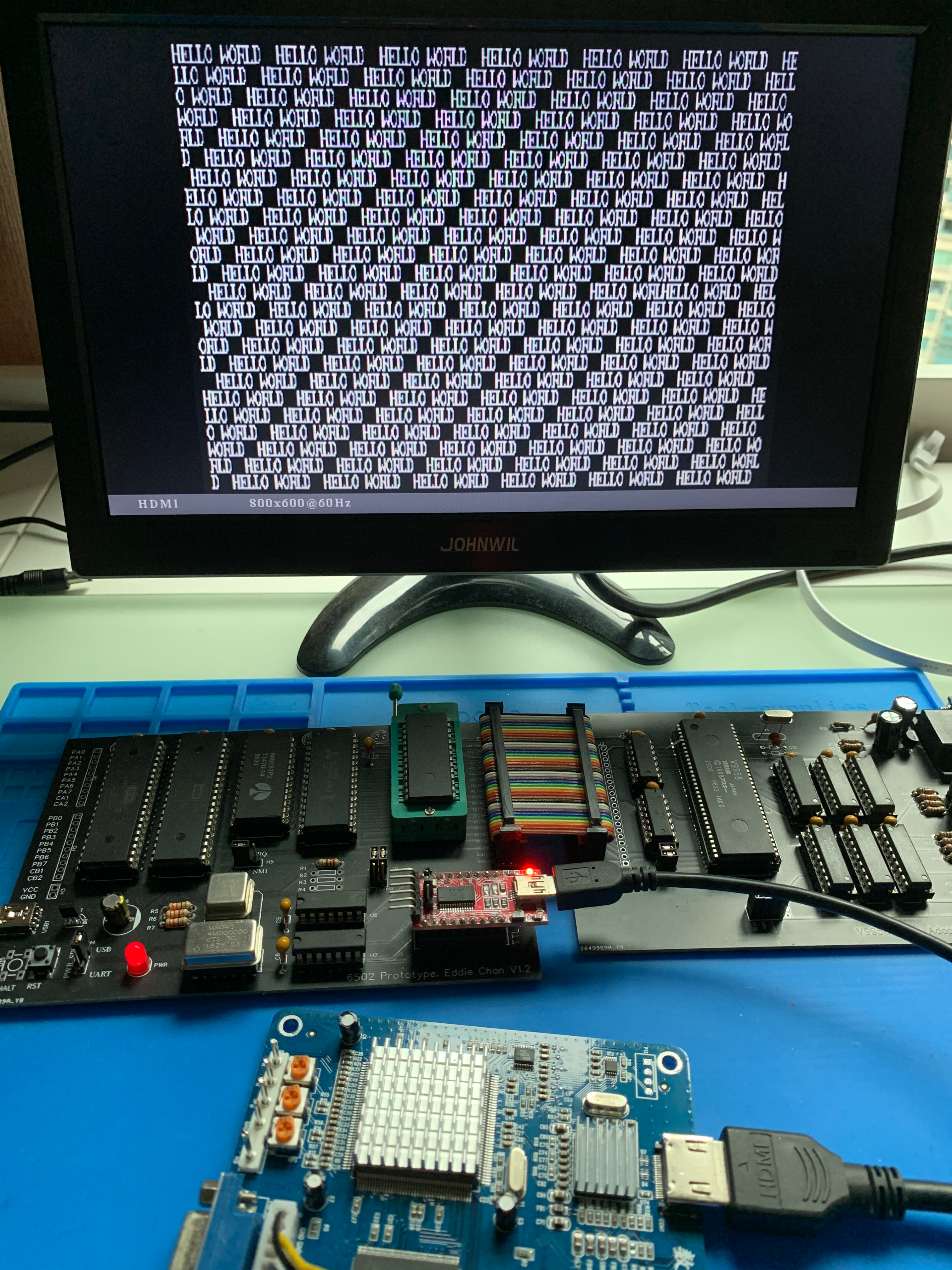

PostPosted: Sun Jun 07, 2020 12:58 am
Posts: 45
80 Columns mode now showing a picture. the screen corruption in the previous post was due to the long ribbon cable connecting the 6502 SBC to the Video Adapter. It now uses a much shorter cable and it appears to fix the issue.

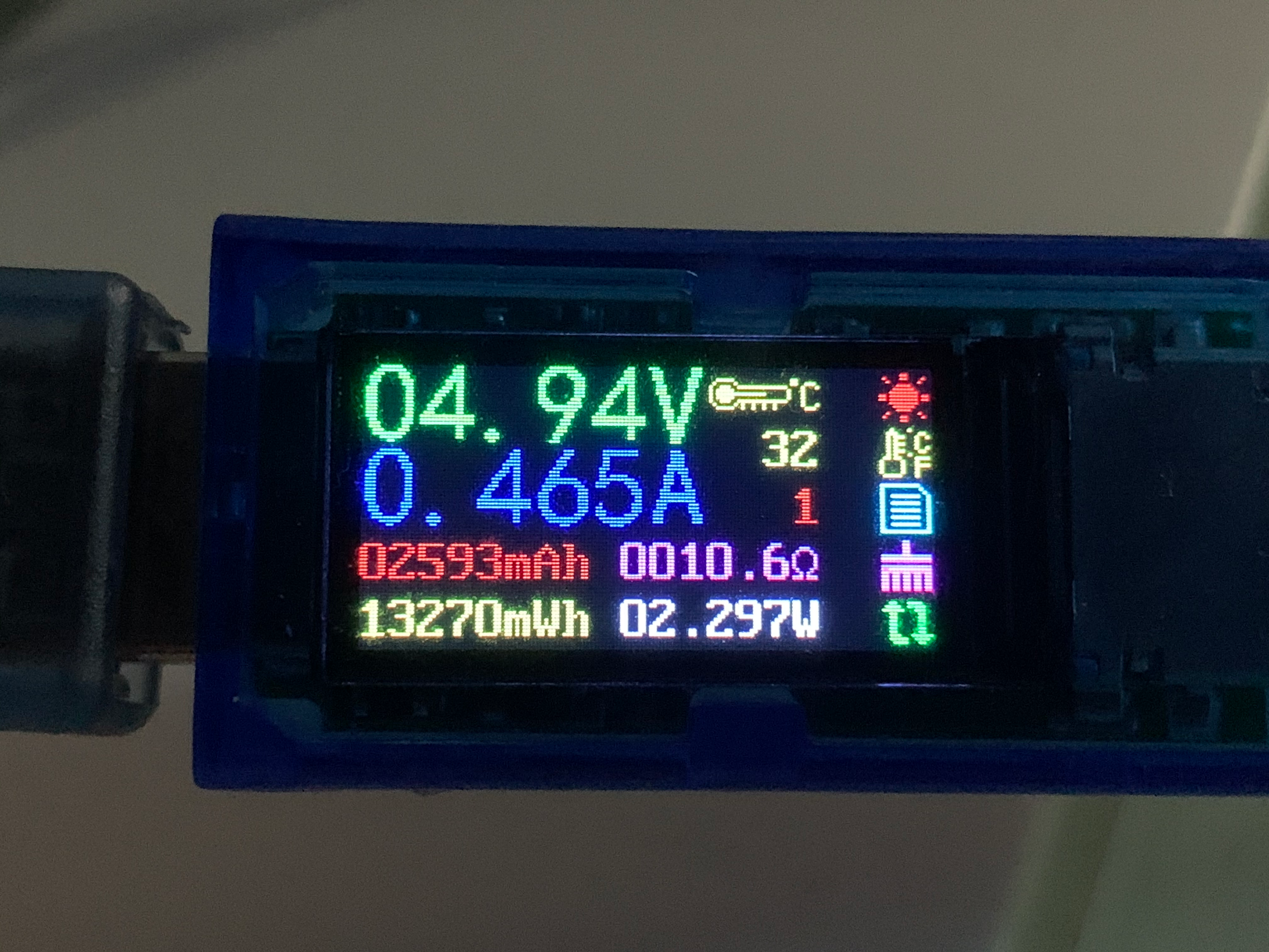

The next task is to get a more stable picture. The picture will sometimes get out of sync and the pixels is not too stable on the screen. My current thinking is that the Voltage is not good on the video signal driving circuit. The whole computer is powered by a USB connection (~4.94V on the input side and drawing 465mA). However the voltage on the video output circuit has dropped to 4.51V. Will need to workout how to fix this.

PostPosted: Sun Jun 07, 2020 6:41 am
Posts: 1488
Use a separate power supply if you can, or double up on 2 USB outlets from your PC. USB(1,2) is not designed for high power and if the PC was doing it properly would only allow 100mA before shutting down the power to the USB socket. (there is a power negotiation protocol - rarely used on most PCs) Clearly your PC, like 99.5% of all PCs and Laptops haven't been fitted with current limiting devices, but it may have a 500mA polyfuse (self resetting thermal fuse) or similar.
If doubling up, it might be worthwhile taking the lid off your PC to make sure there is a separate fuse for each outlet - sometimes there is just one for a bank of 4 USB sockets. Polyfuses are usually green, or easy to tell apart from the usual SMT resistors.
I ran into exactly this issue trying to power the backlight a 20x4 LCD board - it dropped the USB supply voltage down to a level that made the entire board unstable. I fitted a separate 5v PSU for the display and all was fine again.
