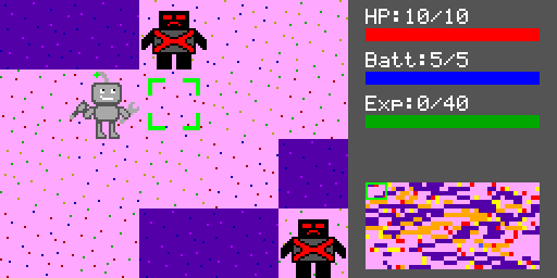

I've been working on porting a game from Python to C, Forth, and assembly to compare each language. The game is simple and only exists to have something to port, so no guarantees about how fun it is. The CC65 and Tali Forth 2 versions are finished. You can try playing them in your browser without downloading anything. The assembly versions will follow soon. Let me know if you find any bugs or differences between the versions please.
Robot Game - CC65 version
Robot Game - Tali Forth 2 version
Keys:
W - up
S - down
A - left
D - right
space - attack/mine/drill
M - open menu

All four versions of the game are done. Here's a summary I did comparing the performance of each language with links to the games so you can play in your browser: Robot Game summary. C was 20-80% as fast as traditional assembly, Forth was 5-25% as fast, and the optimizer project I posted about here was up to 10% faster. Here's a graph of 28 different tasks the game does internally. Traditional/unoptimized assembly is normalized at 100%. Anything above that is faster and anything below is slower, ie a rating of 20% means five times slower than normal assembly.
