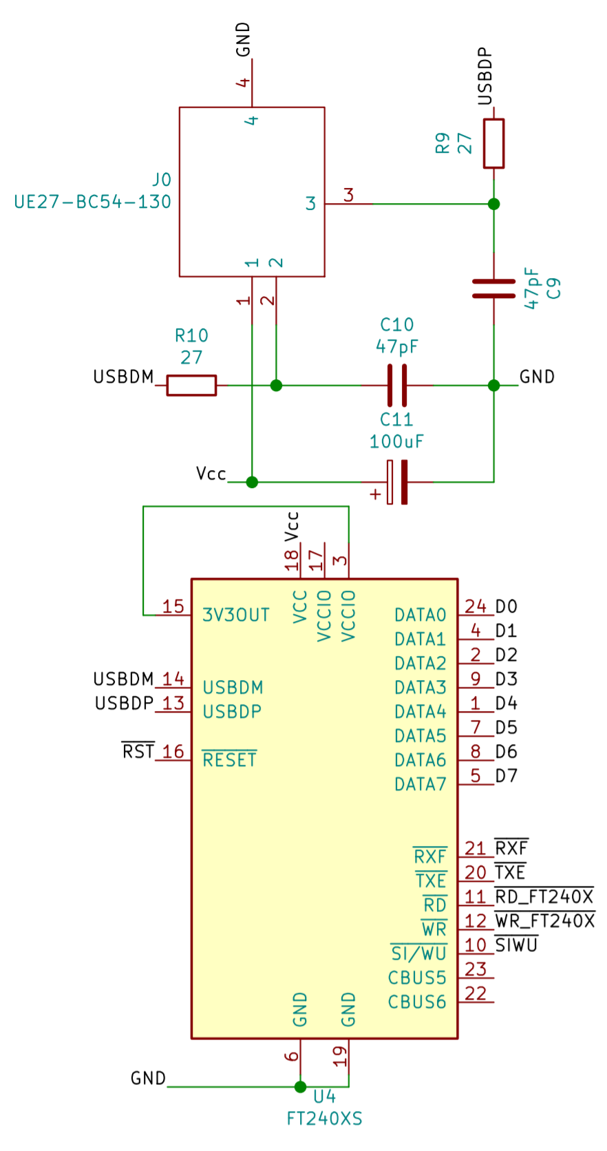

this is a section of my schematic, showing the USB connector (top) and the FT240X (bottom).
pin 15 and 3 are connected to eachother like the datasheet says,
Vcc and GND are connected as well,
USBDP is connected to pin 3 (D+) of the USB Connector, and USBDM is connected to pin 2 (D-) of it.
SI/WU is being held high at all times so that one deos nothing.
the Data lines, RXF/TXE, and RD/WR are completely irrelevant at the time (but i checked the RD/WR pins and they are held high as well)
pin 17 (which is actually VCORE) and CBUS5/6 are also not needed and therefore just left unconnected.
CBUS5/6 are programmable but by default are used to detect if the device is plugged into a host, and to keep the device from putting itself into a stand-by mode when not plugged in.
i did actually use that CBUS5 pin to see if the device even considers itself plugged in. and when plugging it into my PC it pulses High a few times but afterwards stays low. (it's always the same pattern when i un/replug it)
I'm almost tempted to make a new PCB that just has the FT240X, a USB Cnnector, some passives, and a few pin headers on it.
so i can see if that one would work, and that way i could have a functional USB device that i could compare to my currently not working on.

Or just a problem with the design. One thought occurs to me: are you absoutely certain that you have the D+ and D- lines wired correctly? Reversing those would definitely confuse USB interfaces since the polarity of them is what's used to determine the transfer speed.
Yes i'm very sure.
using the image below (USB B, Device) i confirmed that 1 is Vcc, and 4 is GND exactly as shown.
2 is D- and checking with my multimeter is connected to pin 14 of the FT240X, which is USBDM (USB Data Minus)
3 is D+ and checking with my multimeter is connected to pin 13 of the FT240X, which is USBDP (USB Data Plus)
that looks correct to me.

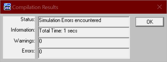

EDIT: can i just say that WinCUPL hates me for no reason? i'm trying to simulate one of my Decoders... but i get this:
it says there are errors, but also says there were 0 errors... and none were listed either.
what even is this program.

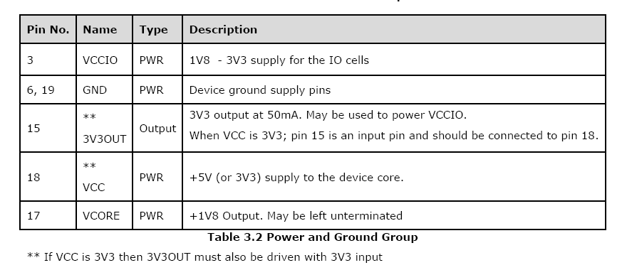

Are you sure you don't need VCORE? That sounds pretty critical to me.
And yeah, WinCUPL is rather infamous for giving wierd errors and generally behaving behaving wierdly. I think it's mostly the GUI that's the problem, probably because it's so old. The command-line utilities it backs onto worked more or less fine in the build script I ended up using.
I agree it sounds critical. Surprisingly, it may be "left unterminated."
"Synchronous and asynchronous bit bang interface options." Interesting product! Datasheet attached. But I barely skimmed it.
Among other things, it does mention "storing device descriptors and FIFO I/O configuration." Sounds like there could be potential for a show-stopper there...
FT240X USB fifo.pdf
(952.67 KiB) Downloaded 75 times
Yes as the datasheet says it's a 1.8V output. there is nothing on the chip that requires 1.8V, and if you check the example circuits below it doesn't even show VCORE anywhere.
problem is that in order to program the chip you need to use FTDI's software for it... which as you might guess connects via USB. so if the Chip is not connecting it cannot be programmed.
if you look into the datasheet (section 8.1) it mentions the default values that are pre-programmed into it.
Yea, it's Win95 software... it even has an MS-DOS button.
i wish someone would rewrite it for a modern OS and just fix all the issues with it.

This atleast confirms that the Computer itself seems completely functional, just the USB interface is busted.
This test program also made me notice that i accentically switched the INC A and DEC A OPcodes. because i was really confused why it was decrementing at first until i looked up the OPcode and realized it was wrong in my Assembler.

i'm still kinda set on the idea of redoing part of the board to remove the USB chip, and have a connector that my UM245R Module can plug into instead.
then also design a PCB that has the same exact pinout of the UM245R but with my own design and different USB Chip.
that way i can test the computer with the module i know already works, and compare it to the one i made myself.
plus if it works i basically got 2 of those modules for testing, which would be great as one of these costs like 20 bucks.
