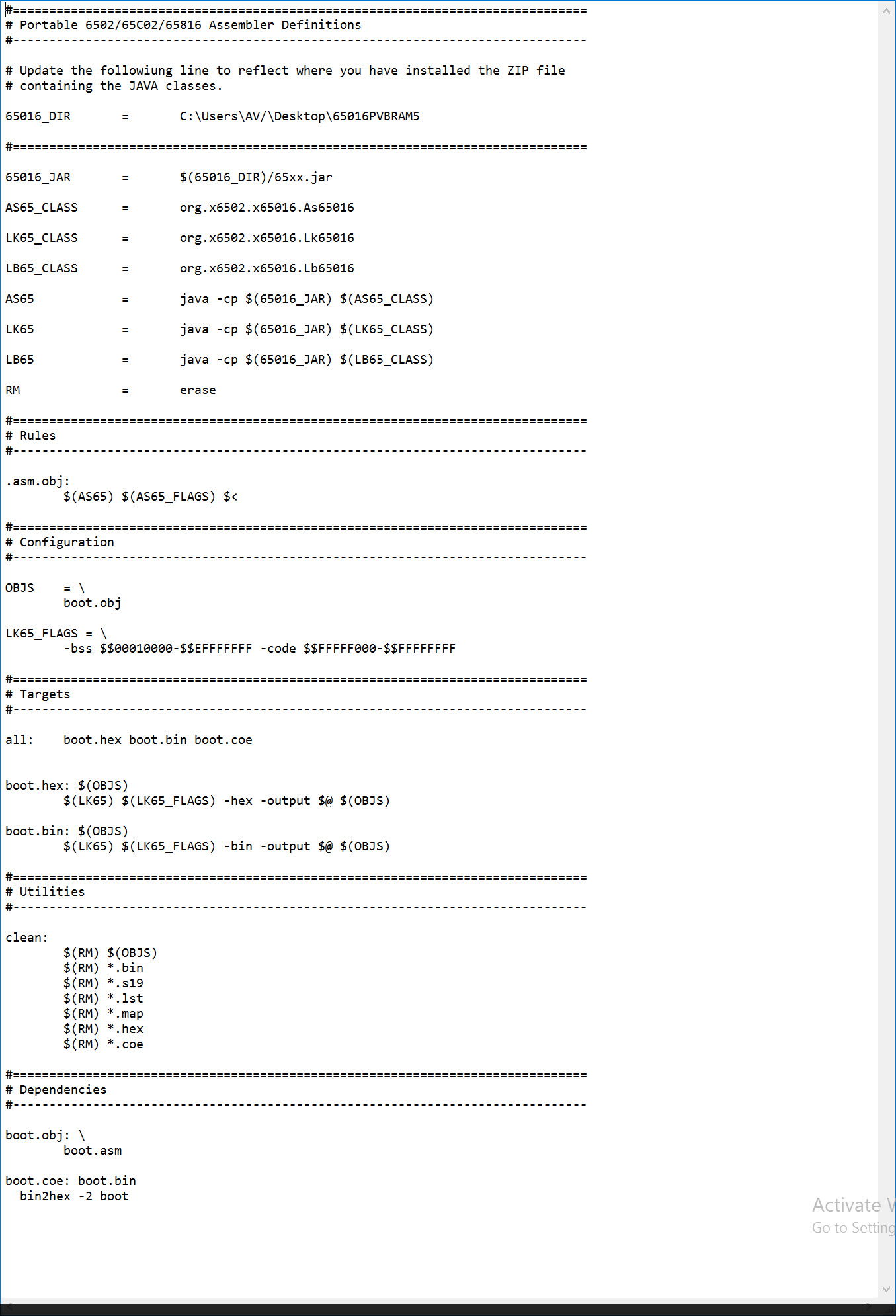

The makefile, yes! I see it now. I remember having to modify it slightly. I got it working! Thanks Bitwise!
Here's the files I have in that folder and how I modified the makefile. Running NMAKE automatically generates the .coe file needed by ISE from the boot.asm file, which is just a text file including all the macros for the new opcodes, and also the software. I really need to add this to Github. Also, credit to Arlet for making the bin2hex and bin2coe.
EDIT: I've added 65xx.jar, bin2coe, bin2hex, Makefile & NMAKE to Github.

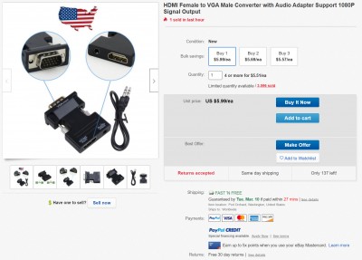

Woops, up I ordered the incorrect type. The correct one is like cjs posted above with the 5V USB connection on the side of the converter. Mental flatulence as Dr. Jeff said. :lol: :lol:
It's nice to have a HDMI to VGA converter tho. Gets my mental gears spinning...
Here's the one I ordered. The seller is located in NC so hopefully it'll get here quicker. Reading the reviews makes it clear the 5V power from the USB must be plugged in for it to work.
