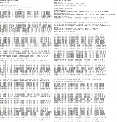

Anyway, I believe I'm done with the Master Spartan 6 constraints file. The Xilinx ISE tool needs to identify clock inputs which is especially important, and then the names you choose to give the rest of the I/O pins. I've not named most of the address pins and all the data pins that go to the top 2 SyncRAMs. The reason is that I'm sorta of curious for an early experiment, if it actually matters, for resource usage or top speed, which I seriously doubt. I've found the Xilinx tools fully capable in something like this, but you never know. Maybe someone can chime in on this?
Tomorrow, onto the Slave Spartan 6 constraints file. I personally use the constraints file, which is necessary for ISE to compile the project, to double check the pin connections. I don't use schematics for large pin IC's, it's a waste of time IMO... Anyway, cheers!

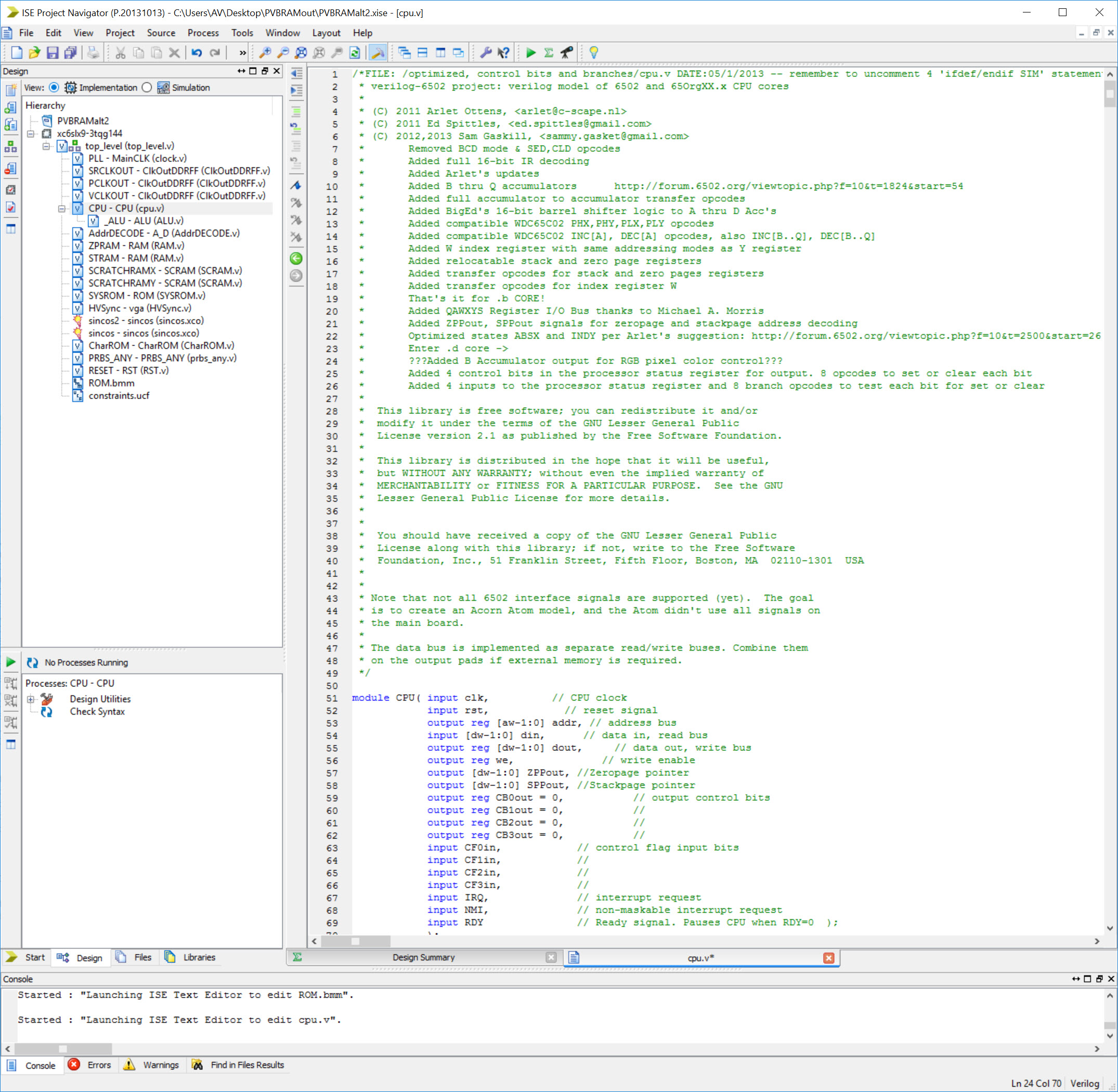

So now it's time to finally focus on the Verilog. I think the strategy I'm going to use is the program the Slave Spartan 6 first and have it output RGB data read from the SyncRAM to the videoDAC. I have a project file already completed that I'd used for the later stages of the PVB project. It uses a 65Org16.d core running @74Mhz, 1/2 the video speed. The .d core has a couple more features I added and had not updated the Github in my sig below. You can see the extra features in the notes above the cpu.v pic I took below. I really got deep and it will take time to re-familiarize myself with the Verilog but I don't foresee any problems. Let me just give credit to those who had helped me get to this stage: Arlet Ottens, BigEd & Michael Morris. I seriously would have not even started the PVB project if I thought I was not going to get help. After experimenting with Arlet's core for a couple years, I learned how to do state machines which perform different functions, cycle by cycle. Very powerful stuff and sorta difficult to wrap my brain around it all the first time around. This time should be even better I'm hoping!
Another thing I realized is my block diagram is incorrect, I'll have to make a new one. The Master Spartan 6 controls ALL the I/O. I think at one point I had tried to fit the USB controller Tx & Rx into the bottom S6 but there were no pins left. I was hoping to at least have keyboard input for some sort of control without having both FPGAs... I won't be able to reprogram the Si514 which isn't a big deal. I'll just have to use the 40MHz coming from it and have the Slave S6 do its magic and generate the 148.5 MHz pixel clock. The Si514 I2C programming will be done by the Master S6 when the time comes. I'll attempt to make a state machine for that as well.
In the 1st pic, you can see the project file, which I'll go into in the following post. You can see the PLL, which is a very powerful feature of the S6. I believe it has 2 of these for the 144-pin version I'm using, IIRC.

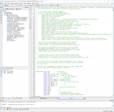

The 2nd pic shows credits and features of the 65Org16.d core. 16 16-bit Accumulators, 2 index registers Y & W and based off the 6502 and able to run @least 74MHz with this project 'in tow'. Yummy

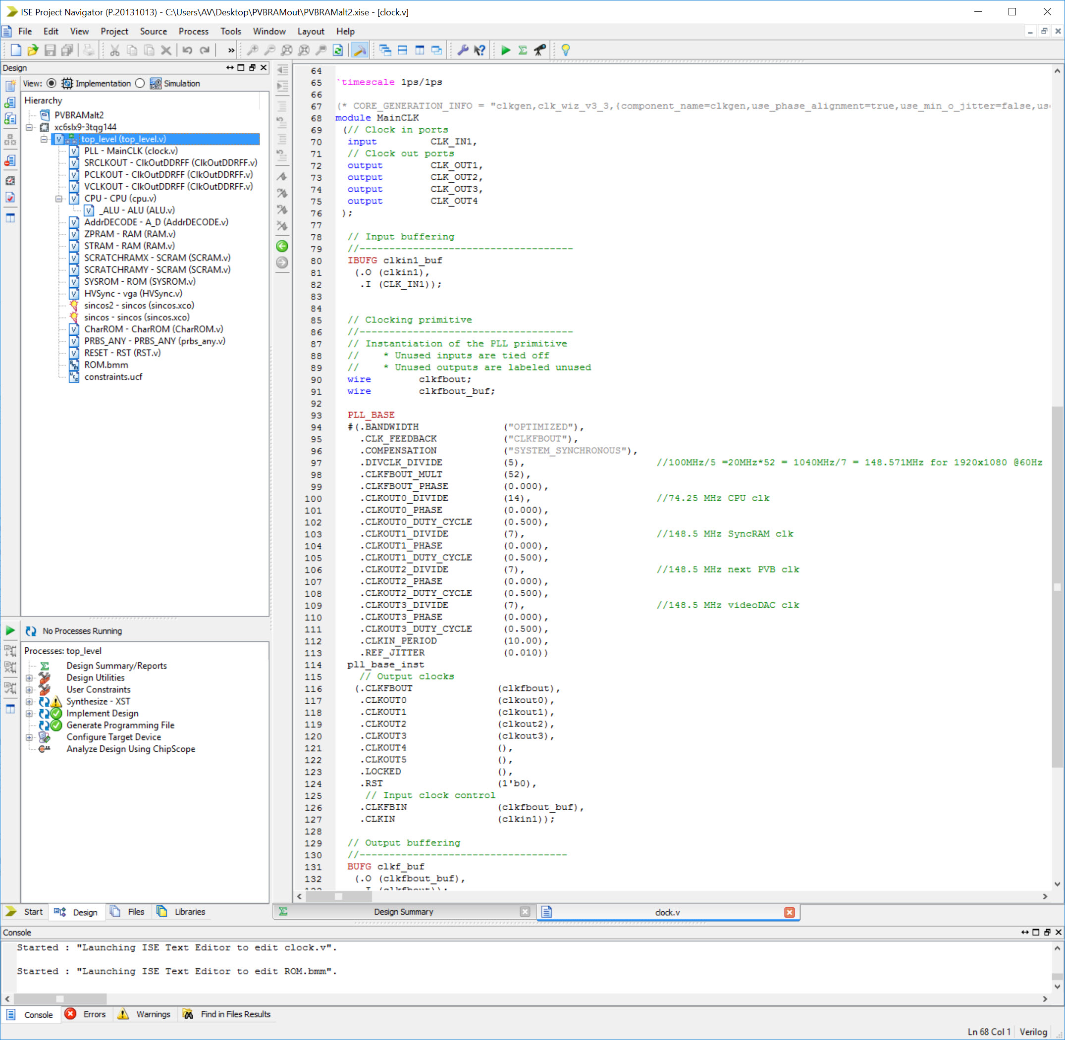

PostPosted: Tue Feb 18, 2020 10:16 pm
In this project, going top to bottom on the left hand, I had:
1) A PLL generate 3 separate 148.5 MHz signals for off FPGA use and the internal 65Org16 74.25MHz signal.
2) SRCLKOUT, PCLKOUT & VCLKOUT were the buffered 148.5MHz going to the SyncRAM, videoDAC and the next PVB pixelCLK.
3) cpu.v & ALU.v is the 65Org16.d
4) AddrDECODE is for the FPGA internal block RAM used for Zero Page and the STack.
5,6) ZPRAM & STRAM are 1Kx16 each for internal FPGA block RAM.
7,8) SCRATCHRAMX & SCRATCHRAMY. 16Kx16 ea for reference points for video plotting.
9) SYSROM is 4Kx16 of FPGA internal block RAM used for the operating SYStem.
10) HVSync is a highly modified video generator originally made by Arlet.
11,12) sincos2 & sincos are generated by Xilinx tools and the waveforms are stored in the SCRATCHRAMX & SCRATCHRAMY for on the fly reference points for plotting.
13) CharROM was a 1Kx16 FPGA internal block RAM for IBM and C-64 character data.
14) PRBS_ANY is a pseudo-random number generator.
15) RESET is an outside signal that is delayed internally by 64 cycles.
16) ROM is the OS. 4Kx16
17) constraint.ucf is similar to what I've been working on for the past couple days.
I can't believe it's been 6 years!!!

PostPosted: Wed Feb 19, 2020 9:47 pm
The last couple posts I intended to give examples only, the real project file(s) for the Slave & Master will start out much, much simpler. Today I finished the Slave S6 constraints file and most of the Master S6. I say most of the Master S6 constraints because there are about 10 pins that are connected to free/unused vias that are meant for ICs which are not soldered to the board yet.
As mentioned before, ALL the Slave S6 pins are used for FPGA-FPGA Communications, RGB-out from Master to RGB-in to Slave and SyncRAM address/data/control pins.
To finish off today, I'll start trimming the project file for the Slave S6 and adjust the settings for the PLL clock generator for generating 148.5Mhz from 40MHz.
