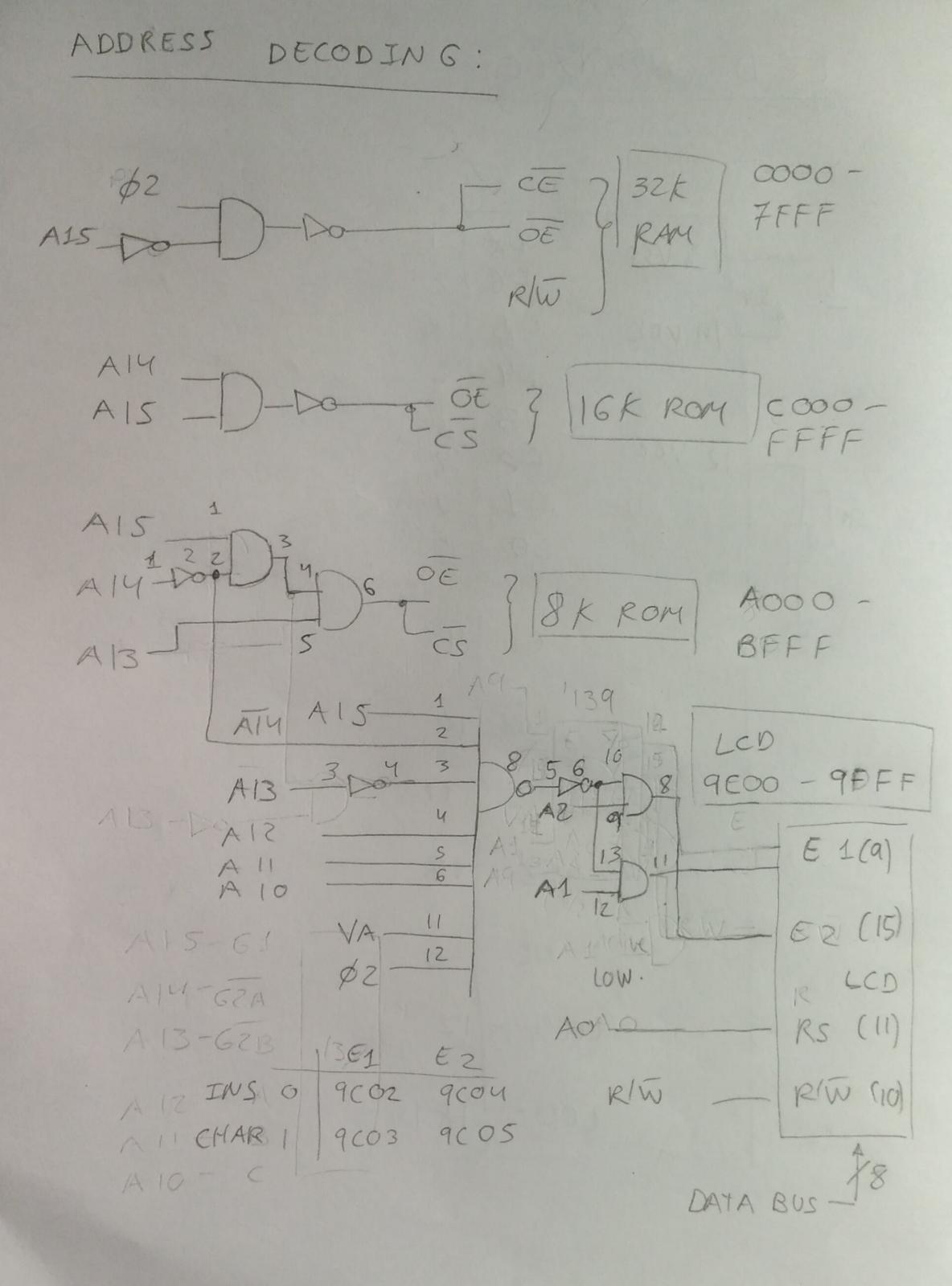

Regarding address decoding, this is what I'm thinking:
-32K RAM 0000-7FFF.
-I/O 8000-9FFF. LCD at 9E00-9FFF, see attached.
-8K "Cartridge" ROM A000-BFFF (32K ROM, 8K selectable with dip switches).
-16K ROM C000-FFFF.
There are always three or less gate delays, and I could easily relocate the LCD with spare inverters. There is also 1/2 of a 74HC139 available for anything else that may go on the top card. VA is the hypothetical "valid address" pin.
Further address decoding will be on other cards, next to the relevant I/O, independent from the first card.
Any suggestions are welcome. Pardon the crudity of the schematic.
EDIT: 74HC139 has active-low outputs, and the LCD has active high. So using two AND gates resulted in less complexity. Now the LCD spans from $9C00 to 9FFF. Updated the schematic. I've built it up and works perfectly.
The empty ZIF socket and the dip switches are placeholders for now. I'll add the extra ROM later, or remove it altogether.

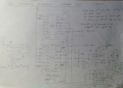

This is a simple PS/2 interface I've designed. Down to four additional ICs, some passives and a transistor, which is just enough to fill the space left on the memory card. One could repace the 555 timers with gates (B), as they are being used as a Schmitt trigger and RS latch respectively. I've tried it out on a breadboard and seems to work fine.
Each time a frame is received from the keyboard, an interrupt is triggered. When the key code is read from the appropriate address, the interrupt line is released. Not checking parity, as that would add additional complexity.
Juan
A 74HC123 may be more appropriate than 555's or gates, and would probably eliminate the R-C network and diode-R-C network shown in your diagram. But it's understandable if you prefer to stick with the circuit you've already gotten working.
Unlike the 'HC221, the 'HC123 is "retriggerable." Once triggered, the output pulse width may be extended by retriggering the inputs.
http://www.ti.com/lit/ds/symlink/cd74hc123.pdf
ETA: it seems odd that two shift-registers would be required. Might you be able to manage with just one?
I don't have any 'HC123s at hand (I didn't even know about them). But I will add them to the list so I get some on my next big order.
I'm not too keen on relying on RC networks for timing, but I think the margins here are somehow broad, so it should be ok.
Regarding the shift registers, a PS/2 data frame has 11 bits: Start, 8 x Data, Parity and Stop. So to get only the 8 bit data, I would have to prevent the last two bits from shifting in. I've thought about latching a single '595 after nine clock pulses, but that would require something like a counter and some gates. So chaining an additional shift register seemed the simplest approach to me. I can just connect to the data bus the bits I need. I'll be happy to find out about alternative solutions though.
Juan

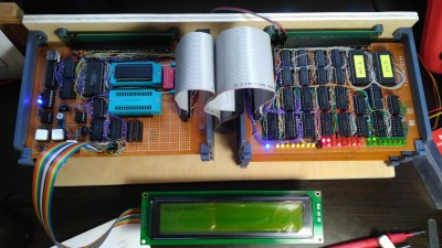

I've built the keyboard interface on the top card and seems to work as expected. Interrupts themselves are not working perfectly, particularly at higher clock speeds, I also have to change the microcode for RTI (I forgot to re-enable interrupts here). I'll have to take a further look at it.
Just noticed that in case I connect more devices to the IRQ line, I have no way of knowing whether if the keyboard caused the interrupt or it was something else. I'll see if I can devise a way of clearing the registers after they have been read, or maybe enable another memory location to display if the keyboard is waiting to be serviced... But that would require additional hardware for which I barely have room for.
I may take out the additional ZIF socket for a future "cartridge rom" and put some and gates and a 'HC245 bus transceiver, which would do.
I could also check all other hypothetical future devices first, and if none of them were, then it's the keyboard, but it doesn't seem right.
