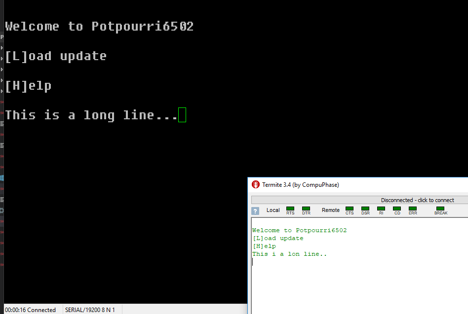

OK, I finally got my board working again. I'm embarrassed to admit how long it took due to a stupid coding error on my part.
Anyway, I have built a small daughter card for my SBC that uses the infamous 65C51 (confirmed bug).
I started noticing it was dropping characters so I did a little research and found some code on here that puts a delay into the transmit method.
It works...mostly.
I'd say it went from 60% working to 85%.
Typing "this is a long line" yields something like "this isa lng line". Close, but no cigar.
So, my question is, should I just keep tweaking with the delay routine until I get it right or is there a bullet proof method already known by everyone?
FWIW, my machine is currently running at 1 MHz. (I took it down from 4 MHz until the dust settles).

PostPosted: Thu Feb 14, 2019 3:44 am
Does increasing the delay, say to $80 loaded in X, correct the problem?
A more reliable timing method would be to use a hardware timer, such as half of a 6522, and drive it from some division of the UART's master oscillator. This would also obviate the need to waste time in a loop after sending every character; instead you wait *before* sending until you observe the timer has expired, and reset the timer immediately after sending. You'd need to set the timer up during UART initialisation, so that you don't get stuck before sending the first byte.
Ooh - I just noticed you're running with polled receive, rather than interrupt. So you may be missing characters due to receive overrun rather than transmit corruption, if they're coming in a burst from your host machine. The 6551 doesn't have hardware control of CTS by receive status (probably because it doesn't have a FIFO, only a buffer register). I think you said you don't have the RTS/CTS lines connected anyway, otherwise I'd suggest negating CTS while sat in the timing loop. Using a hardware timer as suggested above would allow you to pick up the receive data sooner - but you should also implement a buffer in software, and at least consider servicing the UART on interrupt (receive on UART interrupt, transmit on timer interrupt).

PostPosted: Thu Feb 14, 2019 4:04 am
I added another potential cause to my post above; that would fit with increased delay *not* solving the problem.

PostPosted: Thu Feb 14, 2019 4:19 am
I think this problem is specific to the "echo" test he's trying to run. In that *specific* case, any delay long enough to reliably avoid corrupting the stop-bit on the transmit side will be too long to avoid gradually falling behind a continuous train of receive-side traffic.
A test for this might be to eliminate the delay loop and instead set the host to transmit at 8N2 instead of 8N1. Leave the host receive and all the 6551's configuration at 8N1. You'll then get receive characters at 11-symbol intervals while being able to send them at 10-symbol intervals.
PostPosted: Sat Feb 16, 2019 12:06 am
Posts: 1250
OK, I think some good news.
I may have been experiencing some issues with the Windows terminal program I was using (Termite).
I switched to ExtraPutty and I can't get it to break.
I'm going to keep testing to make sure it isn't some fluke but, if it's working, then I can start my mini-monitor to grab data from my host PC and move to RAM.
Got a long weekend to boot. Fun fun. :-)
Thanks to all of those that helped.

PostPosted: Sat Feb 16, 2019 12:08 am
Are you able to generate data on the SBC and print that at full speed now?
PostPosted: Sat Feb 16, 2019 12:16 am
Posts: 1250
I believe so. In fact, I generated this welcome message:
Bacon ipsum dolor amet biltong corned beef ham hock, drumstick turkey cupim rump kielbasa sausage turducken. Filet mignon capicola picanha, kielbasa chicken meatball rump shank. Corned beef pork belly pork chop chuck, landjaeger buffalo tenderloin. Ribeye
Which is 256 bytes. Then, I copied the messaged echoed to my terminal and compared the string. Every byte was there.
**EDIT**
Hmm. I may have spoke too soon. Typing on the keyboard seems to work fine. But when I paste text (which the terminal simulates rapidly typing), it is all wonky. I'm hoping it's just because the terminal pastes at faster than 19.2. But I cannot confirm at the moment.
