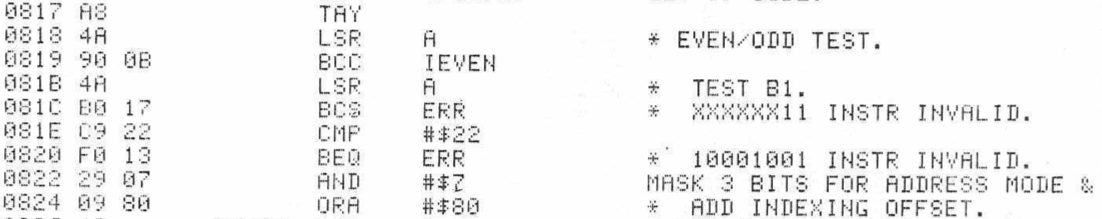

I started to transcribe your work. There's nice material in there for code archaeologists. For example, this snippet which you faithfully glued together from two scattered pieces on the Gayler tape:
3CDB:A8       \   TAY            ;
3CDC:4A       \   LSR            ; EVEN/ODD TEST
3CDD:90 0B    \   BCC   IEVEN    ;
3CDF:4A       \   LSR            ; BIT 1 TEST
3CE0:09 80    \   ORA   #$80     ;   (BECAUSE ROR BUG)
3CE2:B0 15    \   BCS   INVLD    ; XXXXXX11 INVALID OP
3CE4:C9 A2    \   CMP   #$A2     ;
3CE6:F0 11    \   BEQ   INVLD    ; OPCODE $89 INVALID
3CE8:29 87    \   AND   #$87     ; MASK BITS
Compare that to how it appeared in DrDobbs:
barrym95838
Posts: 2056
Joined: 30 Jun 2013
Re: Looking for Baum's tiny assembler on Apple-1
Post by barrym95838 »
I think I know what happened there. Woz had a sharp eye for size optimization, and Apple ][s no longer had to avoid the ROR bug, so he modified the earlier DrDobbs code to eliminate the ORA #$80 and save two bytes in the Apple ][ monitor. Back-porting the ROR code to the Apple 1 required putting the ORA #$80 back in, but it ended up in a slightly different spot.

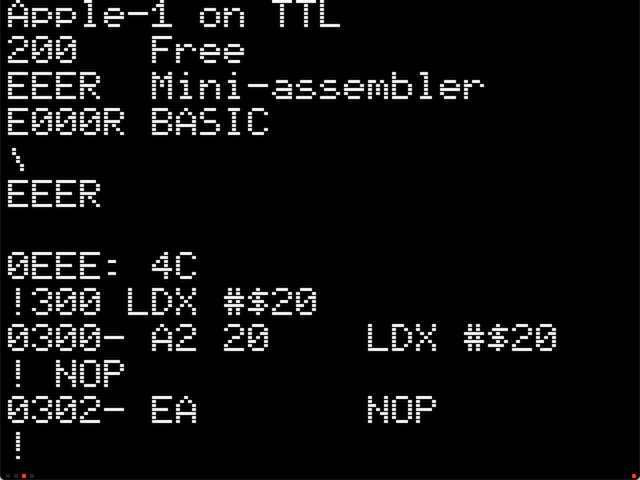

I transcribed it to the Gigatron and for as far as I can see, it works now.
There are some small mods I messaged you about. And there are some small open issues mentioned in the comments. Mine is now a mix between the DrDobbs version and your work. More things are slightly different. Most notably the nibble order in some of the tables. Luckily the assembler doesn't access those directly.
This version won't run on a real Apple-1 (yet), because I don't have good-enough $D010/$D011 emulation. So for input it calls a Gigatron-specific routine. But I do have some ideas on how to restore compatibility.
https://github.com/kervinck/gigatron-ro ... 8e9b25b0f3
mvk
Posts: 81
Joined: 21 Mar 2017
Post by mvk »
I now settled on $EEE as the mini-assembler's entry address. I mapped the code from $C8A..$FDD to do this, and moved the PCADJ routine to free up this nice address without creating a gap.
So the whole package is just 852 bytes, fantastic!
I also added software-based PIA chip emulation. The Gigatron kernel now has a vertical blank interrupt that can be used to emulate the PIA chip. The interrupt capability was added with this "application" in mind :-). PIA emulation isn't 100.00% accurate, but good enough to fool most A1 programs. You can read and write to KBD/KBDCR/DSP and (almost) get what you would expect.
[Edit: typo TIA -> PIA]
