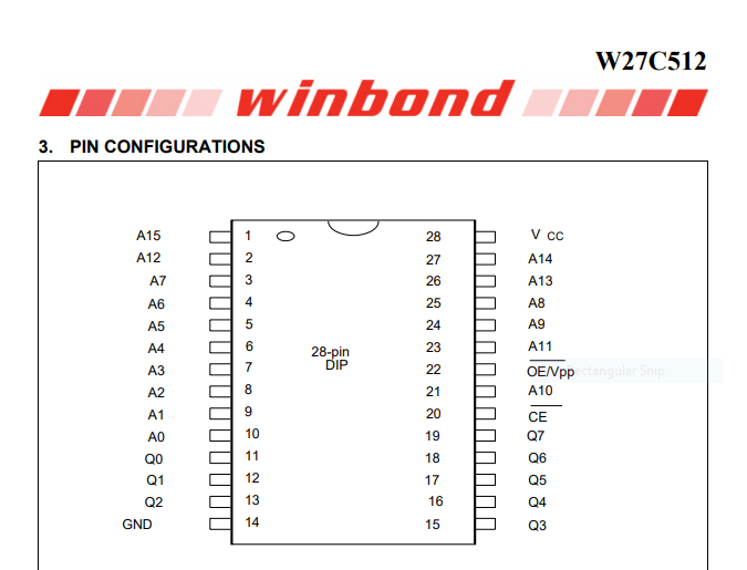

Now that I have tested my 6502 and having a basic knowledge of what's going on, I want to start adding some memory. I would like start with a ROM(EEPROM) for now coz' I don't have any RAM yet. I have a Winbond W27c512 EEPROM that i would like to start with. So the address pins of the W27c512 (A0..A15) goes to the address bus pins of the 6502 and the same with the data pins, correct? What about the OE and CE? I'm guesing they should held low? If so, why?
So while I experiment with just a ROM I would like to know any recommended RAM I should buy? 16k or 32k I guess.
The 6502 datasheet says it can address a total of 65k of memory which I don't understand quite well yet. When it says 65k memory, does it mean 65k for just ROM and I can add say a 16k or 32K RAM too? Or a total for both like for example 32k ROM + 32k RAM? Or 32k ROM + 16k RAM + other inputs = 65k?
The 27's are EPROM. 28's are EEPROMs.
They have to be low to output data; but if you hold them low all the time, nothing else will be able to put data on the bus without bus contention. You don't want that. Again, see the 6502 primer, particularly the address-decoding page (and the first diagram since you're interested in 32KB of ROM) and the whole-computer circuit at the top of the circuit potpourri page.
Data lines will be connected straight across. It's mostly the same story with the address lines, except that A15 will have nowhere to go on the ROM, since a 32KB ROM only has 15, not 16, address lines. A15 will be used to select the ROM. See the diagram at the top of the circuit potpourri page. When you get to the SRAM, address lines can be scrambled, and data lines can be scrambled, if it makes routing a PC board easier.
65,536 (64K) locations altogether, including RAM, ROM, and I/O; so if you have 32KB of ROM and 16KB of RAM, that leaves 16KB for I/O—not that you need that much for I/O but it makes the address decoding really simple and nothing has more than two gate delays. The diagrams linked above give a very simple way to get 32KB of ROM, 16KB of RAM, and up to ten I/O ICs, using only a single quad NAND gate for glue.
