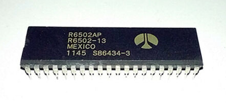

I have an old Rockwell chip with label "R6502-13" that i'd like to do the "Free Run" test. I'm guessing it's an NMOS chip?

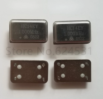

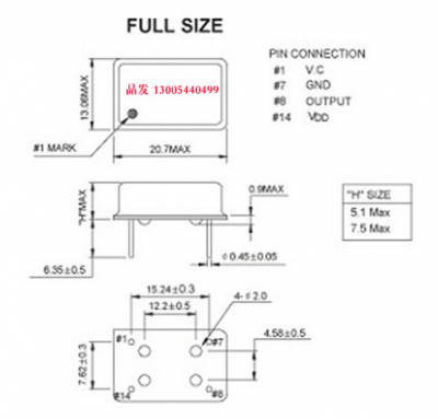

I've read the 6502 Primer: Clock Generation but I do not have the parts yet as mentioned for the NMOS chip. What I have is this 4pin crystal. Will this work?

Yes. Not only will that work, it's the preferred method.
And yes, I believe that is an old NMOS chip which has a minimum frequency to run (IIRC, something like 100KHz).
A modern WDC 65C02 would be better but the NMOS version can certainly be used (assuming it works).

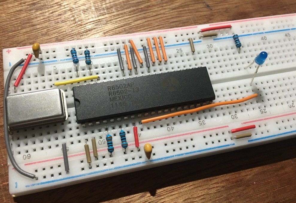

So I tried it on a breadboard and connected all the necessary pins including the data bus pins to run the NOP code "ea". I' ve also connected one LED to one of the address bus. Powered it with a 5v power supply but I don't see to get any activity from the led. Anything I missed?

PostPosted: Wed Jan 22, 2020 2:50 pm
Posts: 1488
connecting the LED to pin 25 (A15) may be more visible - A0 is going to be wiggling at clock/2 , so fast. However it ought to still glow somewhat. I presume you've done the usual thing of connect the LED directly to just 5v rail - just to be sure it's in the right way round and working...
And make sure the can oscillator is the right way round.
This is where an oscilloscope, even a cheap one, can be really handy just to check a few things.
There is also the possibility of a fake/broken chip - if this is something you bought off ebay. Do you have anything with a real working 6502 in it that you could use to check?

I have tested the led to be working fine. For the 6502, it’s also tested to work just fine with a clone replica of Apple I i assembled. For the crystal i have no way of testing it though. I will definitely get an Oscilloscope in the near future. :)
I tried several nmos 6502 chips i have laying around but but couldn’t seem to do the “free run”.

Was Rockwell still manufacturing NMOS on the 45th week of 2011? Or am I reading something incorrectly ...
I also noticed on first glance that your reset circuit might possibly be cause for concern.

It looks like the jumper wire for the VCC is not intact so i pressed it down and made sure there’s 5v on that pin. Sure thing, now it’s working. :)

As cbmeeks said, the oscillator can you have is the preferred method. That's not just a crystal. I just now edited that page of the 6502 primer to clarify that. A crystal by itself will not oscillate, any more than a bell just sitting there will ring if it's not being struck. It has to have the other circuit components around it to produce a signal. The oscillator can has the entire circuit to do that.

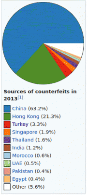

Like barrym95838, I doubt Rockwell was making any 65xx parts in 2011 (which the date code on yours says). I'm all the more sure they weren't making any NMOS 6502's anymore by then, so you definitely have a counterfeit there. There's quite a counterfeiting industry in China, with such parts showing up on eBay all the time. They pull parts out of old circuit boards, clean them up, sand the tops, and re-mark them. See https://www.youtube.com/watch?v=5vN_7NJ4qYA . I don't know why they don't just put the same markings back on, or just leave the markings alone. According to this pie chart from Wikipedia, China produces nearly twice as many counterfeit products as all other countries combined:
